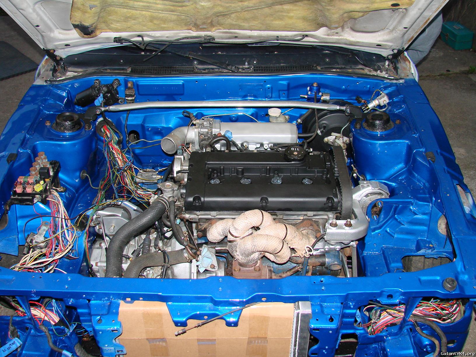

I've thinned and tucked mine. Its not really that bad to do. I keep forgetting to get pics of the finished setup, but it does look a lot better. Though its laying loose, its laying about where it ended up.
Cruise control, ABS, and the vacuum lines (though technical not wiring) are the biggest things that can be removed to clean it up (if you don't mind removing them for rarity reasons). Move the rear loom down to lower on the firewall is a huge help whether your stripping out the others or not. Biggest challenge for me was passenger front corner. Its got a lot of stuff right there. If you have your battery in the factory location it covers it up, but if you're relocating to firewall or trunk it makes it a lot more visible.
I'll try to snap from finished pics over the weekend if I can.

As for getting back on topic. Blue, looks like you have quite a few wires just hanging out there. It would be great to see how that all came together. Also, it sounds like someone may be able to turn some profit out of building new harnesses for GVR4's/DSMs?
