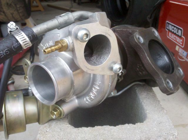

img_20101221_135312-jpg.116437

Yeah I want to do this just for the waste gate signal. I also found my turbo smart mbc that I missplaced, so I will be toying with that hopefully connected in this position.
I will try to remove the cover to dril and tap but removing the large c clamp may prove difficult. Stuffing rags and vacuuming and blowing compressed air through after completion may be the route I go. I'd rather remove it obviously.
I wish I added more ports to my intake manifold for map and boost gauge.
