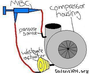

dont connect it to the BOV line. it needs to go from the actuator to the turbo outlet or hot side intercooler piping.
like this without the MBC

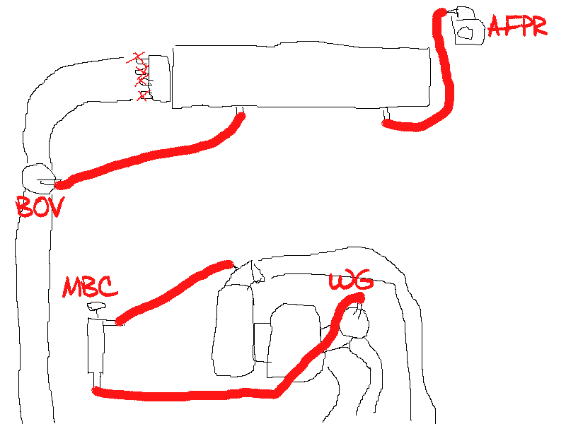

slugsgomoo
Oct 16, 2003
3,777
Tacoma, WA
Yeah, boost gauges can leak, so I would highly recommend getting it off the FPR line... the only thing you could tee into the FPR line that would be worse is an MBC in my opinion.
this is an ancient super elite MSPAINT drawing I did but it should be correct, though Jim is right, the P port is a good choice for pulling a boost/vacuum source. I'm not using it anymore because all those ports on my TB were welded over... but YMMV there /ubbthreads/images/graemlins/wink.gif
