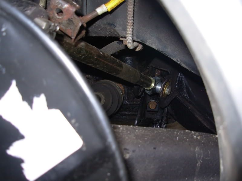

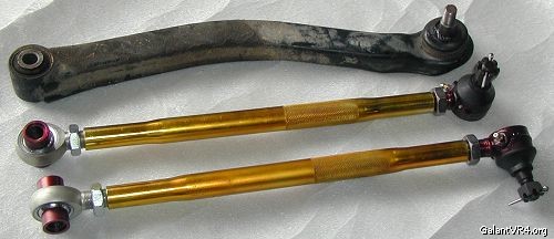

I used these for the upper rear and avoided the bushing issue all together.
Is that something you made, or is that something you can buy???
those arms are exsactly like the ones I made.
Check the "how too" forums and search for my name or Ebay control arms

Ya, I tried hyperlinking your How To, but it didn't work. I had already purchased mine by the time that thread came to be. My loss I suppose.
I had machine shop to press them in for me. They told me they had to press out the metal sleeves in order to get the bushings in.

I never knew the 3/S rear suspension looked so similar to a GVR4.
Those rear arms are a copy of the arms that SGTDave made a few years ago. They can be made for $100 and a trip to AFCO's website.
Here they are on #797
EDIT: Whoops didn't see SGTDave already posted this info. /ubbthreads/images/graemlins/blush.gif
