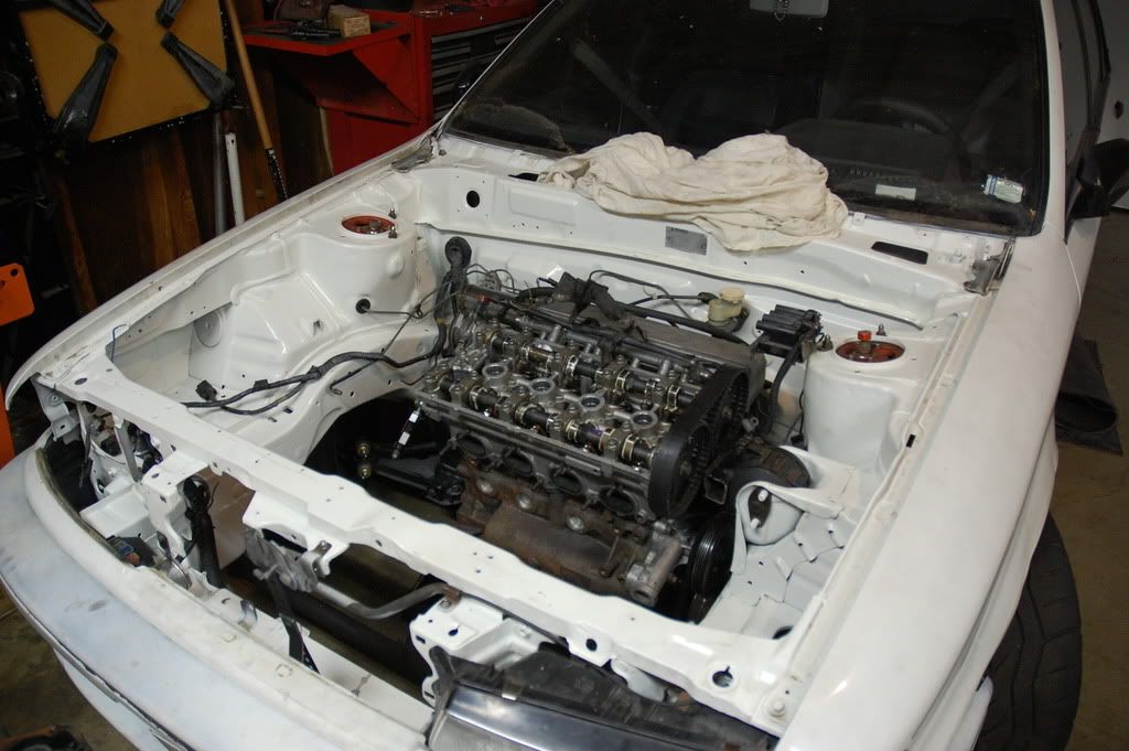

My vote is for white. I got the panda look going on under the hood, but it's only from the fortune I spent on powdercoating. It's gonna be a pain in the ass to keep clean, however my car won't see the elements that often.

Unfortunately, the paint shop is taking their sweet old time with the car. The engine bay is 100% complete and the car is running, but I'm waiting for the car to come back from paint before I can start putting the interior back together. I have a ton of goodies waiting to go on when it's back though. Not much will be happening until spring comes back around. The pic above is an old one of the engine bay. Thanks for the compliment.

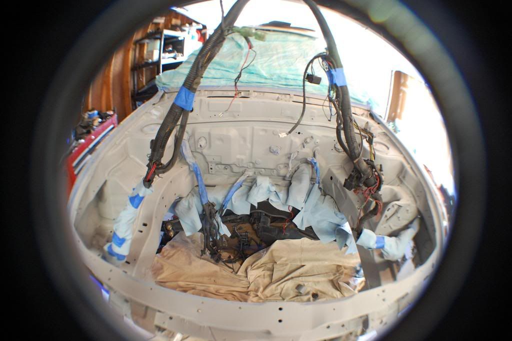

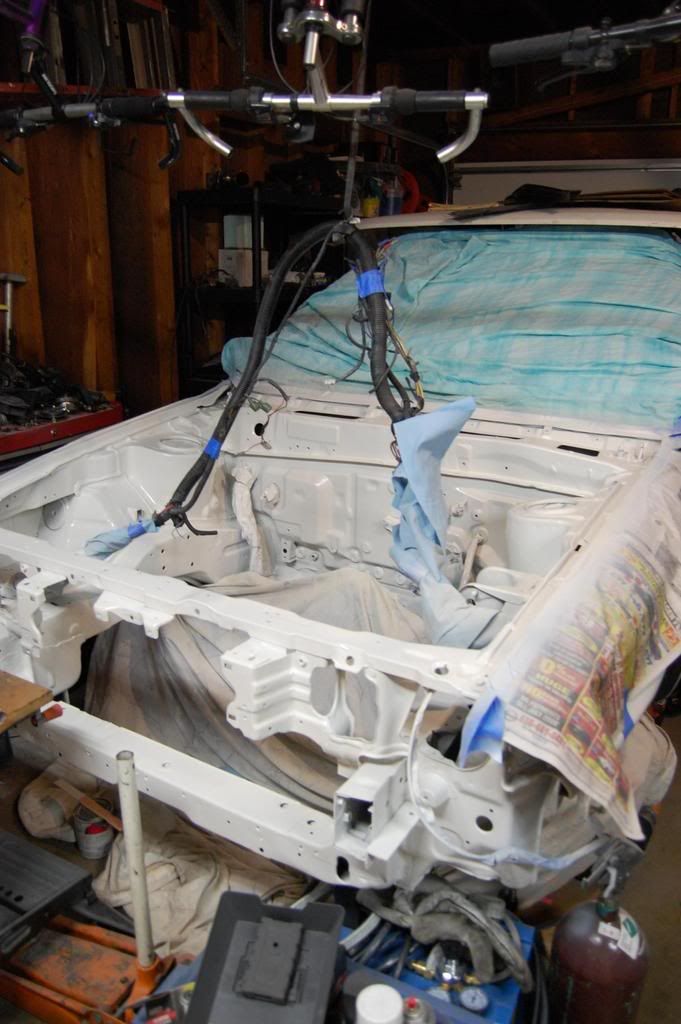

I found a 1600* white paint, used for exhaust,oil pans, rims and other "problem areas" Cleans really well and holds up to alot of abuse. Has a rust neutralizer in it, and seems to be heavy with ceramic(im ASSuming) .... but its a rattle can product, to bad i cant find it in liquid form and use my gun. Would be harder to spray, but it seems lik its all in the prep. Light coats, but even and many.

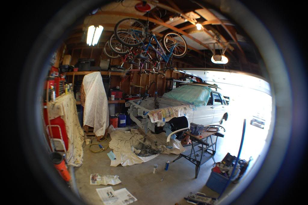

Im in process of converting my garage into a paint booth via 300sq ft of industrial plastic sheeting and a pusher fan setup under the rear of the car. Cover EVERYTHING and use a respirator.
id like to have it on the ground, with the new turbo setup and clutch, by the end of the month/My Bday. Say it can't be done /ubbthreads/images/graemlins/devil.gif

I think I got my stuff from Napa, it's all automotive rated, so I believe it'll hold up to the heat. Even with the top-mount I still haven't seen any warping, or color changes. But, being the idiot I was, it's now very filthy so I'm going to have to redo it and fill some more holes better /ubbthreads/images/graemlins/smile.gif
