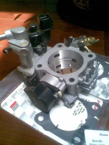

went with the over bore to a 63mm.. checked all the sensors and only had to replace the off idle switch, but everything else was a 100%. It does stick a little bit but i figure i just need to drive her hard and it will fix itself.

I have chosen to rebuild it my self and not go bigger with the bore, I just can't risk loosing 8k worth of motor and turbo from a 15 cent screw.
