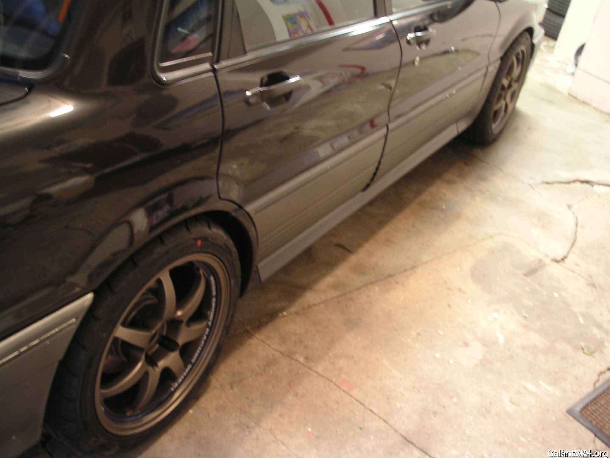

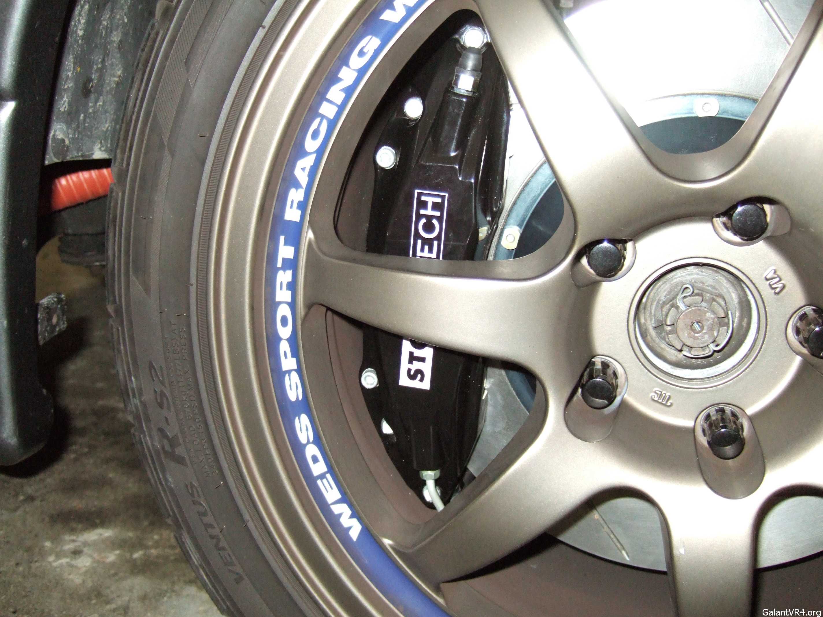

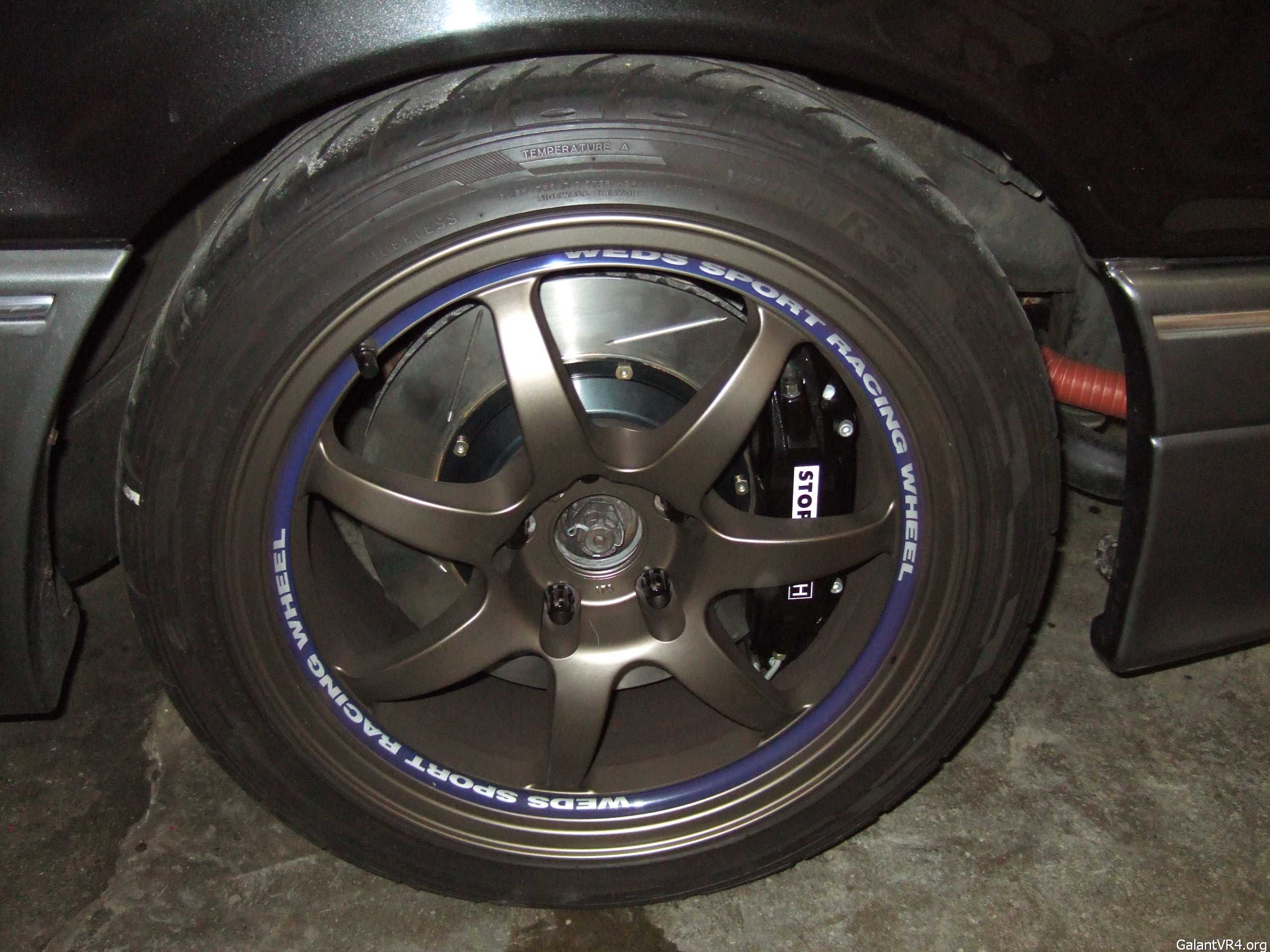

My Weds Sport SA-90 rims (17x8", ET35) clear my big brake kit with room to spare. I didn't do any fender rolling, but am running lots of negative camber:
