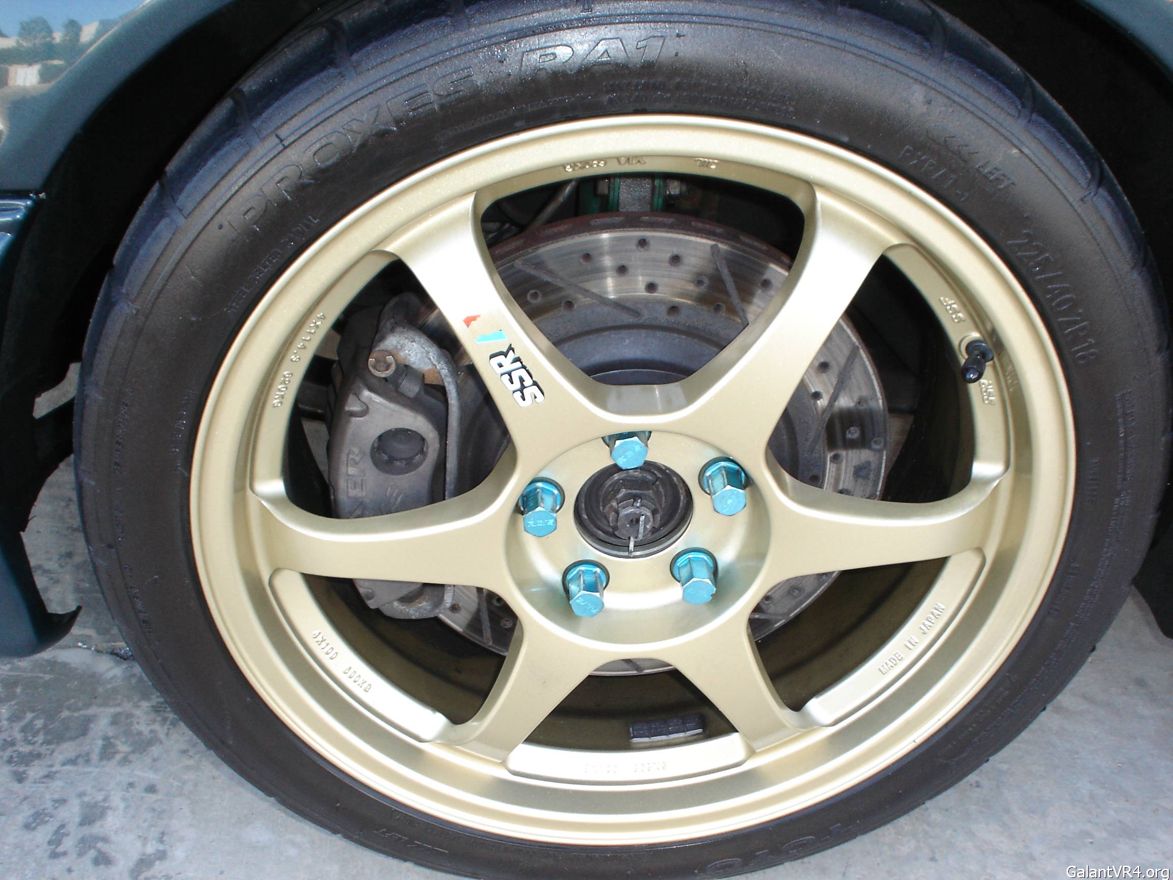

I have the Baer BBK on my car and I run SSR Type C's +40 offset 18 x 7.5. I would probably say that a +40 offset on a 18 x 7.5 would be the lowest you'd want to go. The higher the offset the closer the wheel will be to the hub.

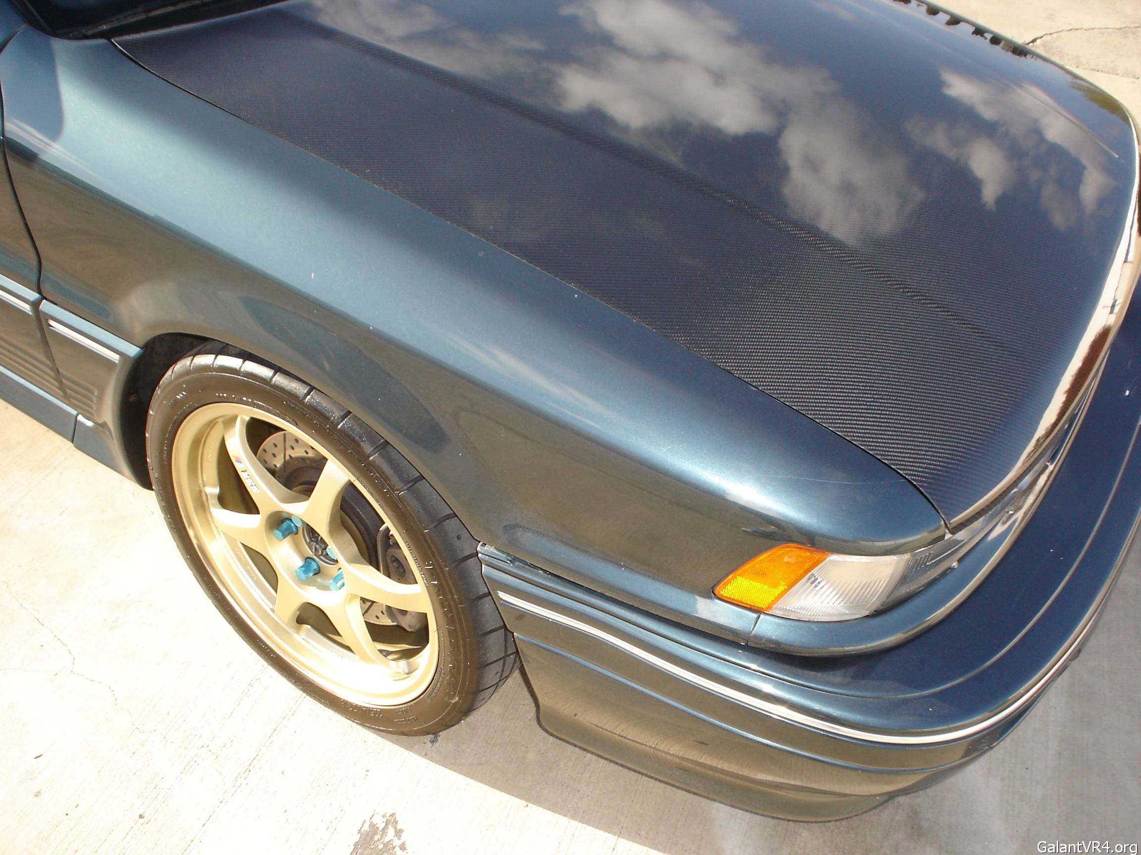

+38 would push the wheel 2mm further out. The +40 on my car is right at the fender in the front.

The lower the number the further away from the hub. +38 and lower will clear the caliper no problem,but then you'll have wheels that potentially stick out past the fender (maybe on +38,definitely on +35). +40 will fit like you see in the third picture,flush with the body work. All of the above is assuming we are talking about a 18 x 7.5" rim.

On the two offsets you mentioned +35 and +38 you will clear the calipers with no problem,because my +40 is in fact closer to the caliper than both of those offsets and it clears them without issue.

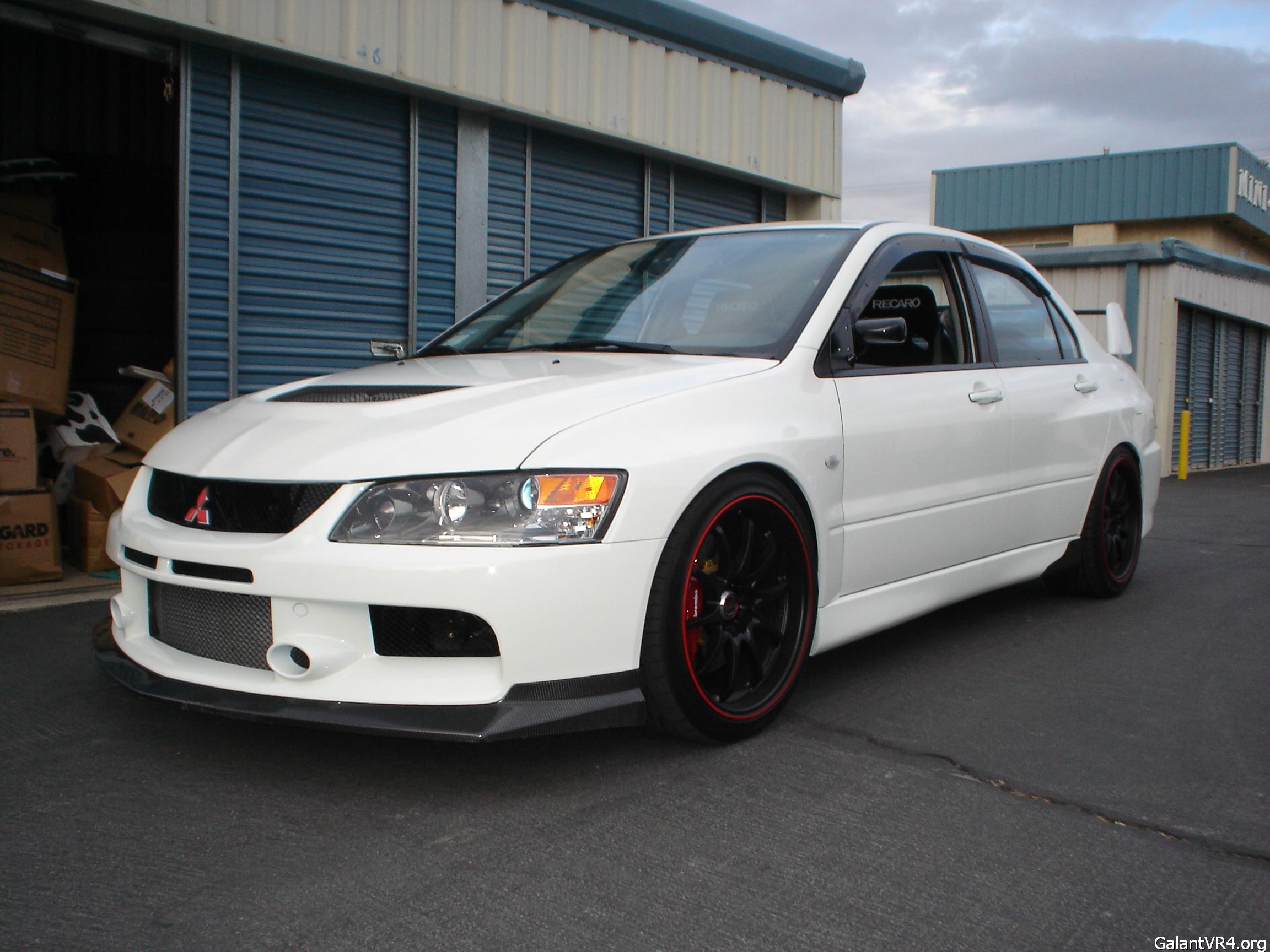

Random pic of my Evo with Volk CE28N Time Attack Edition wheels,18 x 9.5 with 265/35/18 all around.
