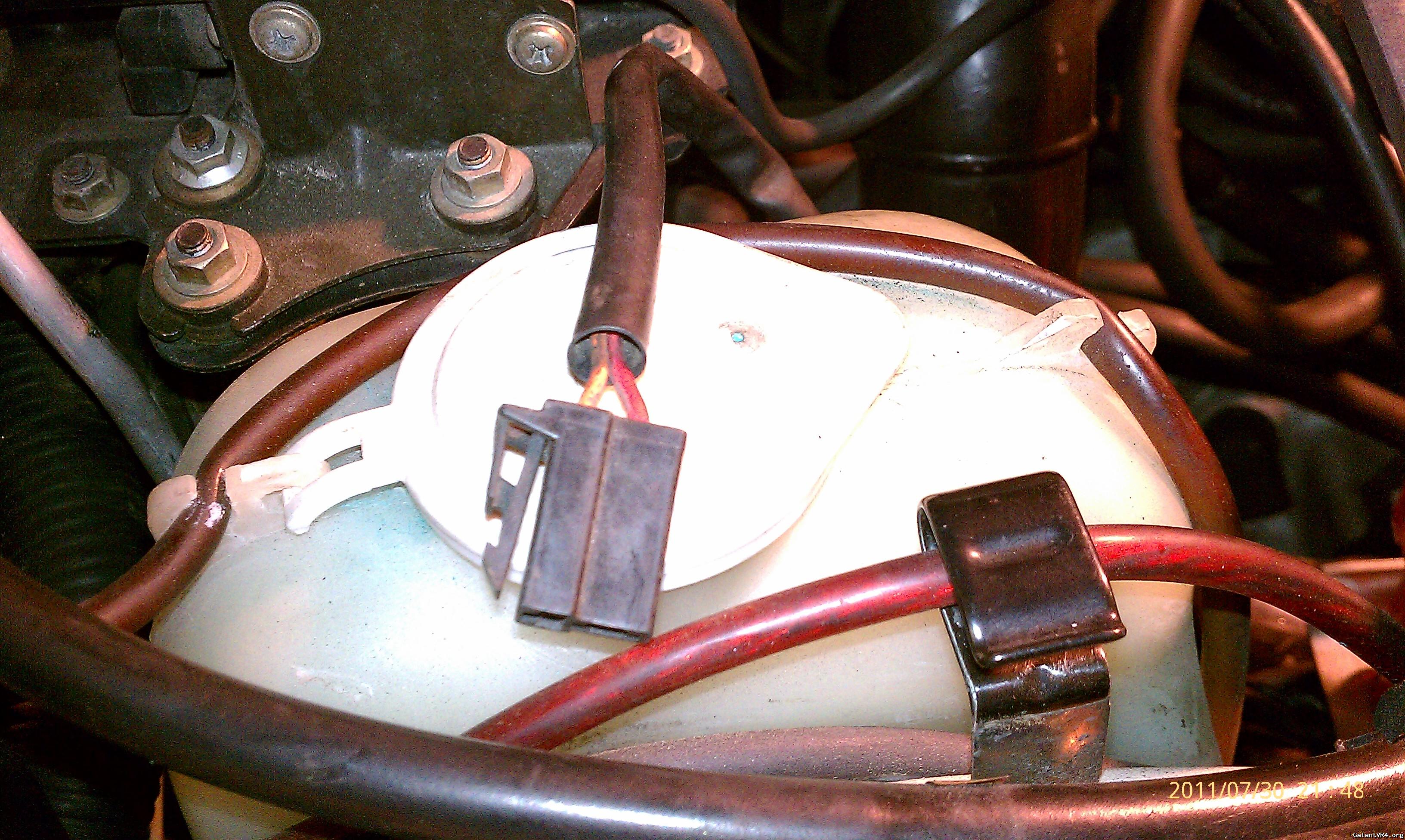

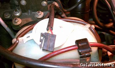

is it on the same harness as the mas air sensor, theres two plugs on there, ones for the fuel solenoid, ones for the boost solinoid, both look the same. I think it need to be pluged in even if your not running vacuum lines to it.
Thank you for the diagram. I'll check again tonight.
The wire does come out of the Mas harness or around it. The redish looking wire is actually orange. I saw there were two others that were plugged in with vacuum hoses coming out from them. I looked around to see where this particular one would plug into and couldn't locate it.
