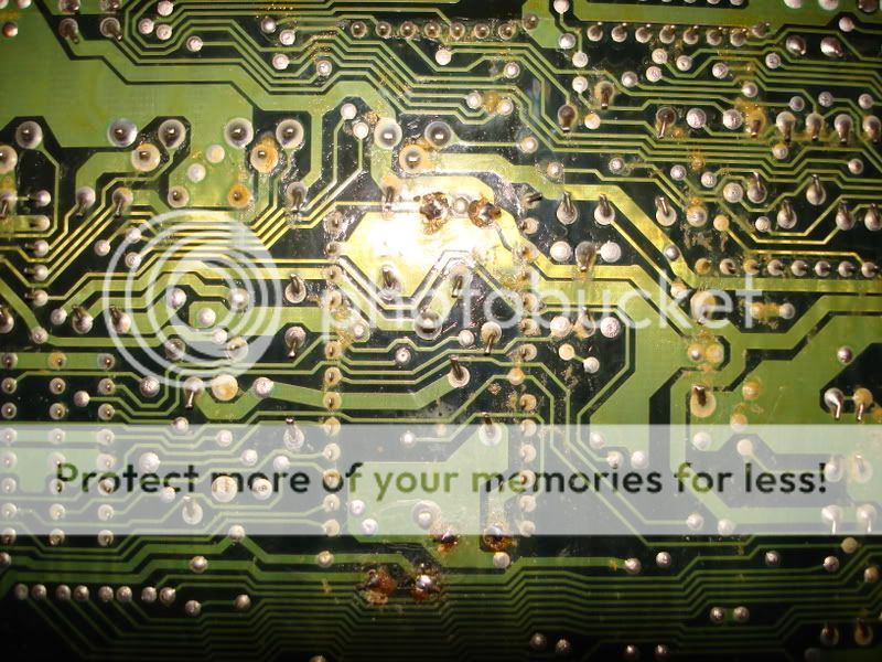

the injectors arent pulsing or whatnot, my friend tested them with a test light, so basically my ecu crapped?
pics of my ecu i took 30 minutes ago
Actually, those pictures show a rather clean ECU, except for the fact that whoever replaced the caps didn't clean up the flux, but that shouldn't cause the issue you're having. What I don't like is the crappy EPROM socketing job I see. It looks like they used the wrong solder or tools to do it. That can also cause the "chattering relay" syndrome. I think you should send the ECU to someone experienced with repairing DSM ECU's and have it resocketed.
FYI: when you are looking for acid damage, you don't look at the bottom of the ECU. You want to focus in on that area where the caps are, in between the 2 vertical boards. From the one picture you posted it looks very clean, like someone replaced the caps before there was any leakage. But, you need to take a closeup of the righthand vertical board's pins, IC110. A lot of times acid will attack pin #1, and the trace from pin #1 to pin #110 on the rear of the ECU, which kills the MPI relay.

went out to try and log throtpos and the fuel pump relay was going crazy and would not stop clicking. and i couldnt log either, i have no idea whats going on, im getting a good ecu tomorrow to see
The fact that you can't log it confirms my socketing suspicion. The CPU is going nuts because of bad code.
Unfortunately, I fly out tomorrow morning and won't really be back home until 9/13. I'd recommend sending it to Steve P, Terry, or Dave Mertz for resocketing. The ECU otherwise looks very cherry. /ubbthreads/images//graemlins/cool.gif

It looks like when it was socketed that whoever did it didn't clean back the conformal coating enough - when we did mine, I remember having a hard time getting a solid solder joint when the coating got in the way. Might be part of the problem?

well i put in a local dsm'ers good ecu, and the car fired up! so should i send off my ecu to get resocketed and capped or is my ecu done for???
The ECU already has new caps, and looks MINT, so it is DEFINITELY worth saving! Just get it resocketed, PROPERLY. /ubbthreads/images//graemlins/wink.gif
