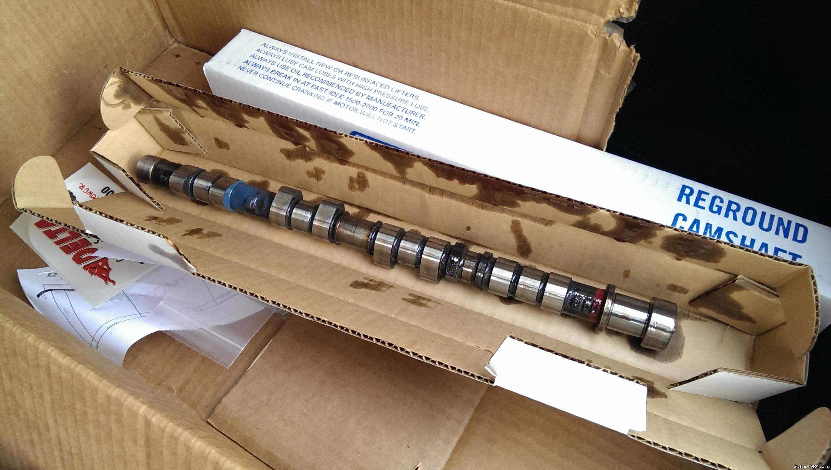

click Delta Camshaft
I got 264/264 regrinds that were half as much as new 264/264's and every bit as good. I actually drove up from Portland to pick up the cams and got to walk the shop floor. Great guys and a great product.
Check out the sidebar on the Services tab on their website for an explanation of their process including videos.

Well great, but if you want to save money, I'm telling you, go to Delta Camshaft.
Here's a review of the cams from a guy on Tuners. He was, like you, looking into HKS. Went to Delta and got regrind 272/272's for less than $200. Delta uses a cam profile that's the same as HKS.
First start-up (skip to page-2 of the thread for when he gets the car running)
There's some other videos as well, along with others singing the praises of Delta. Pics on page-3 of cams after 800 miles.
Just sayin...
