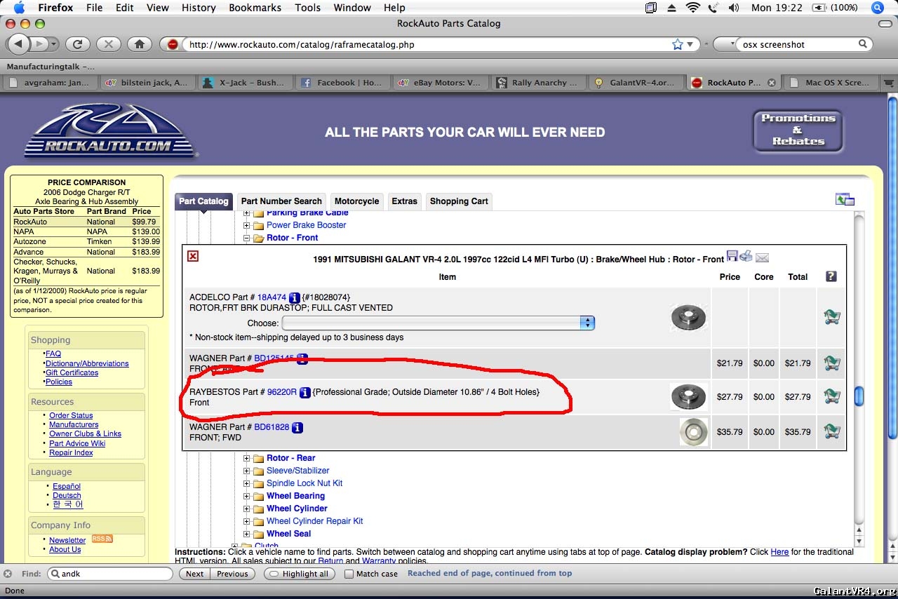

I found this. Has anyone bought rotors from them before?
What size are the stock rotors?
If you're looking at the Brembos on there they're not the right ones. Stock should be 276mm. Those are for non VR-4 Galants. Brembo# 25880 is what you want.

Quoting Ted Andkilde:
The Raybestos PG plus rotors have been Brembos in the past, $28 apiece from RockAuto, there's a sticky somewhere on the site for a discount code as well.
Slotted or drilled rotors are pointless rice on a street car.
Cheers, Ted
Are these confirmed.
I want to order a front set now. Just don't want to have to order something twice.

Quoting JDM_DSM:
Quoting GeorgeBillings:
I was just looking in an old brembo catalog and that is the right # if you can find them. Front 25880 rear 25165.
