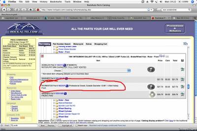

The Raybestos PG plus rotors have been Brembos in the past, $28 apiece from RockAuto, there's a sticky somewhere on the site for a discount code as well.
