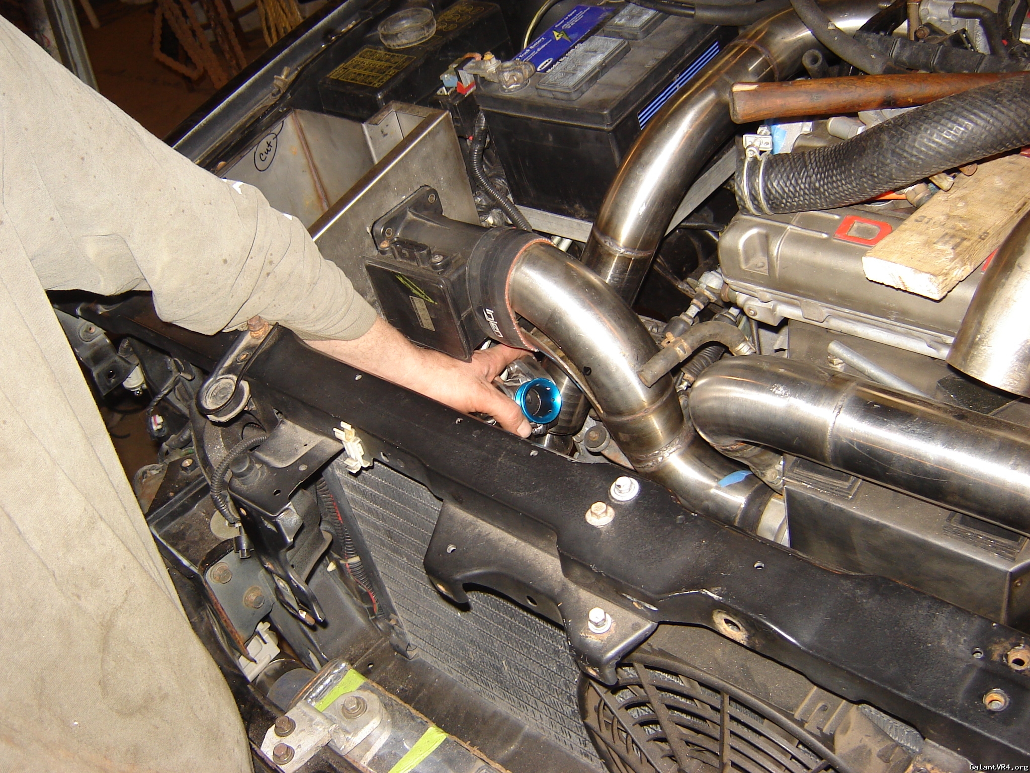

I'm running the greddy type rs valve, but really only because I had it given to me. The cap was stripped where the adjustment screw threaded in. I just re-tapped it to a bigger thread and it works fine.
This was during mock up, you cant even hardly see it now with everything together. /ubbthreads/images/graemlins/hsugh.gif

with the mods you have you can just use the stock bov and crush it.. and will be fine for a long time. If you want a little bit of noise you can use on of the greddy's that recirc back into the system.
Nabeel, the reason why it is fluttering so much with the lower vacuum hooked up is because it should be hooked up to boost pressure only not vacuum. If vacuum is on both sides of the diagpram it will not open like it should.

Thanks for the comments. I just like the monkey voice coming from the bov while it /ubbthreads/images/graemlins/jawdrop.gif being connected like this. /ubbthreads/images/graemlins/jawdrop.gif
