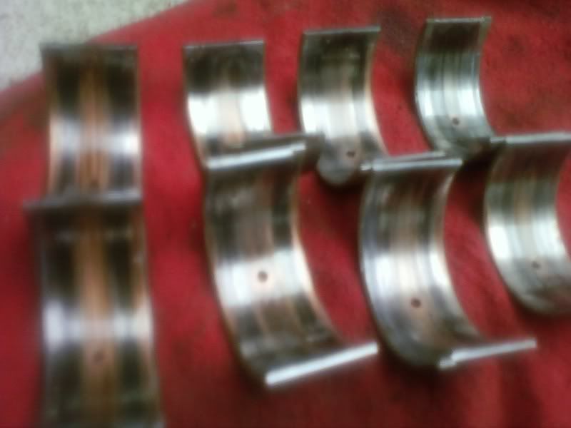

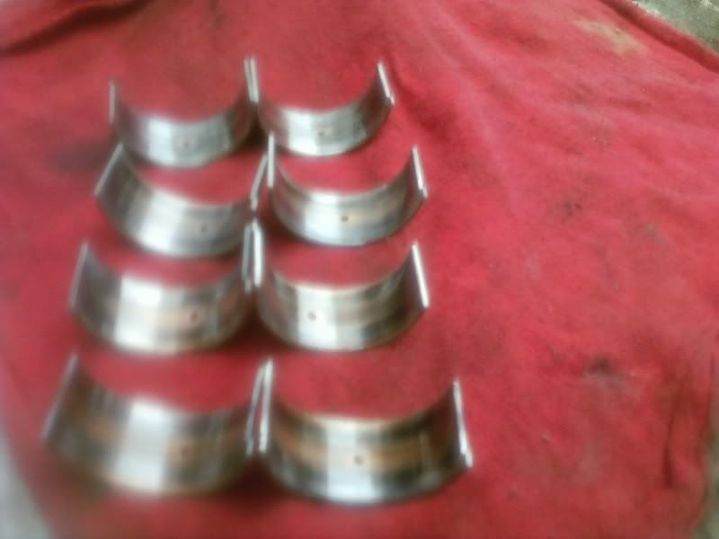

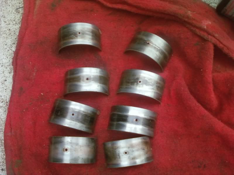

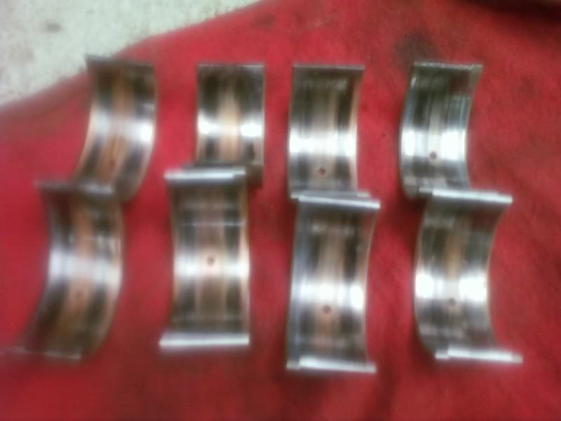

i got it all ripped apart just now, i took some quick pics of the old bearings...
plus i read a lot of different threads that stated the mains last longer, if your end play is good, than to just leave it alone. not like i checked my end play or anything but, its really under $200 not that bad of a gamble. i will drive the car maybe 2500 miles a year, if it ever stays running!
