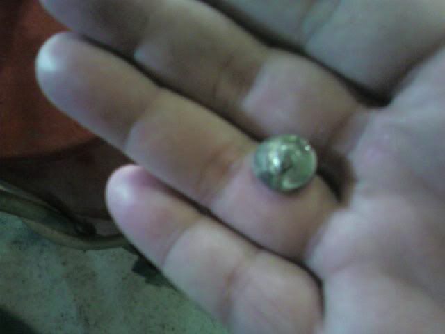

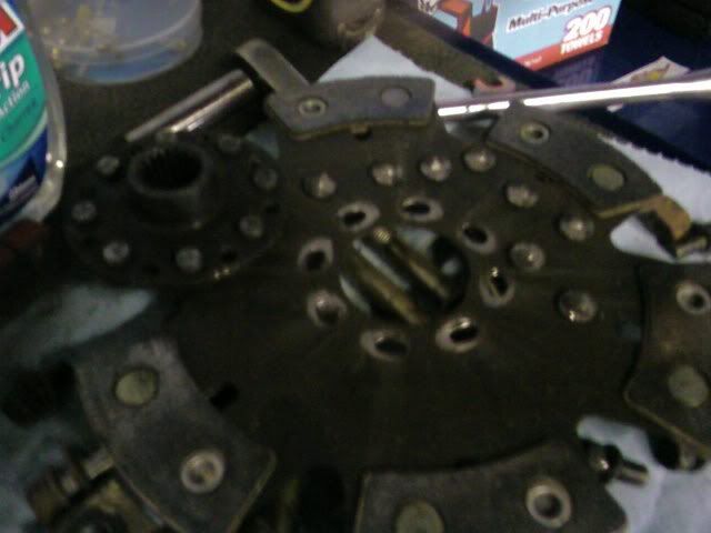

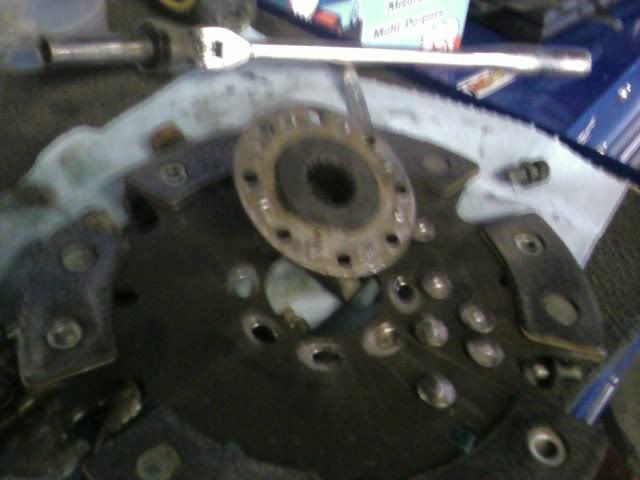

So finally got a chance to get the tranny apart. Found the problem why the clutch stopped working, apparently the rivets on the hub all got snapped off.
Sorry for the bad camera pictures,
