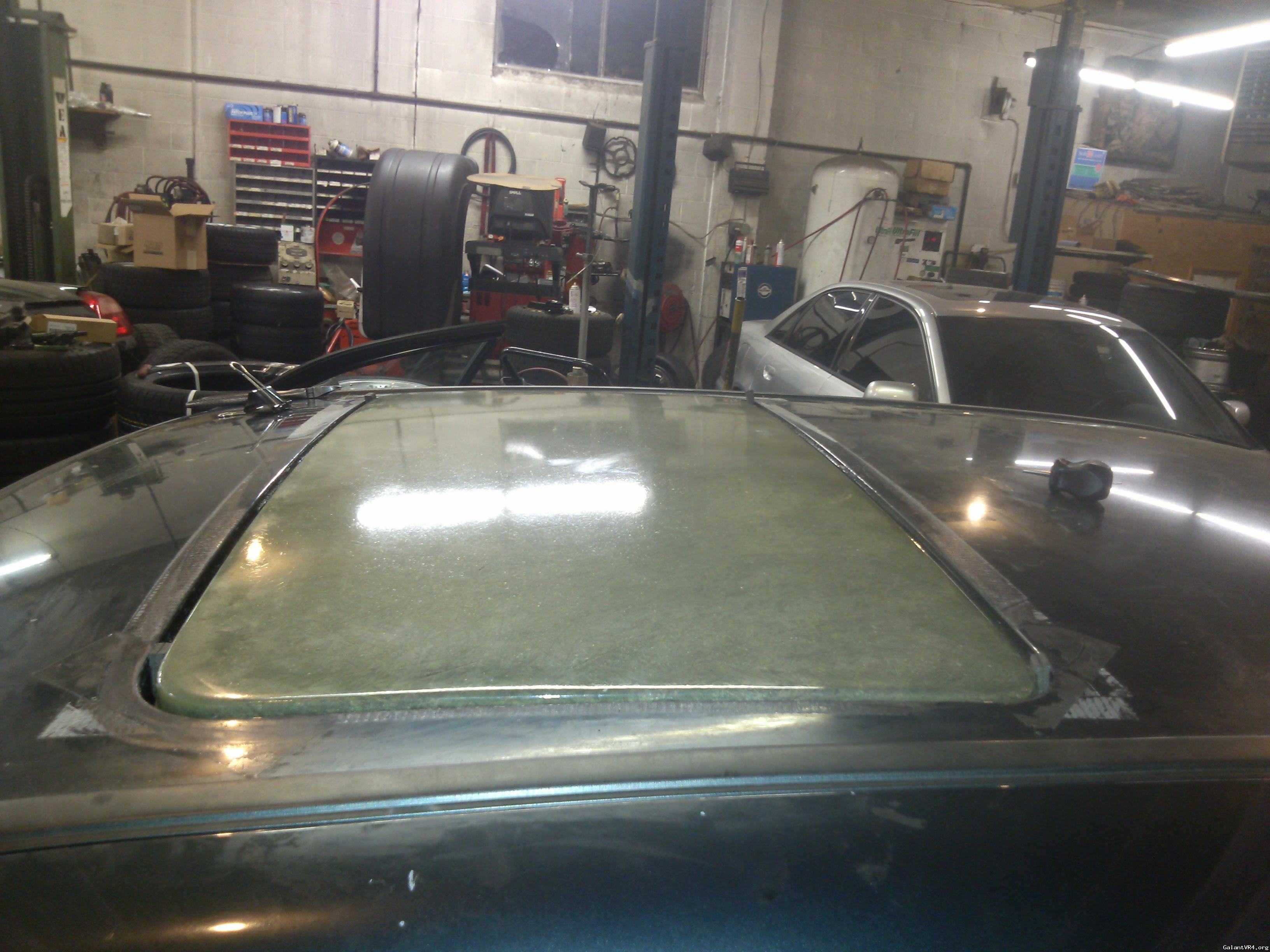

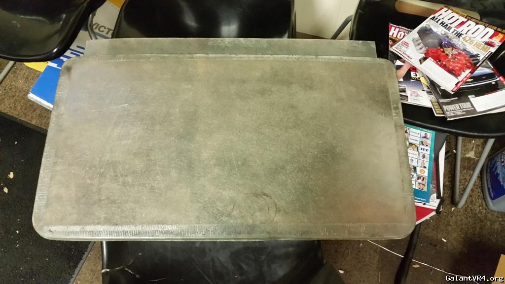

I have the prototype that I made out of fiberglass and resin. There is no gel coat. I will not be making anymore of the carbon ones as the price of carbon is too much and mine didn't really turn out as I would have hoped. For some reason the clear coat came out weird over the carbon. I would be willing to part with this prototype and possibly make a few gel coated fiberglass ones. I still have the mold that I made to make mine. Installation is a bit of a pain in the ass as I used the factory glass to make the buck and didn't end up making the gap as small as I would have liked. There are not fasteners, it is a glue in piece. I used window weld to do mine. I can take photos if your interested. The hardest part of install was getting the gap even around the roof and holding it in place while the window weld cured.

Pictures would be awesome and my big question was the mounting method. I'm not a carbon fanboi so fiberglass I could paint KG or even black(so it just looks tinted) would be fine. Any design aspects to help with structural rigidity?

Here is a photo of the prototype when I was test fitting it. You can see the size of the gap.
Here is how it sits now. Its got a few scratches on it now but would need to be painted anyway.
