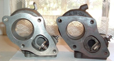

The Evo III exhaust housing already has a 34mm wastegate flapper
Evo III 070 on left, standard 060 on the right.
