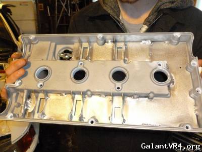

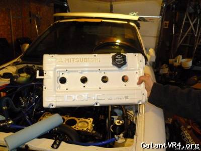

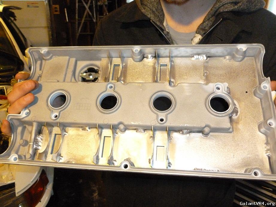

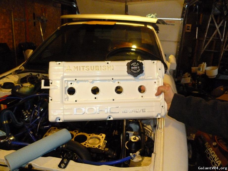

I posted the pics below in my build thread, but they could be useful in this thread.
Media in the baffle from sandblasting ruined my original VC. I experienced this because of an incompetent blaster.
Kevin Kovatch of CompWorks sells laser cut aluminum baffles . They are not pre-assembled and will need to be welded together. Used a dremel to grind out the rivets of the old baffle and it came right out. Also dremeled the rivets down on the cover because the mating surface for welding needs to be as flat as possible. If too much rivet material is still on the VC, then the cam shields will make contact with the cams and/or cam caps since the baffle plate sits too high. Make sure the shields sit square at 90 degrees or you will have contact. The shop I had weld in my first baffle screwed up because the baffle plate must have warped during welding and they didn't even notice.
Asked Kevin who he recommended to fix my VC and he sent me to his friend Justin of Detective Coatings. Kevin was super nice and hooked me up with a second baffle for cost. Justin ripped out my screwed up baffle and had someone who has lots of experience welding in these baffles do it. Turned out great I think. Had to get another coating of gloss white and it turned out even better than I imagined. Finished off with polished letters.
