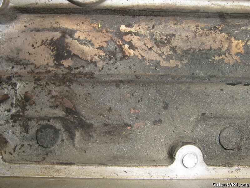

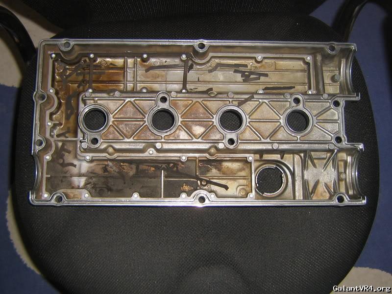

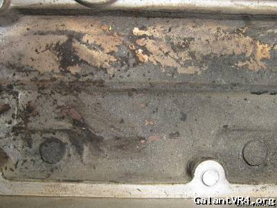

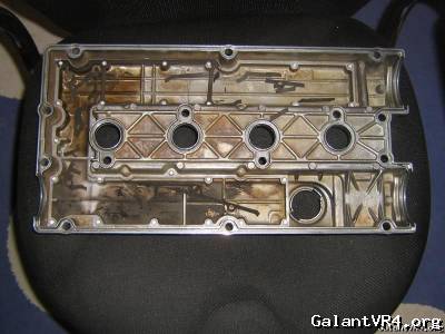

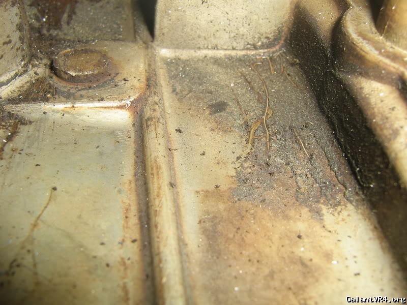

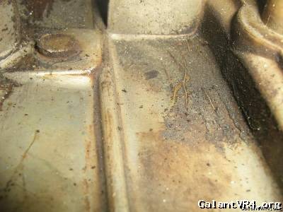

I prefer to have mine done. (instead of media blast) who knows what chemicals have seeped into the metal. Also after 21 years of having oil on and around the vc I think it's a good idea. These pics are after chemical stripping only.
11,982
The valve cover won't see temps that require outgassing though. It's not like an exhaust housing or exhaust manifold where it sees crazy temps and can cause a coating to flake off. Powdercoating takes about 400F. You have bigger problems if your valve cover ever sees temps like that once installed, let alone anything worse.

I'm positive that's all gone. When something like this is pickled it takes about 1-2 weeks. The object is submerged the entire time. Every few days the item is moved in to a different position while it's submerged so the caustic liquid gets in all the nooks and crannies. Also I don't think anyone is powder coating behind the baffles /ubbthreads/images/graemlins/grin.gif
