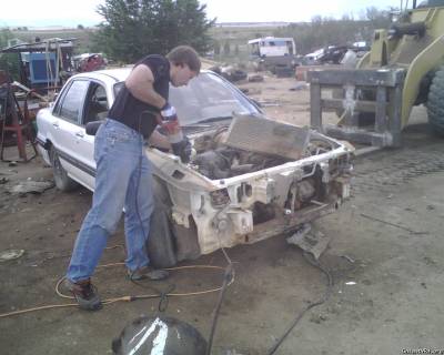

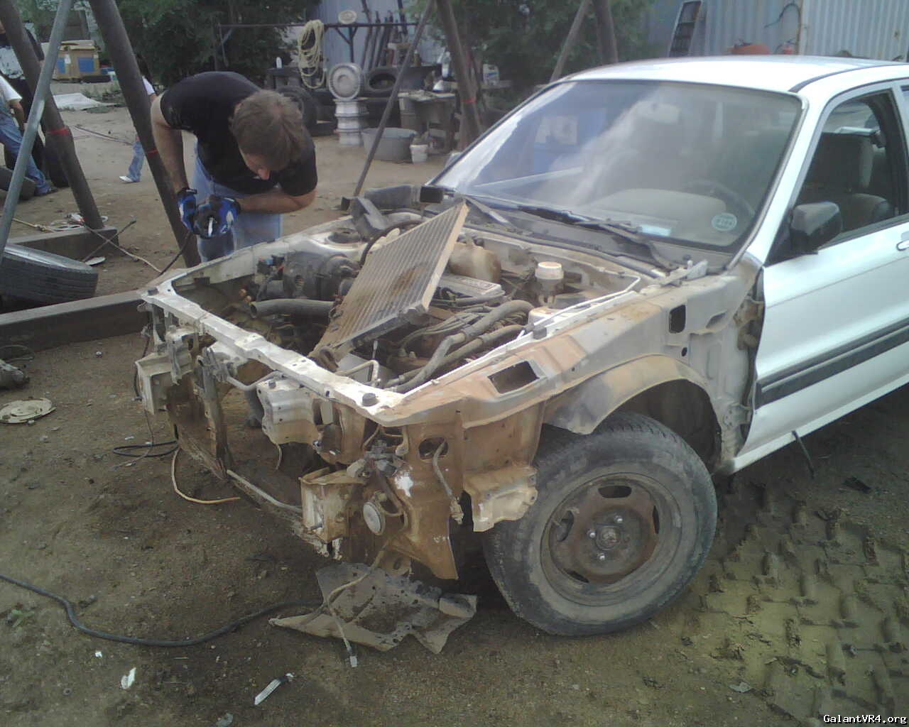

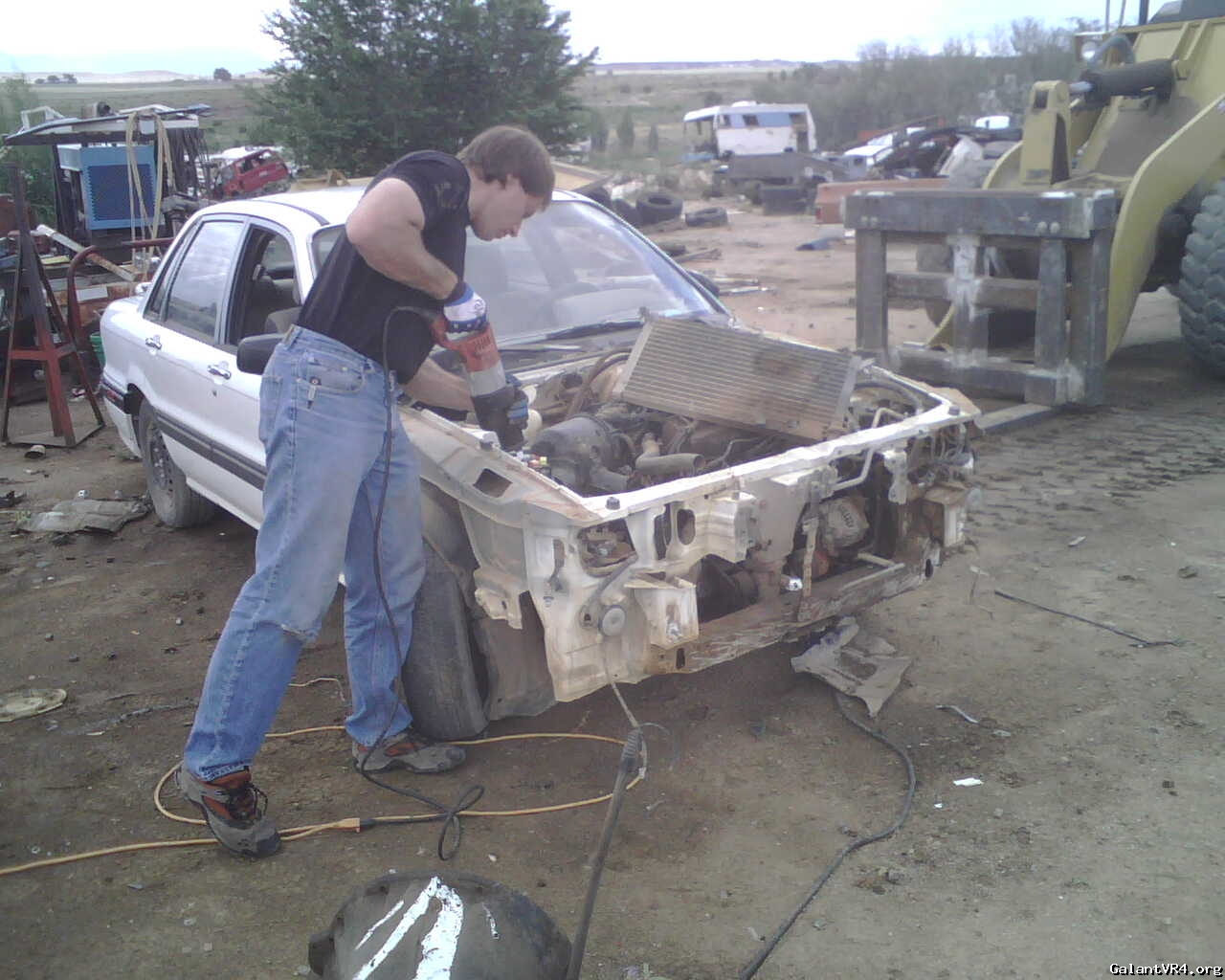

And with all that out of the way, here's a couple pics of Ray (twincharged 1G guy) handling the "delicate" act of removing the nose of this "La Raza Edition" Galant. (The radiator fans were wired together all ghetto, including a house light switch to turn them on or off.)
I just got a job offer this morning, so I'm seriously considering bailing early and spending a week drilling spot welds on this new support. With the one off the car, I can get a better view of what needs to be drilled/cut where in order to affect the cleanest removal of the one on 195 and then get this one welded into place.
So stoked. Will update this thread with more info as I go along. Might as well keep this unibody replacement stuff in one place for future reference.
