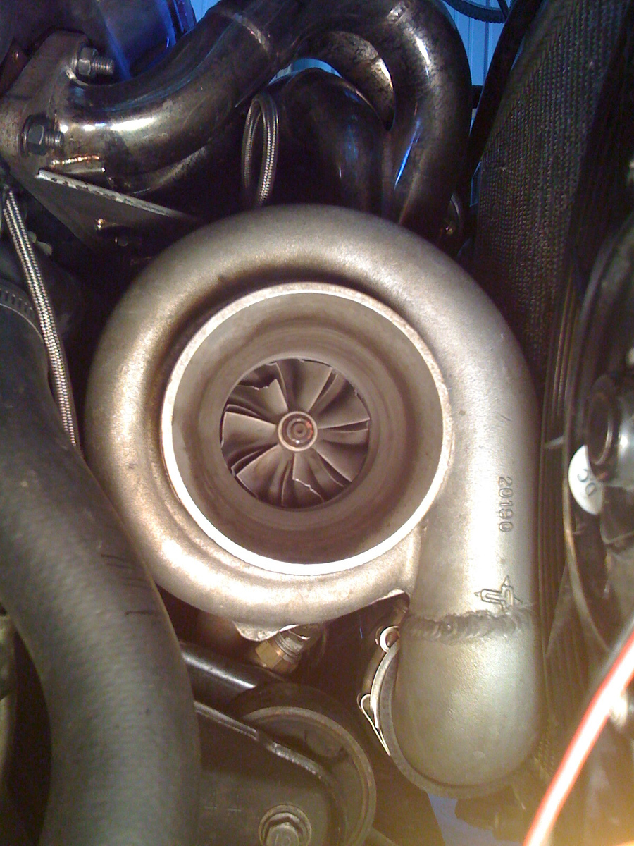

Here's what I ended up with:
Notice the two cracked off blades. Grabbing the nut you can feel about 1/8" of in/out shaft play, the comp housing is full of oil, and the wheel has ground a big groove into the comp housing. Yeah, that explains the very poor performance. Guess Im going to hunt around for a 50trim t3t4 or something a bit smaller than the 60-1 to replace it.

nah, I bet when I take it off, Ill find those two snapped off compressor blades sitting in the inlet endtank of the fmic.

If you can, take the intercooler off and flush it with water. The 60 trim wheel is not the most effecient. The -1 helps alittle but you need a good breathing motor to run it well. I had a 60 trim on my car and it was surging every time I pushed it. In the end, it ate up the bearing, int. and ext. wheel, and compressor cover.
