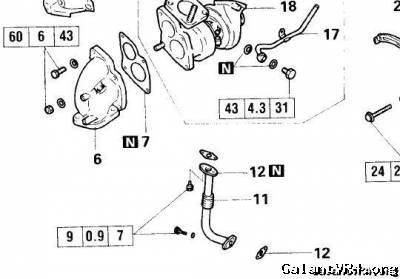

Where is the return line leaking from? If it's from the connection at the oil pan, you need new crush washers between the flange and bolts, as well as a new gasket. If from the turbo outlet, you need a new gasket...just one.

There is crush washers that go in between the flange and the bolts on the return line?
And it looked to be coming out where the gasket meets the pan right in the center its leaking, ive tried 4 new gaskets now. its not the gaskets, im geussing my pan is warped just enough right there to let some oil spill.
This is the first time ive heard of using crush washers on the 10mm bolts for the return line.
11,982
Yes, there are crush washers. If you'd done your research on the site, or better yet, used the goddamn FSM, you would know that there are crush washers there that seal the bolts. Fawk, dude.
