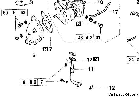

Aaaaaaaaaaaaaaaaaaaaaaaaagh, look at that manual I sent you hoss...
I actually looked at this page for the banjo bolt up top torque specs,(DIDNT LOOK AT THE BOTTOM) /ubbthreads/images/graemlins/mad.gif

No matter how much I work on these cars, I check my references. You can always screw up and forget something. Always have your FSM ready no matter what you are working on. ESPECIALLY critical stuff like turbo parts.
For turbo banjo bolt type connections the seal is 100% reliant on the copper crush washers. These are tremendously reliable. However you have to make SURE that your mating surfaces are smooth. The easiest way to do this of course is to get a new line. Optionally you can make sure your old line's mating surfaces are clean and smooth. Also make sure your turbo's mating surfaces are clean and smooth. Often times both can get gunked up or corroded after years of use. ALWAYS use new crush washers!! (Unless you are in a pinch you can generally reuse them, or you can even anneal them with a torch. However IMO this is for emergencies only.) I've NEVER had a banjo connection leak in all my years working on my cars following these guidelines.

that doesent have the crush washers for the oil return line..
smallest that kit has is the 10mm, im guessing i either need a 6mm or a 4mm crush washers, ive been to 3 parts store and none of them have it

these are the ones i need, just ordered 40 of them..
