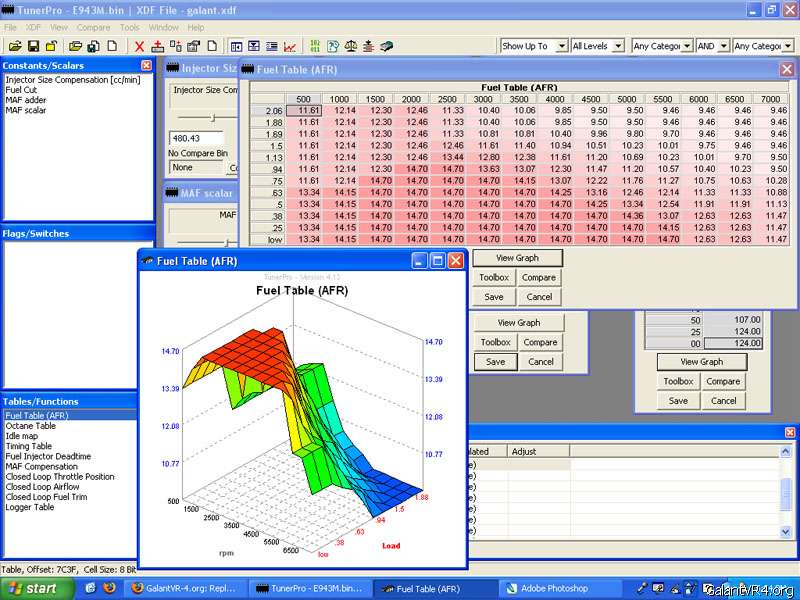

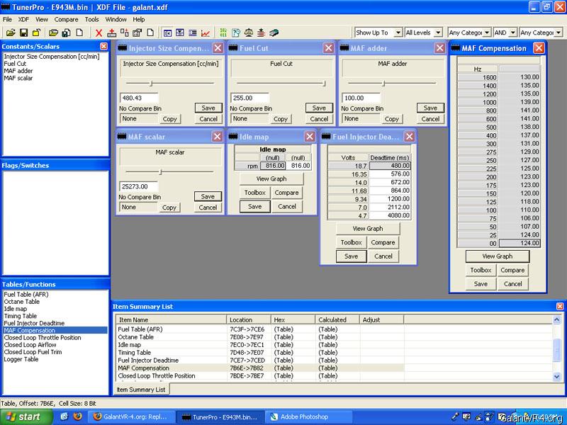

basically the codes are mostly disassembled already, that's why you see all those 'chips' and dsmlink and stuffs, so sutterbox is not a problem at all, whatever the keydiver chip can do, this can do too. if you can't work with hex code/assembly code directly, you can always use program like tuner pro. tunerpro makes it very very easy, you just have to set it up once, and after that each time you can just change the value graphically. very user friendly, at least to me. here are some screen shots of my setup.
as u can see on the left hand side you can setup and choose what element you want to change, you can add more, but these are the ones that I always use. and on the right hand side shows the corresponding value that my ECU is using.
open loop fuel table, you can either change the number individually or change them in groups, or you can simply use the 3D graph, drag and drop the values.

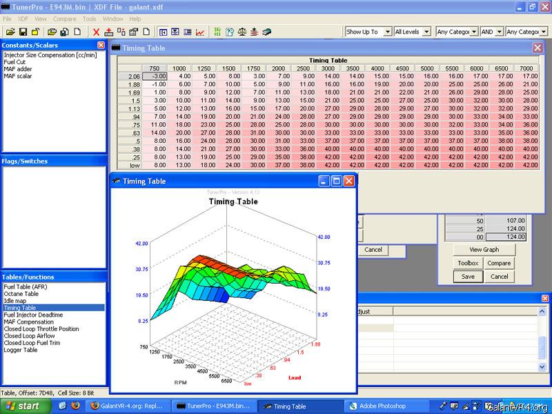

our favourite timing table, similar to fuel table.

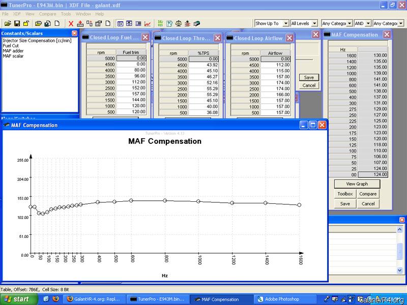

this is the MAF compensation and some closed loop values, and showing what the 2D graphs will look like.
