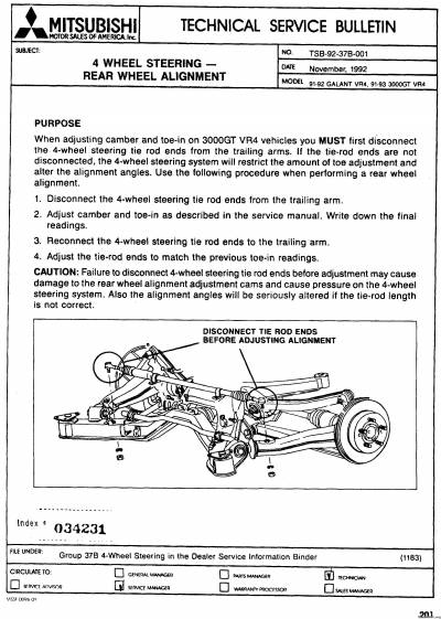

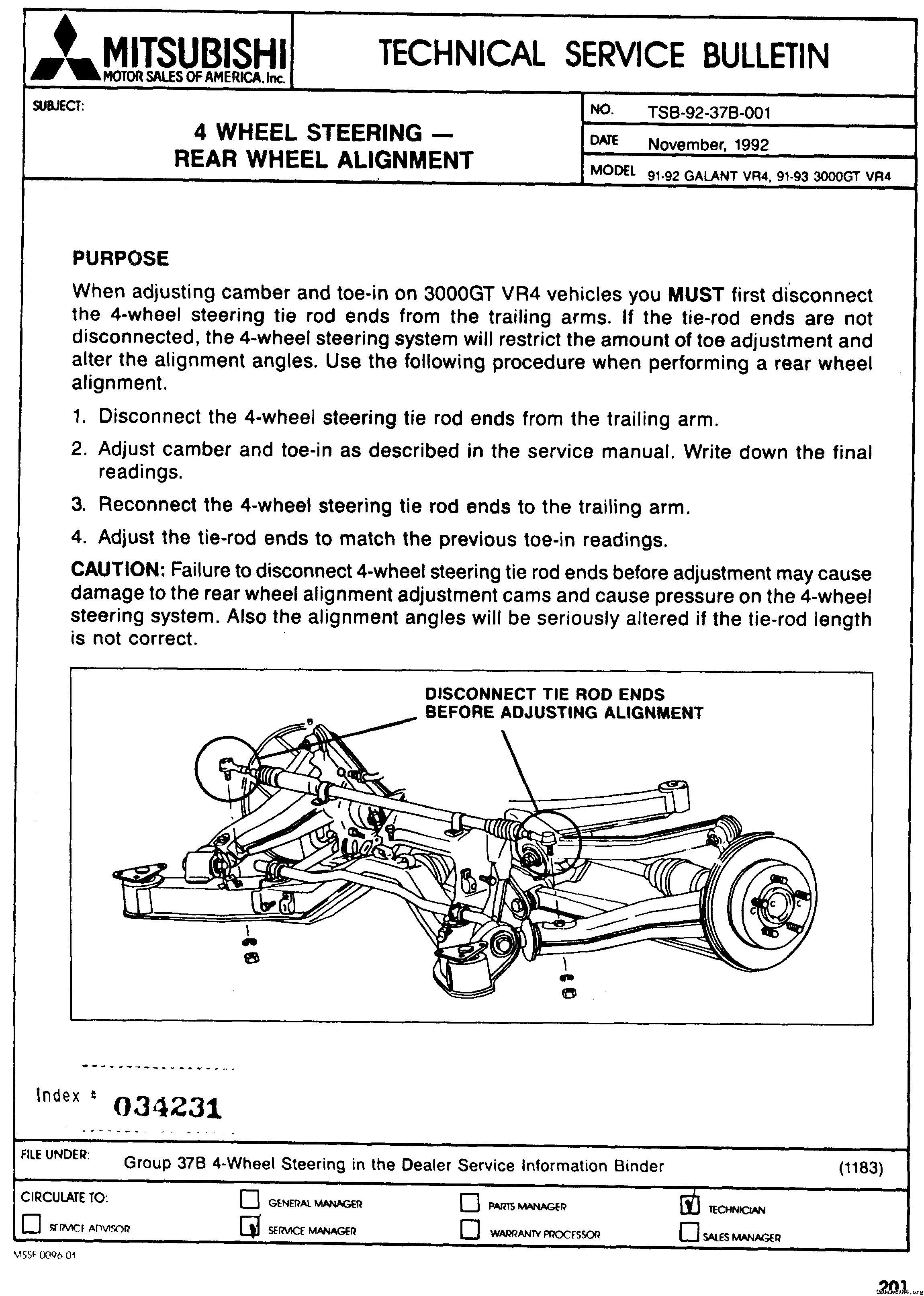

TSB for Aligning the Rear
Cleaning my Garage I found this paper to help those who are having problems with getting their rear alignment done with 4WS.
10,992
I took that with me to the shop a few years ago when having 855 aligned. they looked at me like I was from Mars. Then they proceeded to screw it up and I had rear tire wear issues.
I would suggest undoing the rear tie rod ends before going to get an alignment, then reinstalling them yourself following the shop's adjustment. Just make sure and adjust them properly so you have no preload affecting the just performed alignment.

^That's exactly how you do it. I've been doing alignments for a while and that is the only way I would do mine. Anything else is just stupid. Disconnect tie rods, do the 4 wheel alignment, screw/unscrew tie rods so they fall right in without pulling or pushing on the control/trailing arms. DONE!!!

Just did mine, Had to replace two tires because the last alignment I paid for was fubar! I gave then a printout of how to do it & I think they just ignored me Set the front toe charged me for a four way & sent me down the road /ubbthreads/images/graemlins/banghead.gif. So glad to work where we have an alignment rack again, never did trust anybody to touch my car but me /ubbthreads/images/graemlins/wink.gif.
Car just absolutely handles better now. Stand over their shoulder while they do it to make sure the tech won't puss out & screw you over, I'd swear as bad as it was they must have just eyeballed it, Tire Factory in Tacoma WA, FTMFL!!!

Though, I have done quite a few of the local gvr4's in my area and on almost every vehicle I have had to torch the rear tie rods or toe adjustment eccentrics/cams. Not because of rust either. It's just old and corroded and sometimes refuse to turn or loosen up in the first place. I've been able to get most of these cars set up absolutely perfect to either factory or user defined specs.
I guess what I am saying is, it's totally doable. Make sure the shop you take it to has an experienced tech who has done atleast a couple aws alignments and understands how to do this without melting bushings or completely ruining the alignment all together. I'd suggest talking with the tech and seeing if you can watch. Call around till you talk to somebody wbo seems confident and knowledgeable. And most importantly knows what a vr4 is when you mention it!
