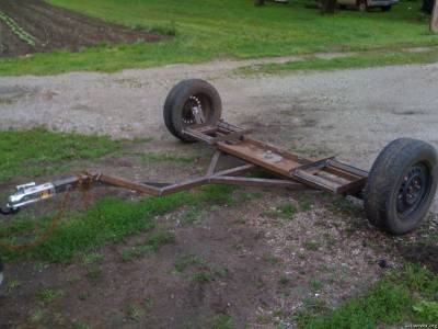

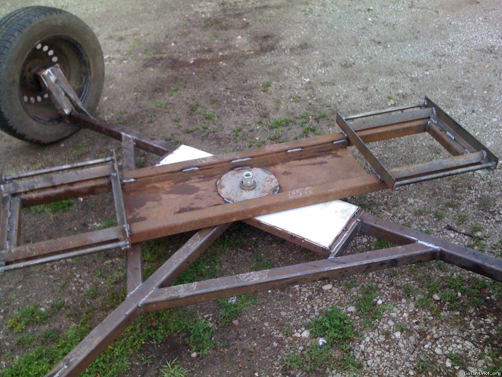

Got the dolly pretty much buttoned up today. Dad was going to weld up the tongue for me (I cut all the pieces and tacked it in place, just needs squaring) tonight after I left, wheels are on (gotta put a couple gussets for overkill status) and I've gotta cut out the UHMW. Should be DONE tomorrow, and I'll get pix. Not gonna paint it till I get back and have time to wire wheel the whole thing.

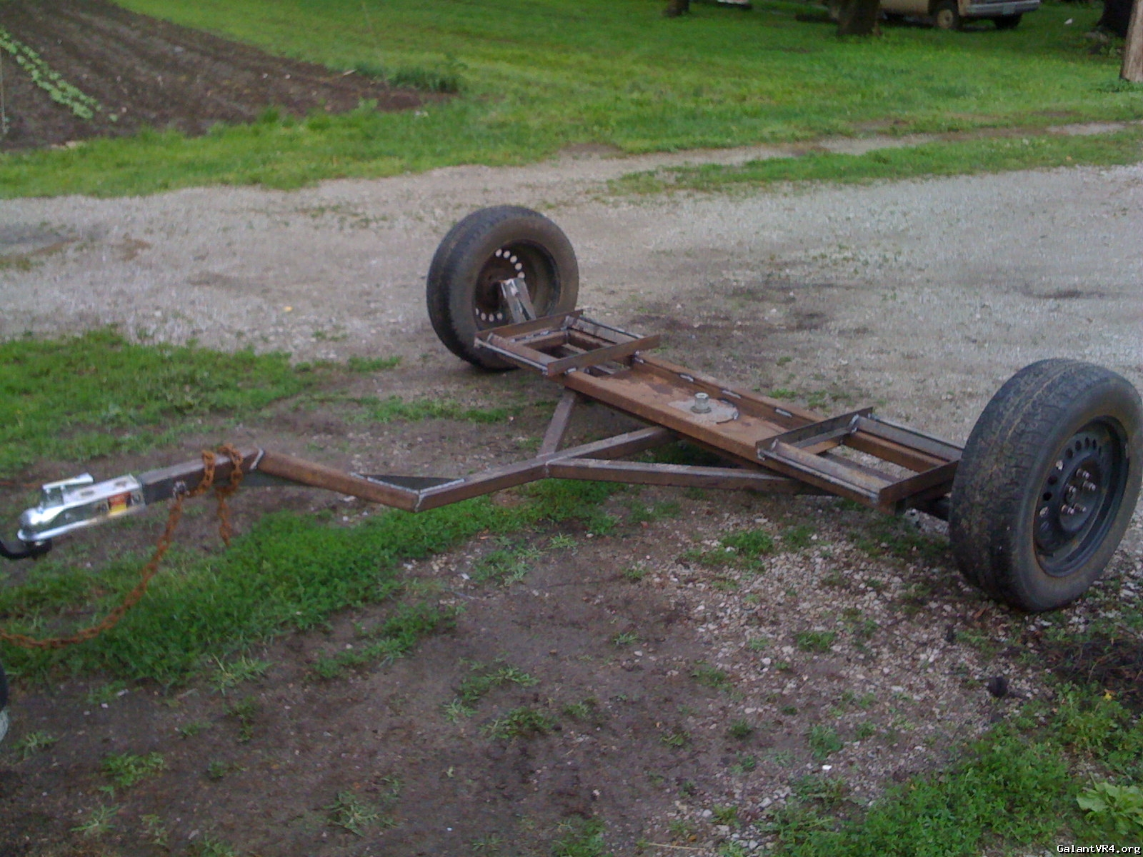

DONE! well, as far as we are going for this trip. Still have to make fenders, clean up/paint it and inspect it after the trip. Rides pretty good empty, didn't really bounce too much and didn't make one sound. My dad live about 20mins away, so I gave it a good test up to 65 on the way home.

Kenneth, you know the swivle on that is only supost to be around 15 degrees or so. If you dont make stops, you will turn the dolly wheels into the side of the car. I am not positive on the amount tho. Anyway, are you planning on welding some stops in there?

Maybe later. /ubbthreads/images/graemlins/hsugh.gif It's got a lot of clearance, and I'll be watching. I'm not worried.

I'd put stops in there in case you end up needed to back it up with the car on there. It could get tricky otherwise. Also, trust me if it pivots too far the car doors will hit on the dolly and you wont be happy.

Its almost impossible to back them up no matter what anyway. Its like backing up a haywagon, or a gravel train. Both of which I had jobs doing, but I still hate backing my dolly up more.
Also, Kenneth, its not the fact of how much clearence you have, it is that when you go to make a 90deg turn say out of a parking lot or so, the car will want to go straight while the dolly follows you and you will end up with the dollies wheel in the side of your new G-ride. I hope this does not happen to you, and if you foresee a problem, just take a couple of ratchet straps and strap the wheel tray to the frame.
1 More thing, the locks are for towing stability as well. You might notice a little fish-tailing if you get into a section of bumps or pot holes. Or if the cross wind picks up like it did on me comeing back with 420 from you.

not sure how the whole trip went but the car actually did straighten right out after a turn on kenny's dolly. it seemed to work really well.

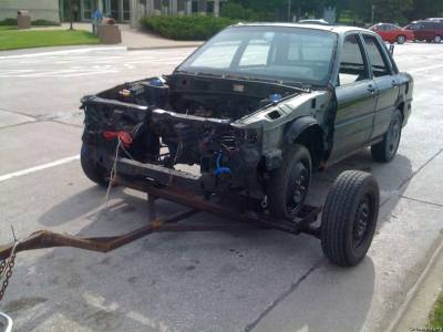

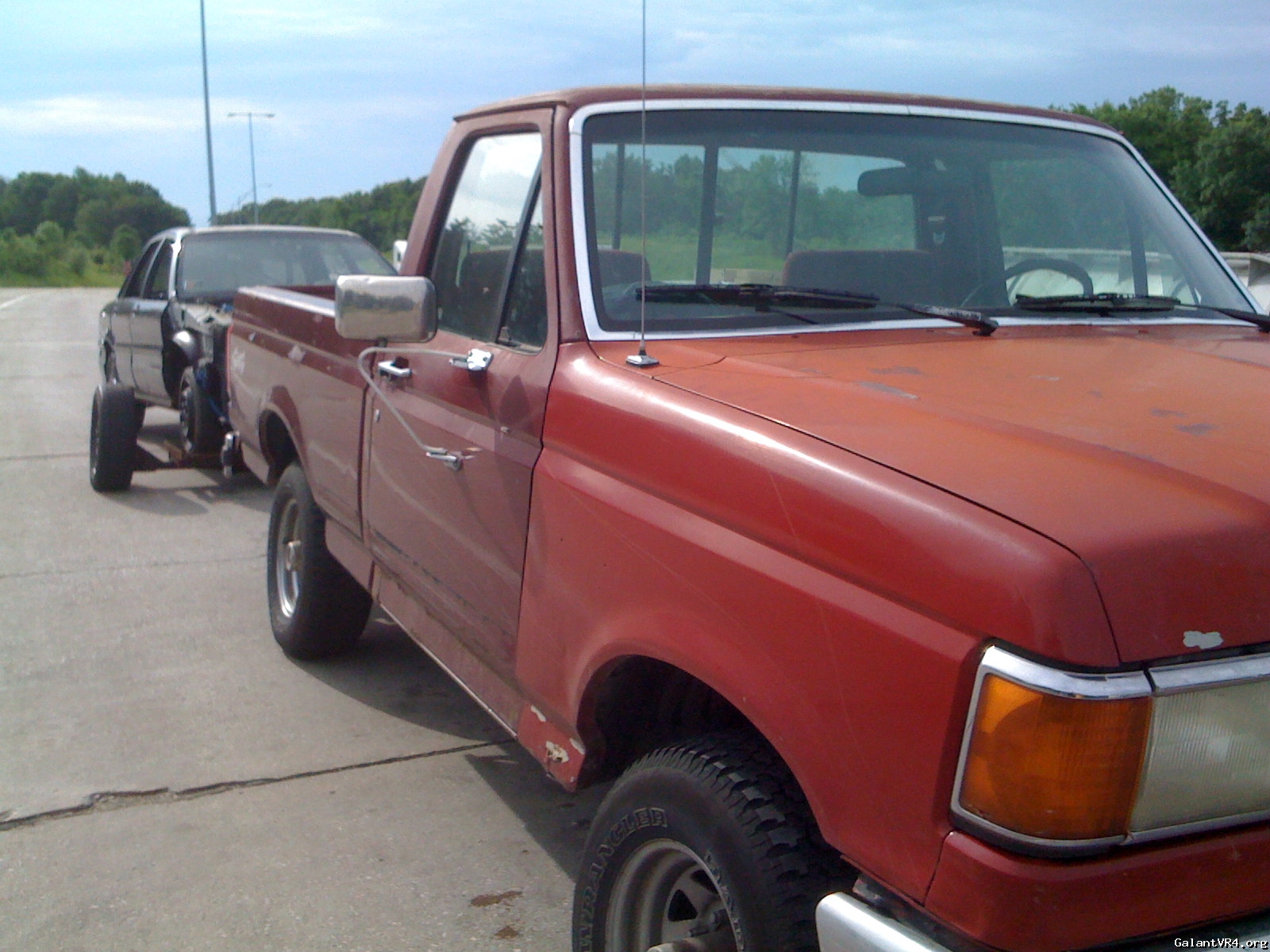

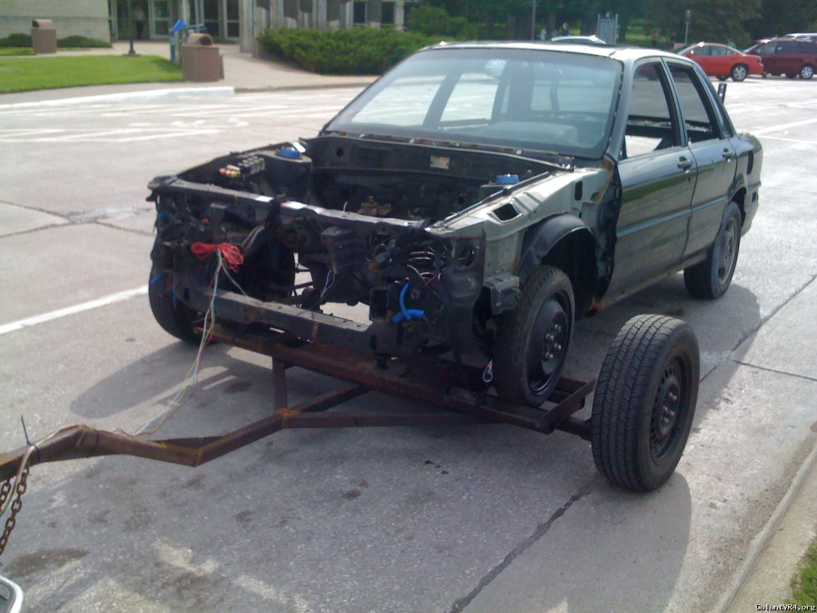

Dolly handled PERFECTLY! Never had one issue, never had to adjust anything, and never even came close to touching the doors, even pulling into/out of KFC. I'm still gonna add some stops, fenders, permanent lights and a hook for a come-along; but I'm very happy with it. Never even tried to wag back and forth or bounce uncontrollably.
Truck ran great! Not one issue, never even overheated (until I got home and was positioning the car to unload /ubbthreads/images/graemlins/crazy.gif). I added some oil about halfway home, and that was it. Averaged about 15mpg, which isn't bad considering going up there I had about 1000lbs in the bed (had the dolly mounted up on it so I didn't have to pull it up there, plus 7 wheels/tires), and coming back I was pulling the car. All in all, Great Trip! Maybe it was meant for me to have this car. /ubbthreads/images/graemlins/grin.gif
