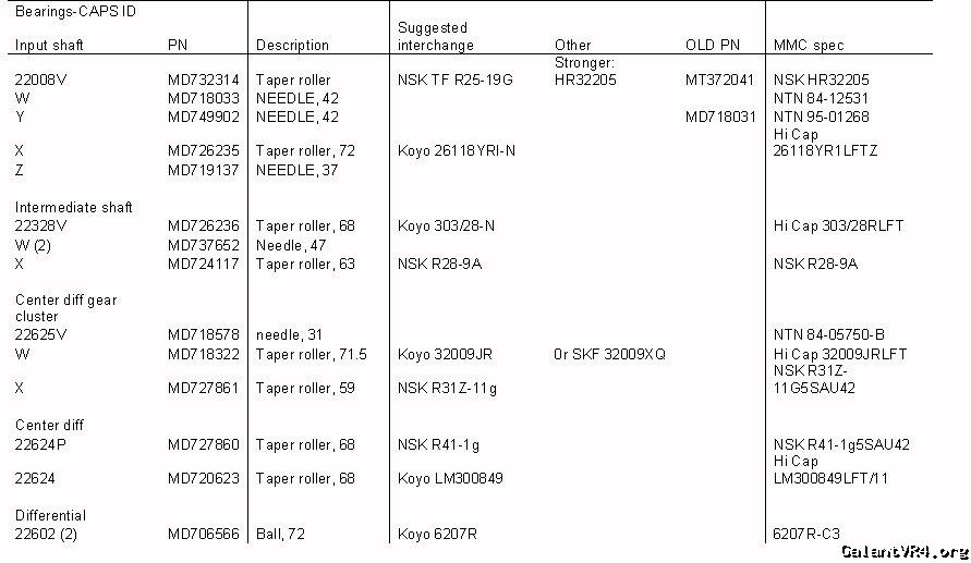

10,996
Found something. I put this together from CAPS three years ago, so not sure how accurate I can claim it to be.

/ubbthreads/images/graemlins/worthy.gif /ubbthreads/images/graemlins/worthy.gif That is helpful!
Input Shaft:
Outer bearing: Koyo 26118YR1-N
Outer Race: Koyo 26283-N
Inner bearing: NSK HR32205
Inner Race: NSK HR32205
Intermediate shaft:
Outer bearing: NSK R28-9
Outer Race: NSK R28-9A
inner bearing: Koyo 303/28R-N
inner race: Koyo 303/28-N
Center Diff case:
Outer bearing: Koyo LM300849
Outer race: Koyo LM300811
Inner bearing: NSK R41-1g
Inner race: NSK R41-1g
Center diff drive shaft:
Outer bearing: NSK R31Z-11g
Outer Race: NSK R31Z-11g
inner bearing: Koyo 32009JR
inner race: Koyo 32009J
Frt Diff bearings:
Koyo 6207R (Qty 2)
SEALS:
input shaft NOK AH1292E
Axle shaft pass side NOK AE6901E
Axle shaft drvr side NOK BH3340E
Output shaft to transfer case NDK ISD 30 45 6 AE
