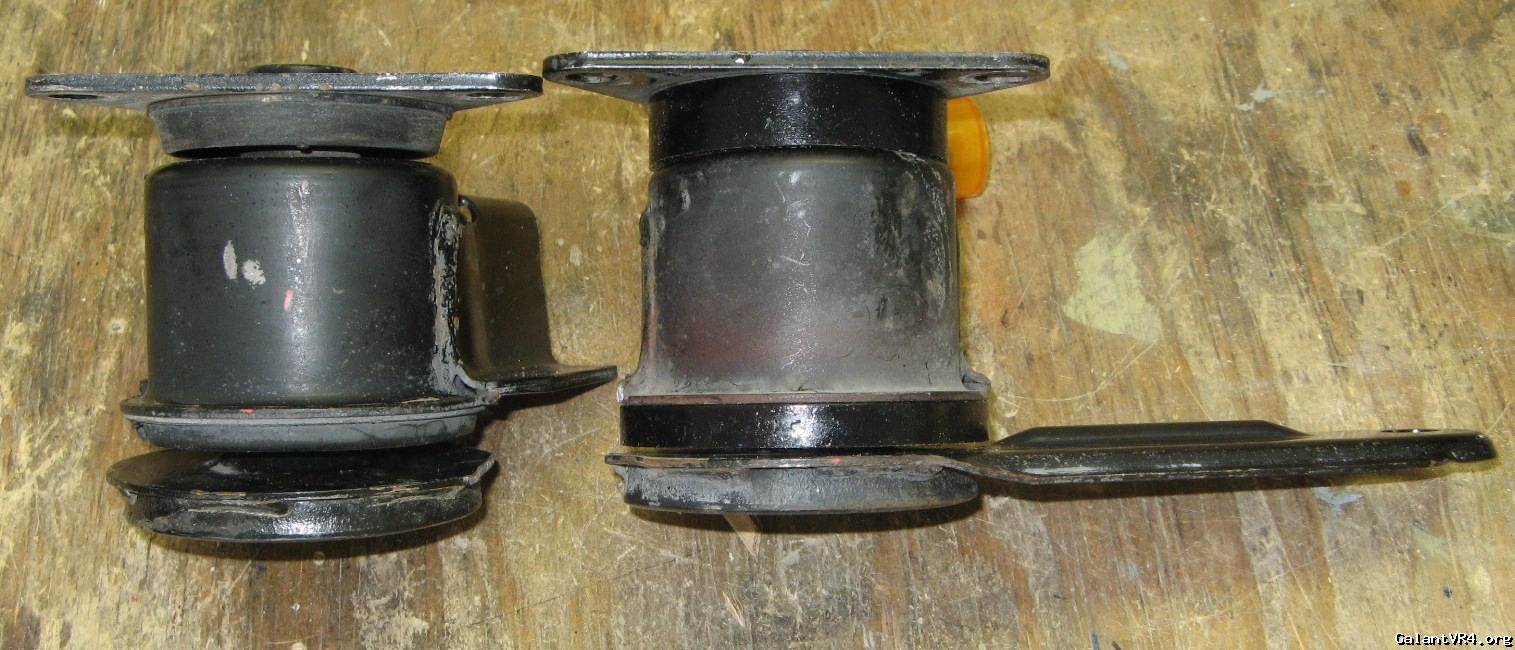

Don't know if this is the correct section, but does anyone know the torque for the rear suspension pin to body bolts?
For reference, the bolts that secure the triangular plate in this pic to the body.
