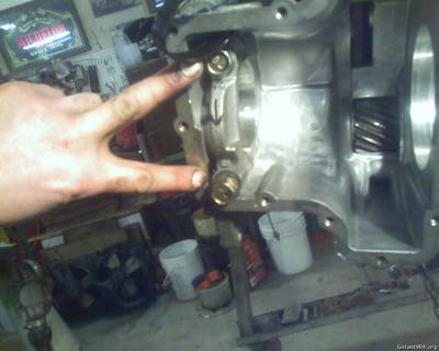

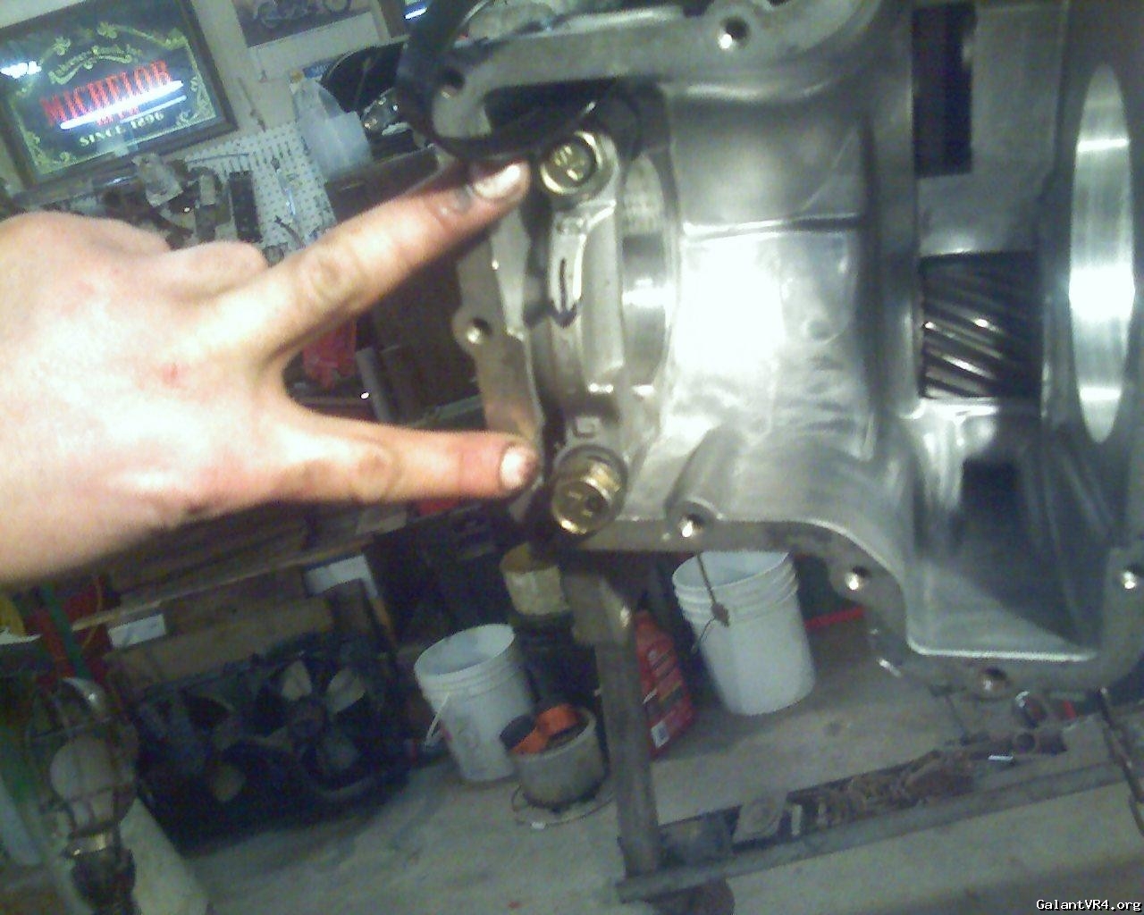

I have apart a 91 eclipse auto AWD trans, and am ready to put the diff back in, but do not have the torque specs for the differential cap bolts. Is there anyone that can come up with these?
Please let me know what you find.
From the FSM:
Differential front bearing cap bolt 43-58 ft lbs
