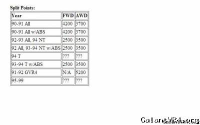

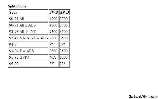

Actually, I was thinking about this. You're absolutely right, the split points between prop valves is significant. Just for that reason, I was considering keeping the ABS prop valve, and just blocking the ABS line ports. Thoughts?
