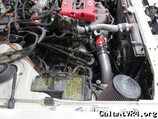

SO...... I have spent the last hour over on ECM Tuning and every log I see boost isn't coming on until 2800....I'm coming on at 2300. The rest of the rpm it seems like I'm also about 500 RPM less than any other log's that I can find.
Why is it that you guys think I have a problem? This is a new engine, with new gaskets, new valves, new rings, new turbo, etc. I'm not new to building engines or modifying things. I have built turbo Porsche's and other higher end cars, but this is my first DSM and my first turbo car.

Seems like I need to get some more data on my boost levels at RPM. This is the fastest car to come up on boost that I have driven in a long time. I don't believe that I have anything wrong and I know I have made an improvement on how this car was with the stock set up. I didn't have ECMlink before I did all this modifying and I didn't think to take all this data the hard way or even look for that matter. I only drove the car 385 miles from purchase to bent valves! I did notice today that it comes on up to 10 lbs when I first take off at about 1800RPM...Didn't have to much time to mess with it and get my laptop, but hopefully will next week.....I may even be able to paint it!

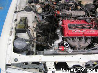

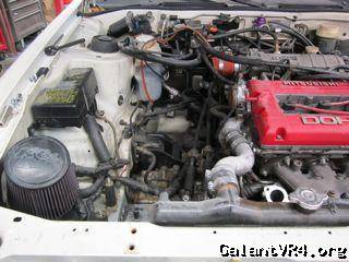

Quoting zberto:
Interesting. The hood turned out good. I first saw the mock up with those sharp edges and I was like uh oh. Im eager to see the hood on the car.
You mentioned that there is nothing hot behind the intercooler but the trans is right below there.
Do you still have ac?
And do you feel like snapping a pic of your engine bay with the ic out so I/we can see what the intake pipe and mounting points look like?
I do still have A/C. Worked some more today on the car and got the hood fitting the way that it should.
