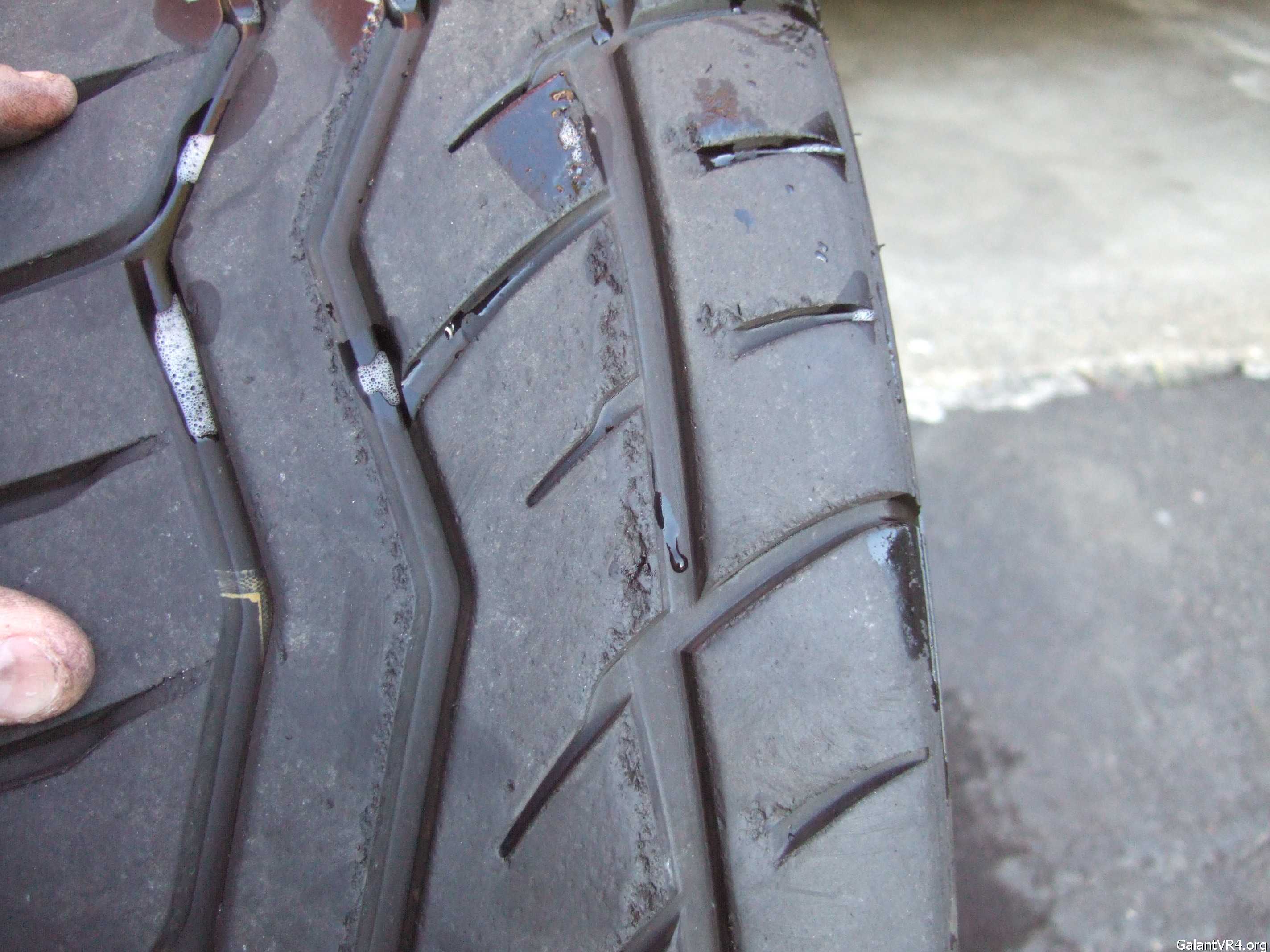

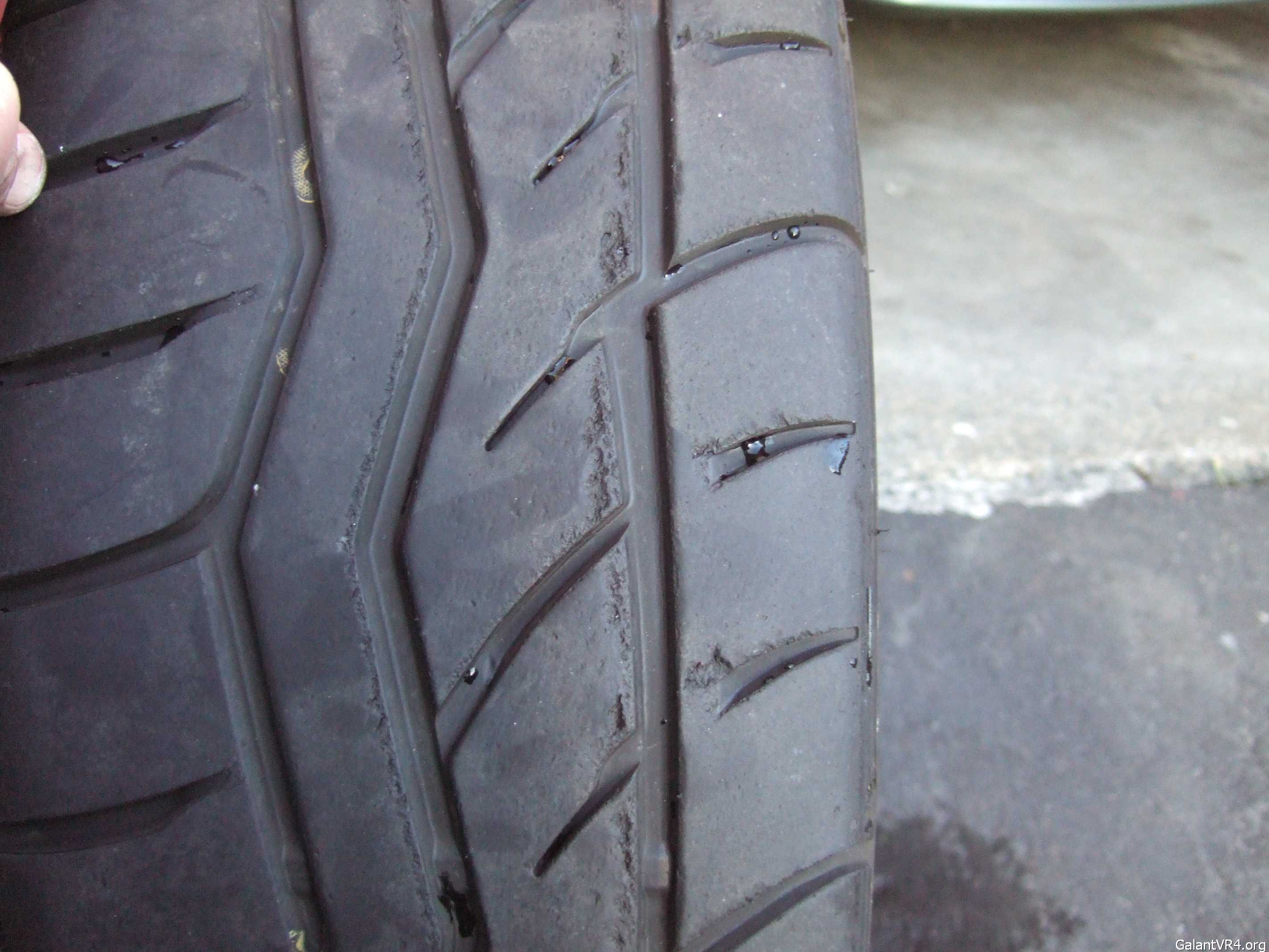

They'll be great in the dry. I used mine for a different purpose and found that they sucked in the rain (as you would expect from looking at the tread pattern) and got slick after 4-5 hot laps. I chunked the Falkens WAY worse than the Hankooks.
