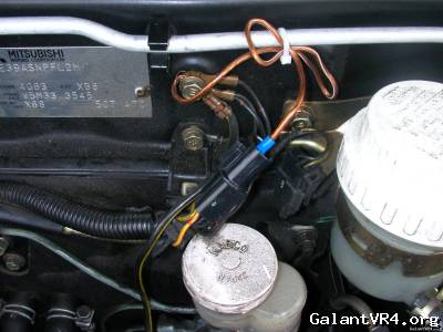

He was saying you can't set the timing with a data cable plugged in to the ODB1 port. If you don't have this at all, then set the timing with the pin ground, after you've warmed up the engine to full operating temperature.
