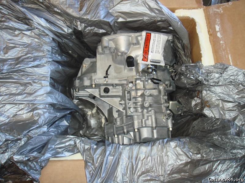

The last 2 big parts came in with Pics Are Working Now
onesickcrx
Jun 3, 2007
1,076
NY

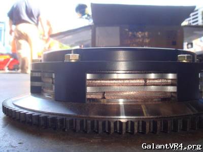

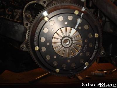

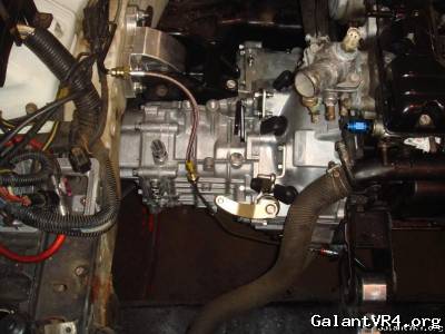

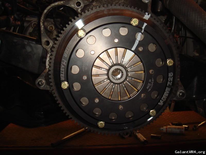

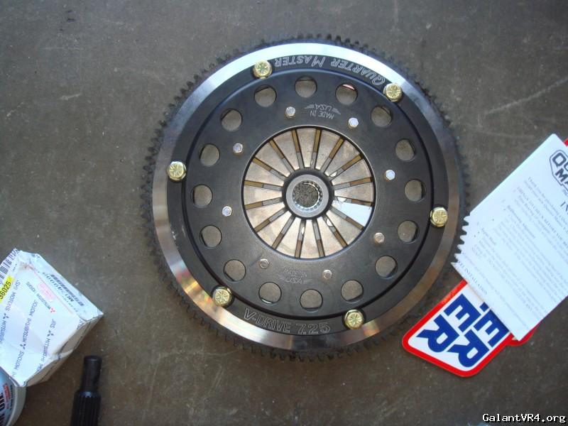

/ubbthreads/images/graemlins/devil.gif Look what came in this morning It is a new Shep stage 4 and Quatermaster twin disk looks like I should make it to shootout now /ubbthreads/images/graemlins/devil.gif

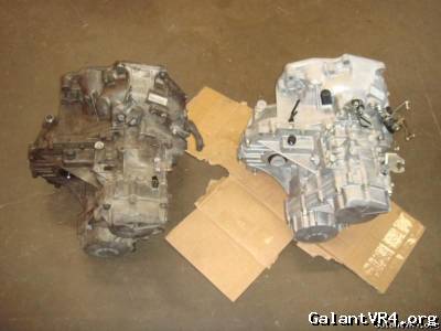

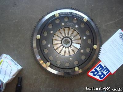

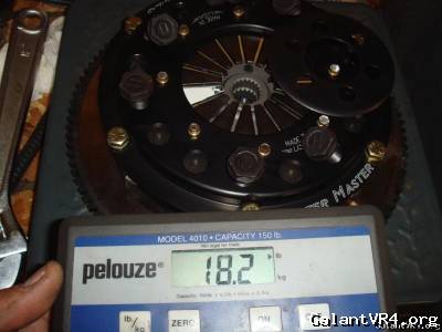

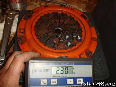

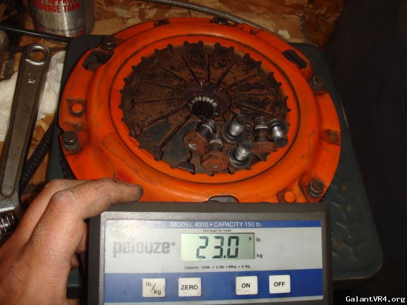

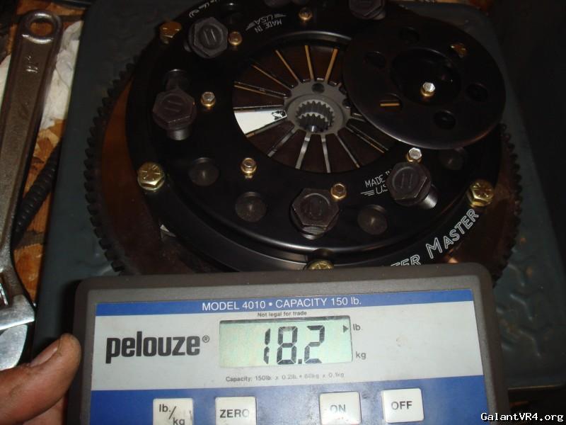

More updates I weighed my new Quatermaster setup with all the hardware to see how much lighter it was then my Centerforce Dual Friction with Act Street Light flywheel and hardware.
Results 18.2 lbs QM vs 23 lbs CF = The Quatermaster is 4.8 lbs lighter I think thats pretty good /ubbthreads/images/graemlins/grin.gif

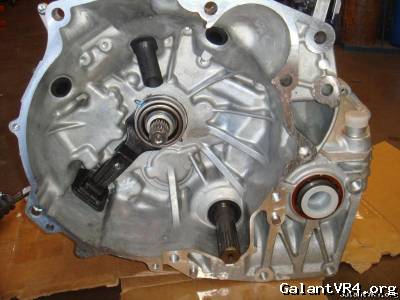

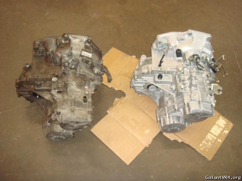

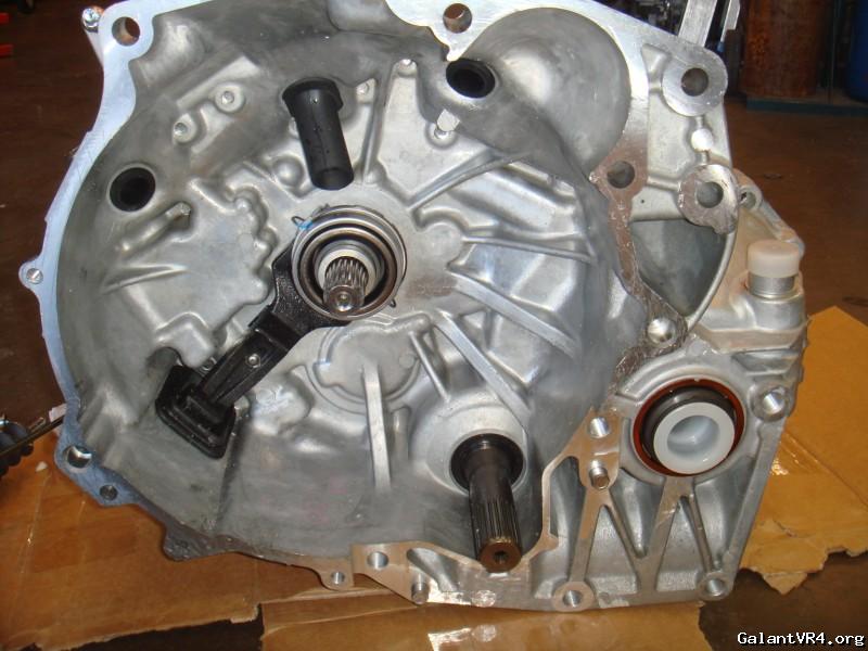

Also picture of my dirty old tran vs new /ubbthreads/images/graemlins/grin.gif

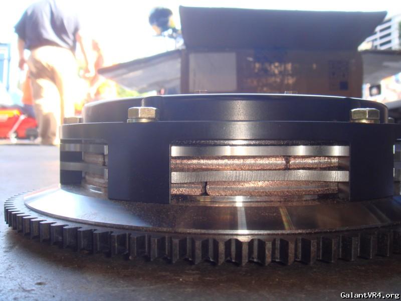

How's the chatter with the twin disk setup? I know on some cars it is really loud, sounds like a really bad throwout bearing
11,982
Quoting boosted_85:
It's pretty bad, but it's to be expected with a twin disk. Chattery, loud reverberation on deceleration, and sounds horrible to people next to you when you're sitting at a stoplight with the clutch disengaged. But they allow quick shifts. /ubbthreads/images/graemlins/grin.gif
