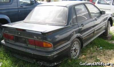

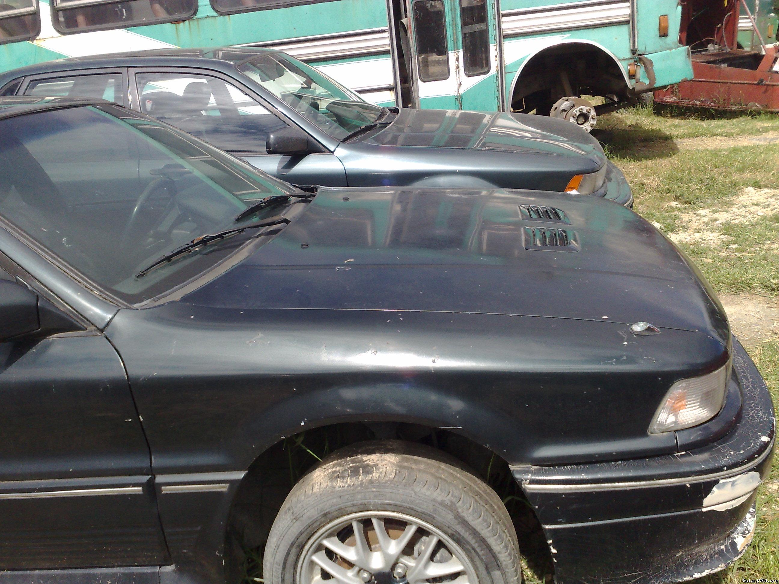

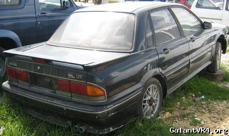

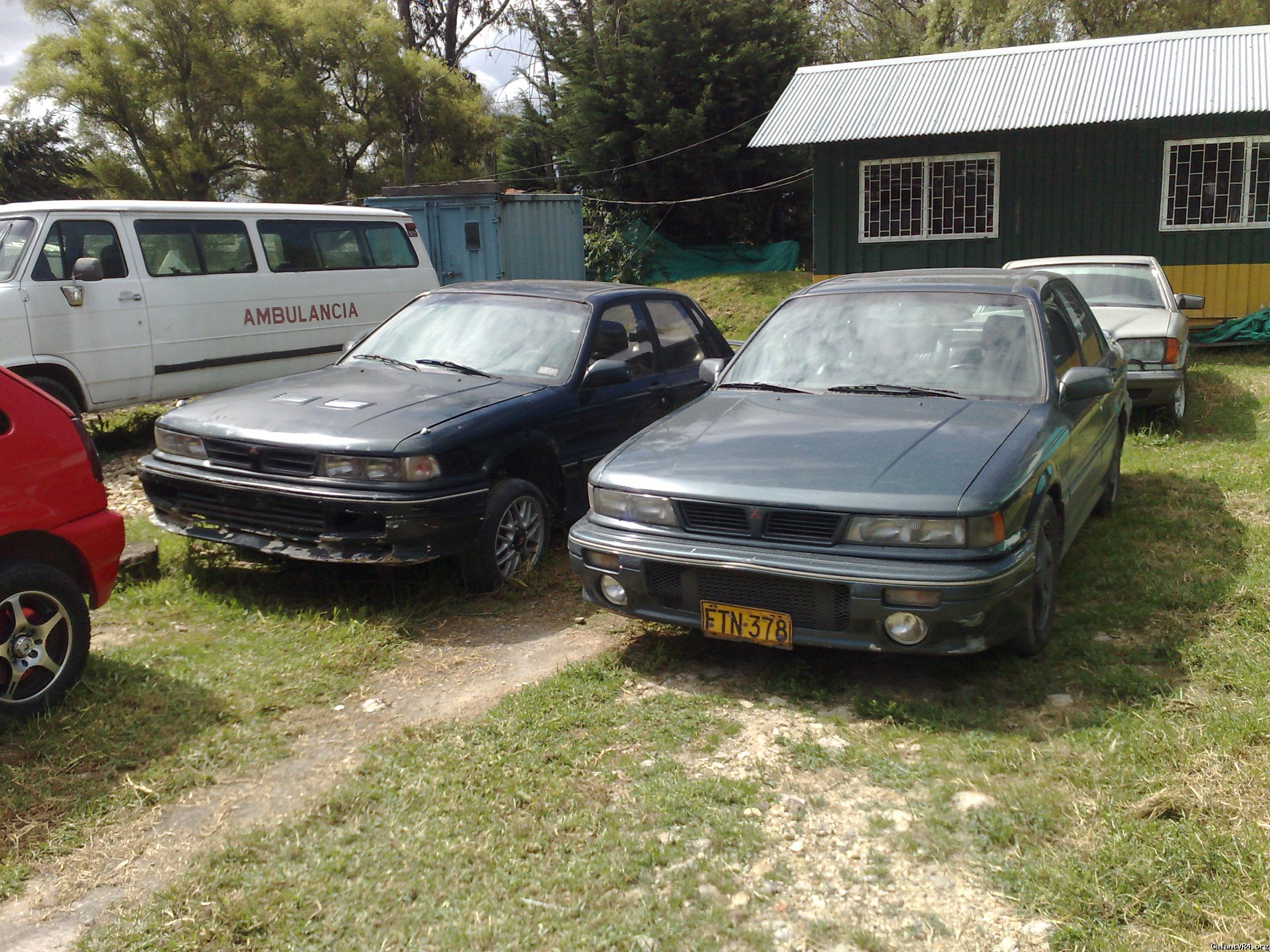

this is the 1994 Galant ZX E33A AMG style i bought yesterday, i'm using it for parts to my GVR-4

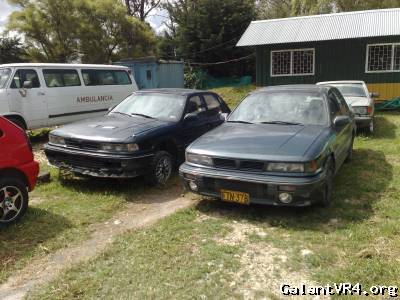

side to side...

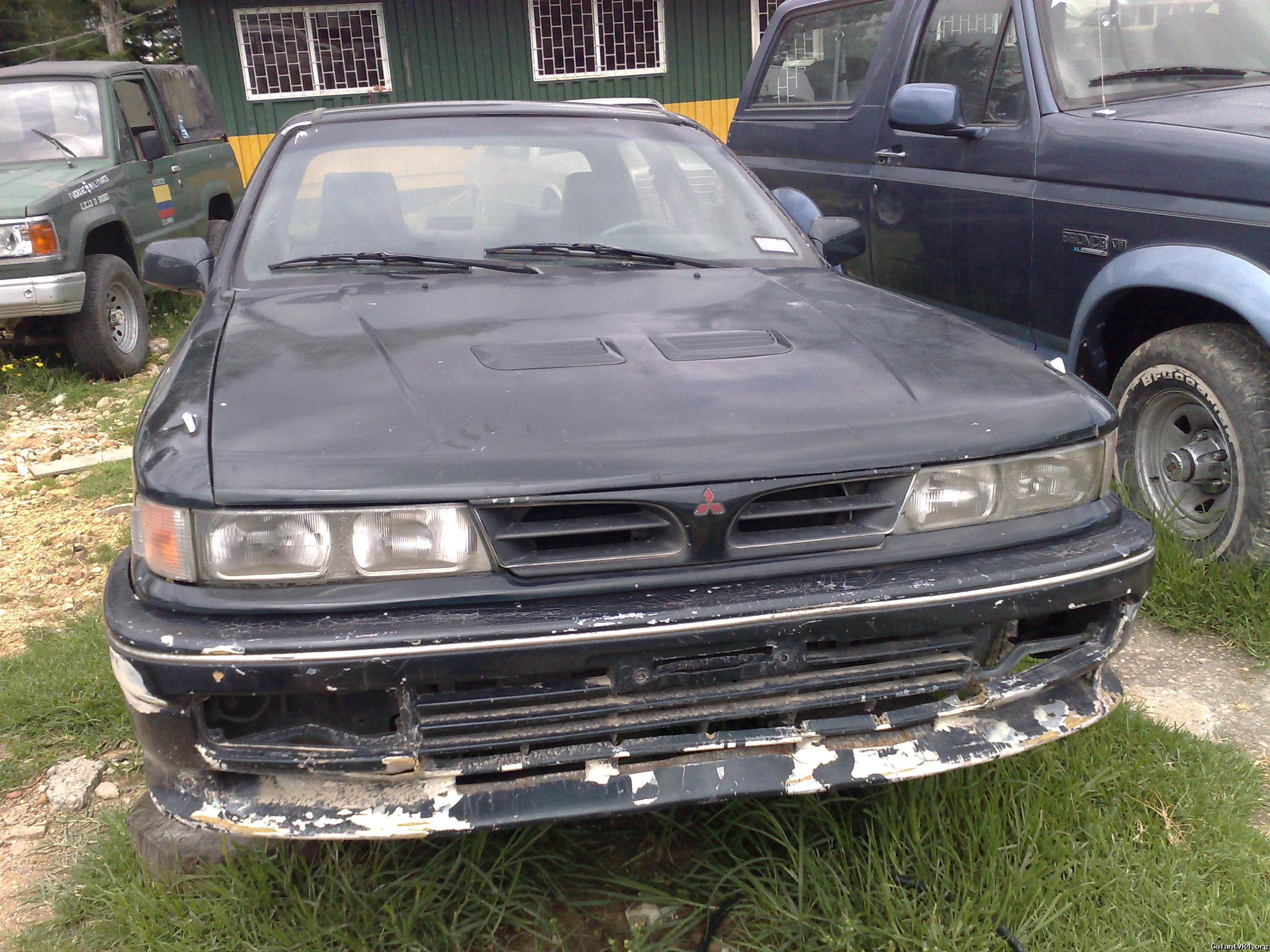

Interesting. Your new Galant looks basically like a LHD JDM model. None of those parts are AMG related, but it's pretty sweet you have all the JDM body parts right there in one package to swap onto your good GVR4.
*edit* I just noticed the wing. I guess one part is AMG related. Weird combo.

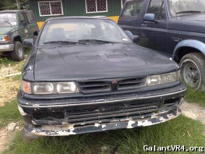

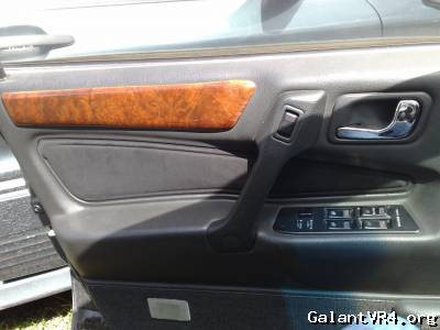

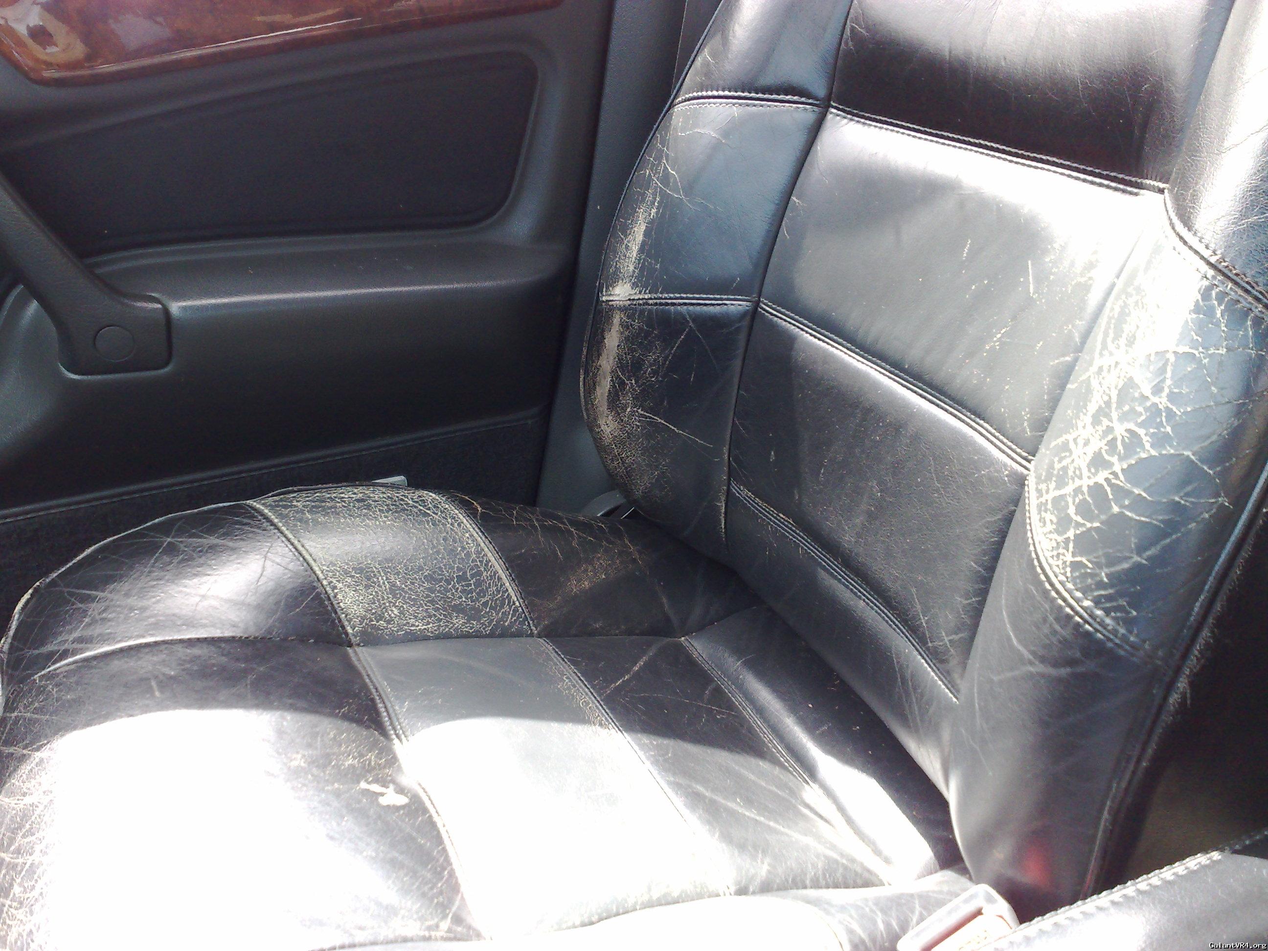

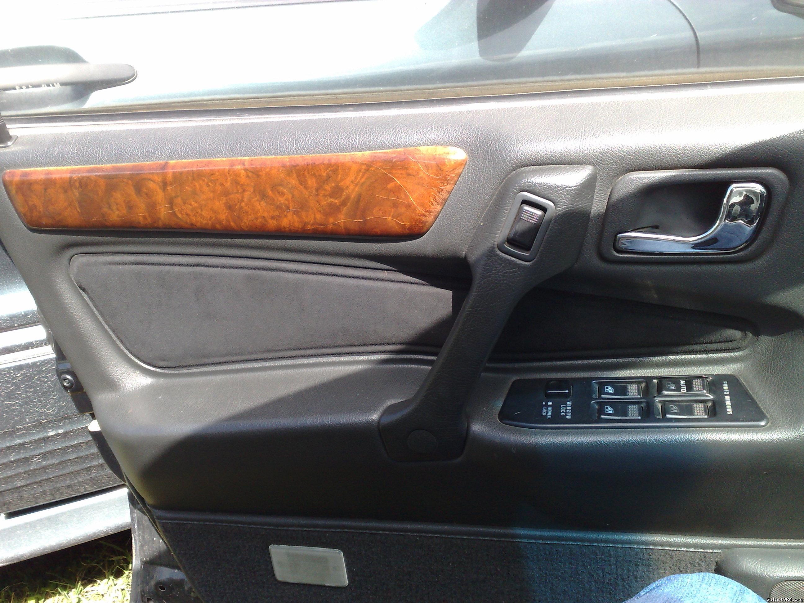

Not only the wing, also the seats has the grey colour in the middle, the hood has the vents and wood imitation parts on doors interior, i've seen those only in AMG Galants.
The N/A head will be inspected and i would change all parts that need to be replaced such valves, guides,seals, is just turbo head is been machined many times already, the N/A head is out by the very first time and looks much better. Maybe i will swap bumpers too, US Galants bumpers are very heavy, the other galant bumpers are less than half weight, just need to fix the front one.
11,982
You're right about the seats and woodgrain, but the vented hood wasn't just an AMG thing.

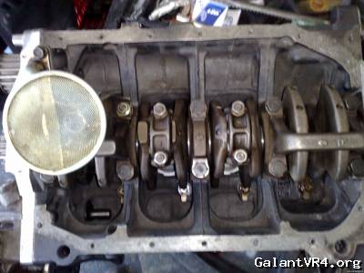

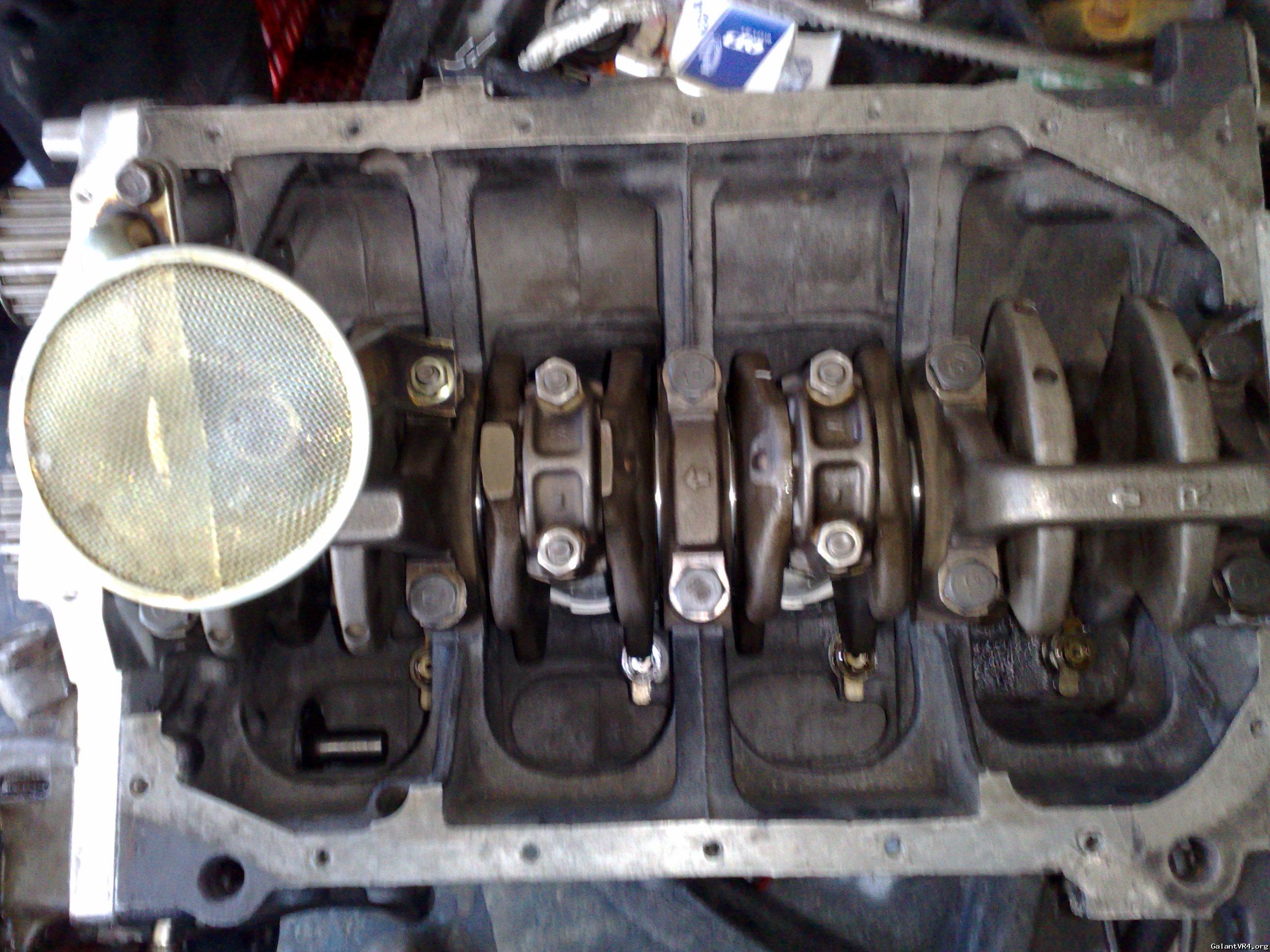

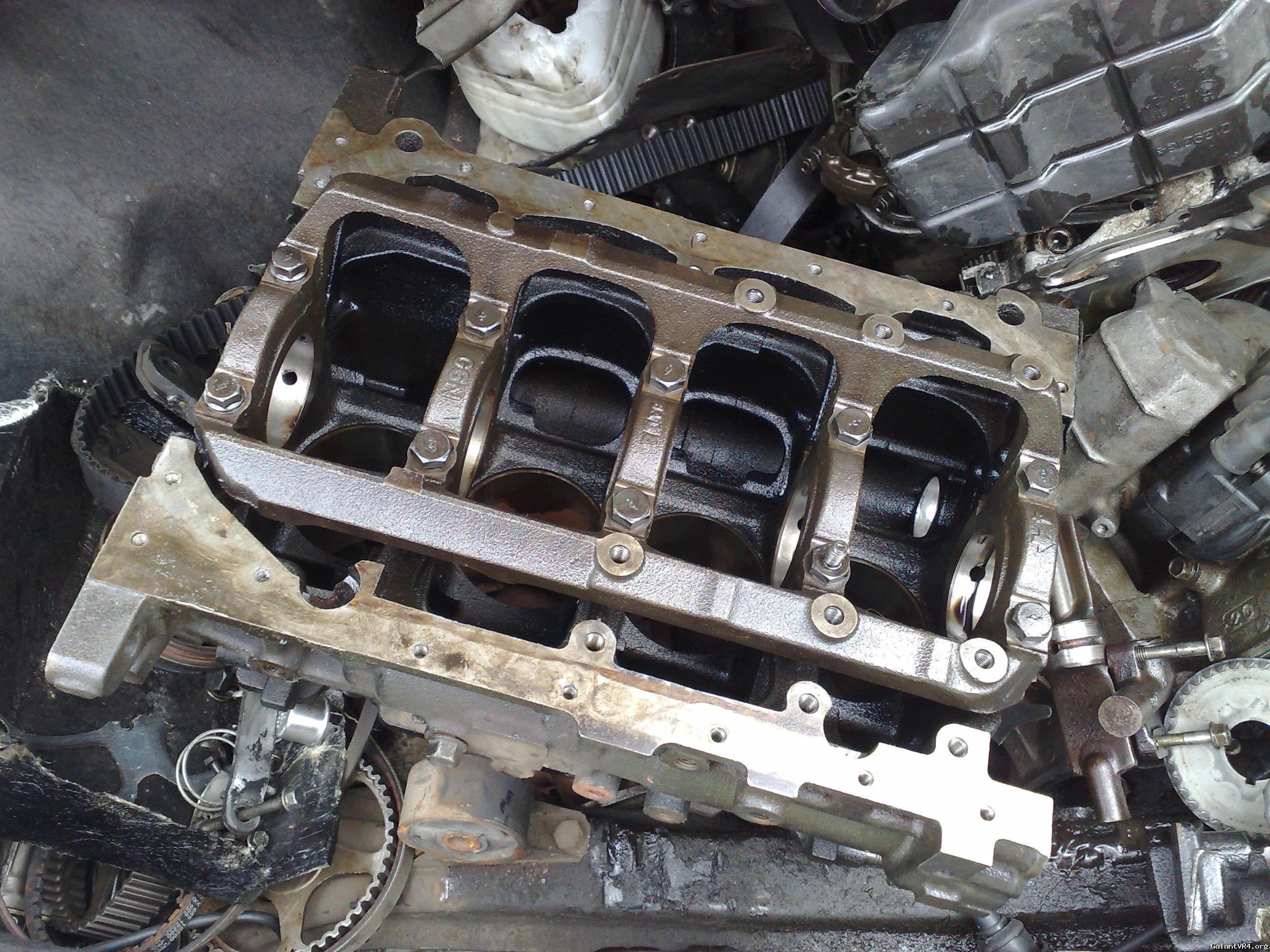

The bottom of the blocks looks different, the N/A has a weird part than the turbo doesn´t.
The last owner of the N/A was rebuilding that engine and looks ready to build while turbo block needs machinery job, new rings etc, i was considering to use that block and swap crankshaft, oil pump and what ever is different to save some money for now. Later with more time and founds i can prepare ther other block with forged internals and put it back to the GVR-4.

4G63 T block
4G63 N/A block

Your new motor is a 7 bolt, not a 6 bolt. Evidenced by the main girdle and the shape of the hydraulic tensioner (on the left corner of the picture). Take a picture of the middle main bearing cap side profiles from both side of it. I think it still use the attached thrust main bearing style, which is early 7 bolt style. Check for wear mark on the crank middle thrust area too. If it is the early style 7 bolt with attached thrust main bearing style, don't use this block for rebuild.
ok thanks for your advise, block is on the ZX now, i will have to wait until is removed to take the pictures.
In case it is a early 7 bolt, can i use just the head?

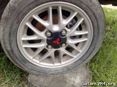

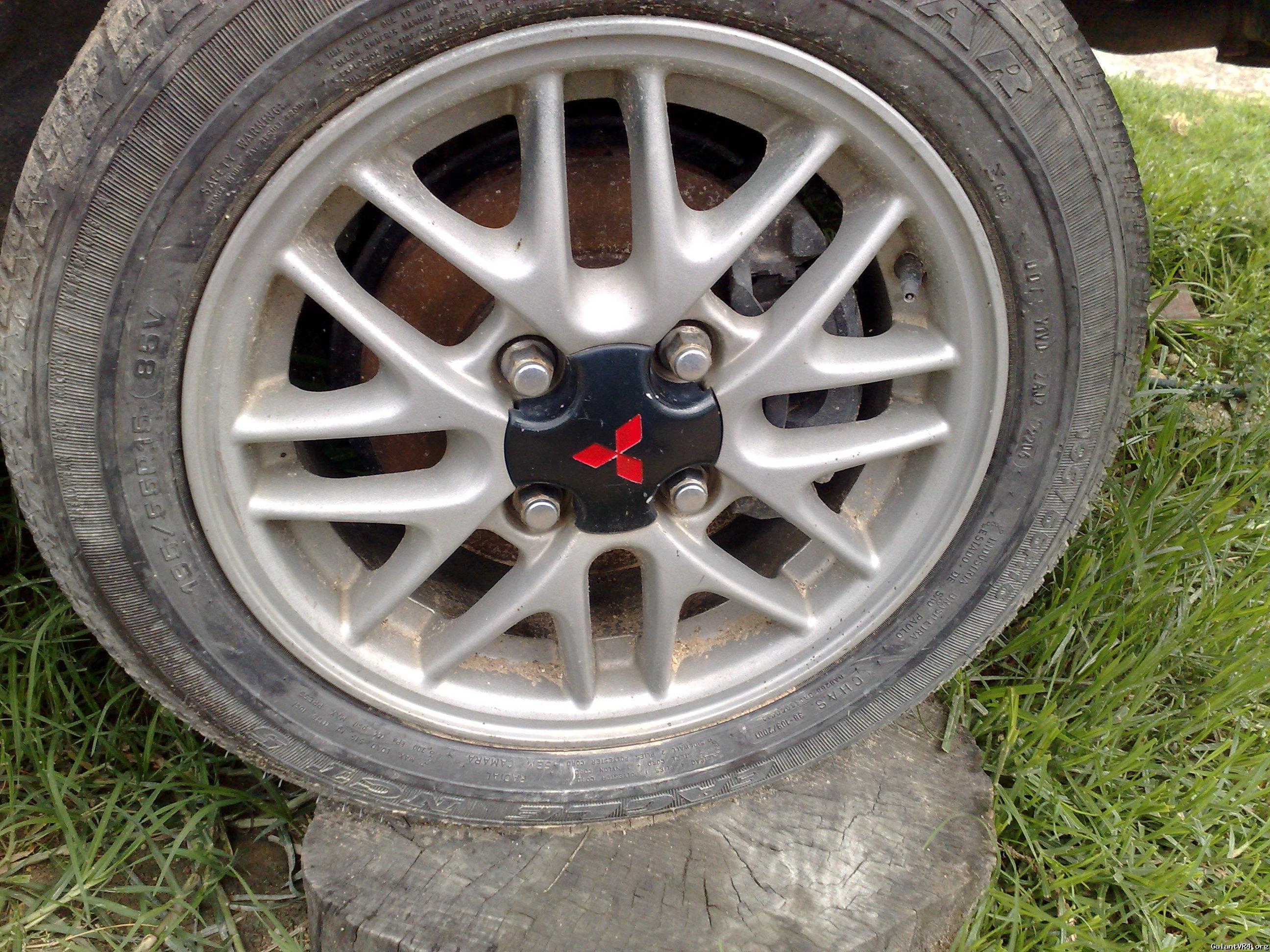

It has the USDM specific front grille, JDM VR-4 Evolution hood, JDM 7th gen (facelift) Galant/Eterna rims. definitely a bit of a mish mash.

first inspection showed both heads are the same. No differences on holes, sizes, it looks the other engine is a 6 bolt or 7 bolt with 6 bolt head.
