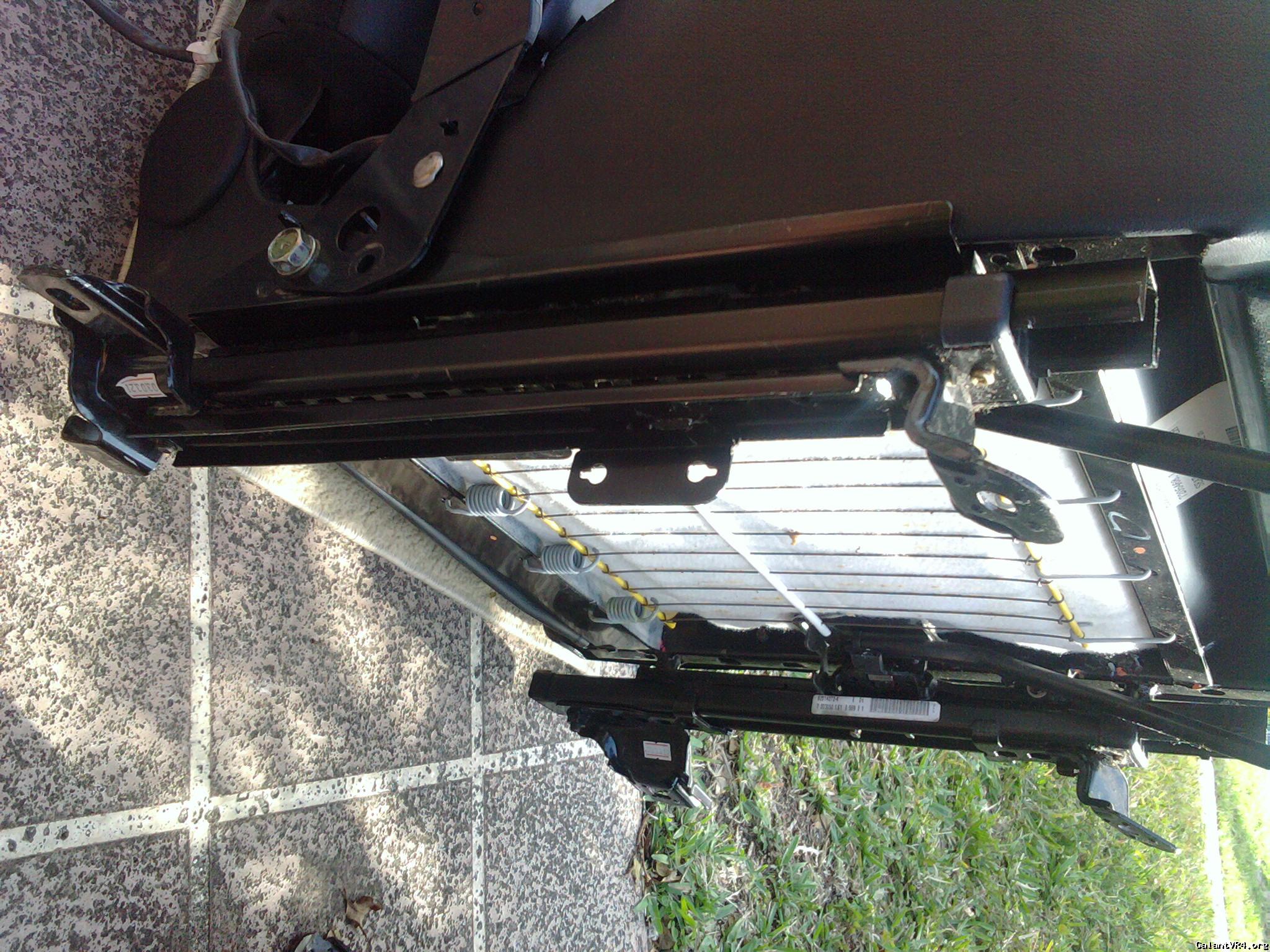

For those that have installed the seats, did you remove the Evo mounting legs? I think that's what I need to do but I can't see anywhere in this thread where it says to do so. See the 4 mounting points in picture below. From the picture that 4stroke posted, I don't see these mounting points in them so I'm assuming they were removed. Just need confirmation before I start removing mine.

Yes, you do need to remove the Evo mounts. One side comes off in one piece, while the other side has two separate parts. I can't recall what size allen wrench it requires, but they are loctite'd on.
When I first went to install the seats after I got the Curtis mounts bolted on, I was a little concerned because it was never mentioned that we needed to remove the Evo mounts.
Thanks. After I removed the brackets the seat dropped a lot lower & things seemed to lined up a lot better. I'm still not done as I only have Curtis's brackets clampped on & not drilled & bolted up. I'm done for the night because I didn't get to do anything on my 'honey do' list today. I'm going to upload some pictures shortly.
