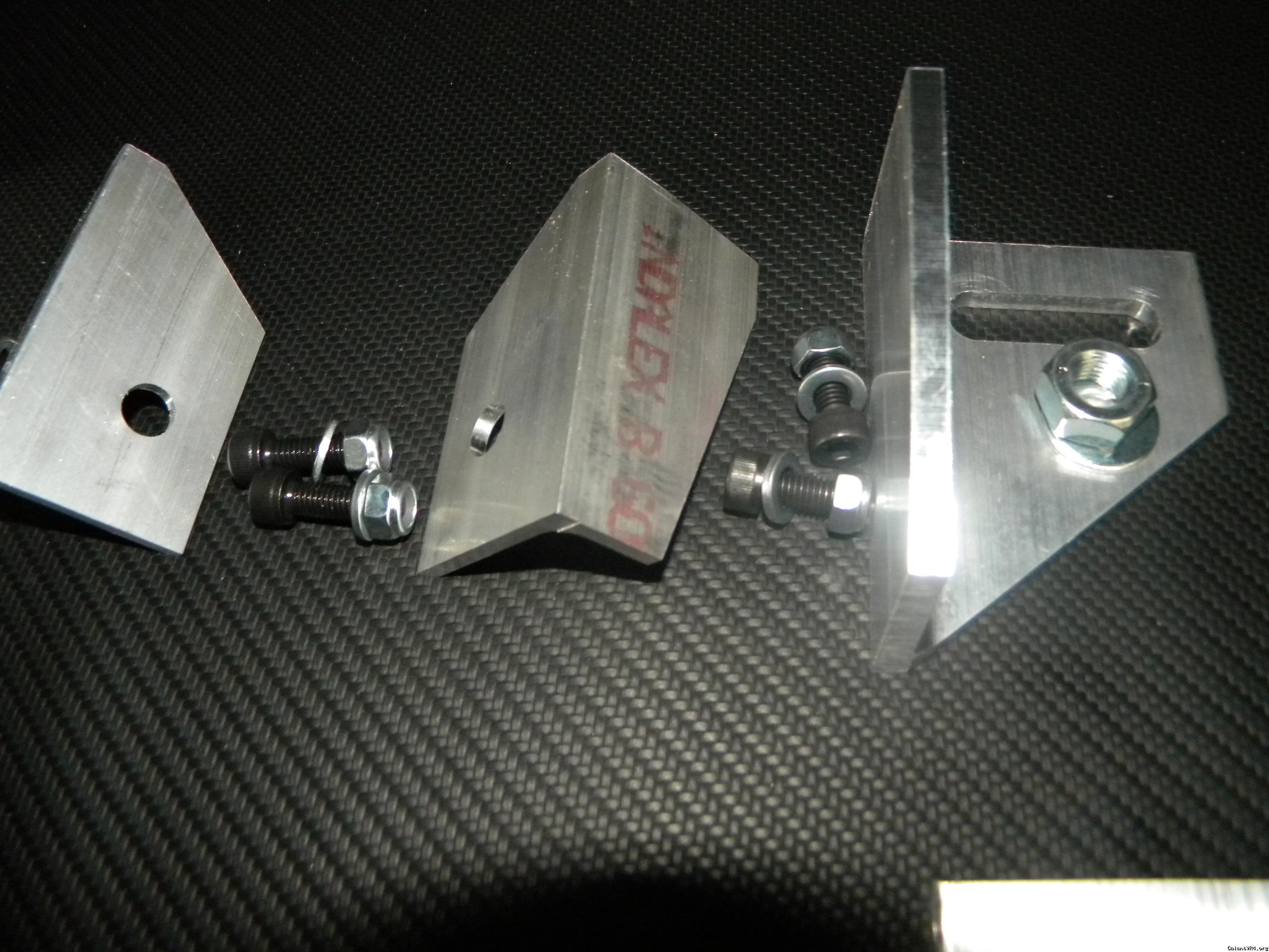

Me and Issac (izze01) on here got the bolts bagged Friday evening and Saturday I had to jump through hoops to get the cutter extension and tool holder to all clear the angle since I'm cutting the top side now but the code runs fine and clears everything. I'll cut the ones already paid for and get them boxed up tomorrow and as people pay I'll continue to box wrap etc. I always go to Fed ex about 5pm so They be in the system and the tracking numbers I send tomorrow will be in the system then. Since they count bolts by weight I got extras of some but got shorted on one of the big allens for the floor and 6 of the lock nuts but I'll run by and get them this week. Tomorrow I'll take a picture of everything and show where all the hardware goes with measurements etc.
As for the angles to be bolted together. You'll need a small drill bit for a pilot hole a larger for the bolts. Its a 6mm and not measured what a normal or number size bit is for that and 4 copper pennies and two pairs of vice grips. Pennies or small pieces of aluminum make good vice jaws against aluminum. I swear to God if I see install pictures and I can see vice grip marks you'll be getting a name change. Something like "Fail" "couldn't find the hole" "I suck at drilling holes" etc. I spent way to much time with these to see you screw them up. /ubbthreads/images/graemlins/grin.gif

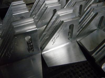

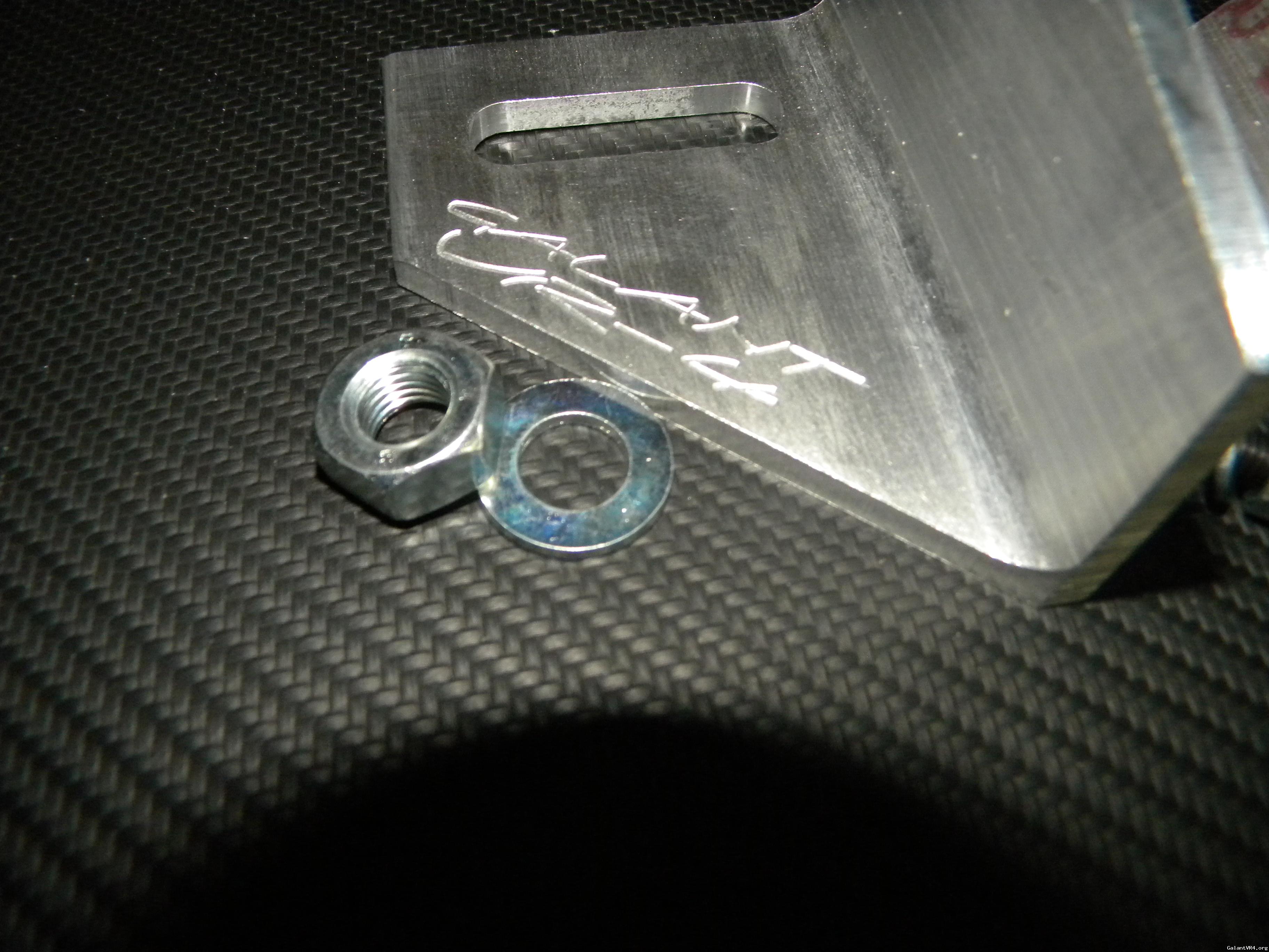

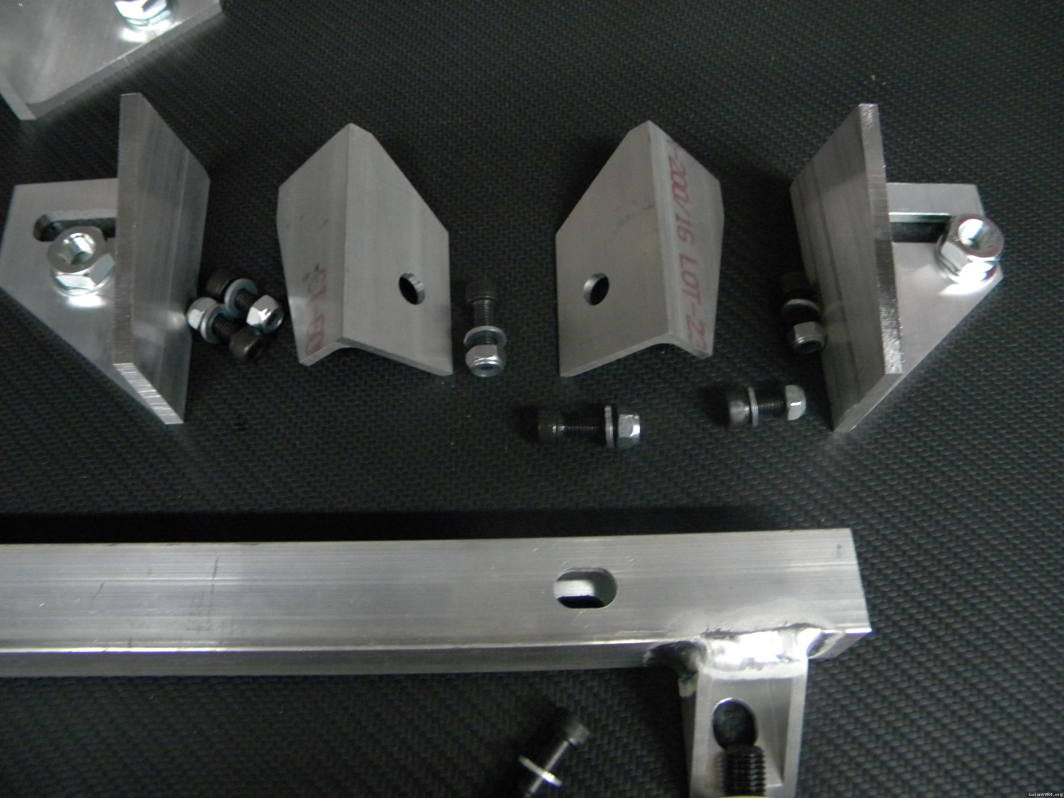

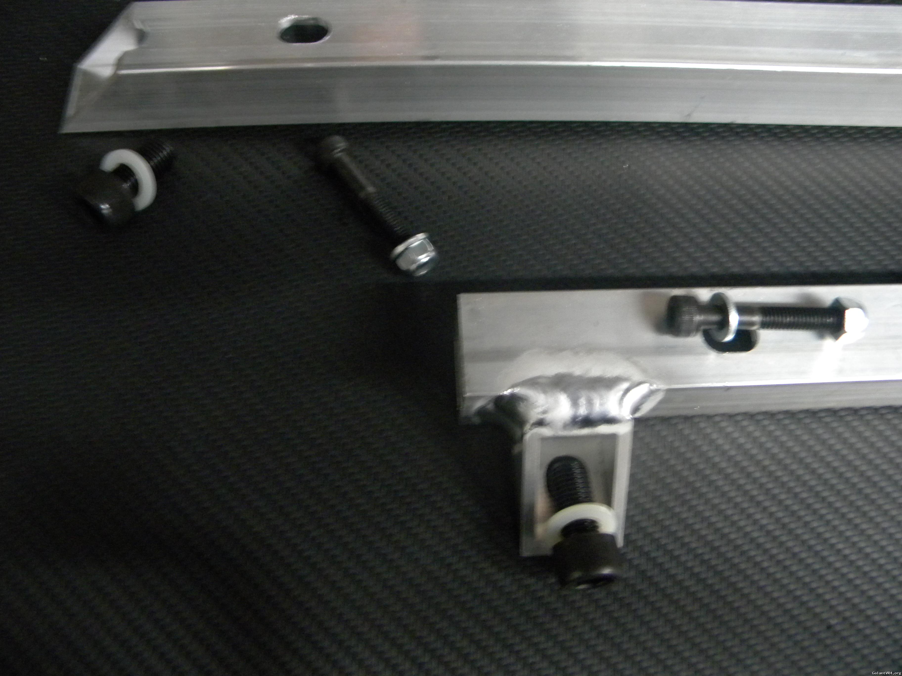

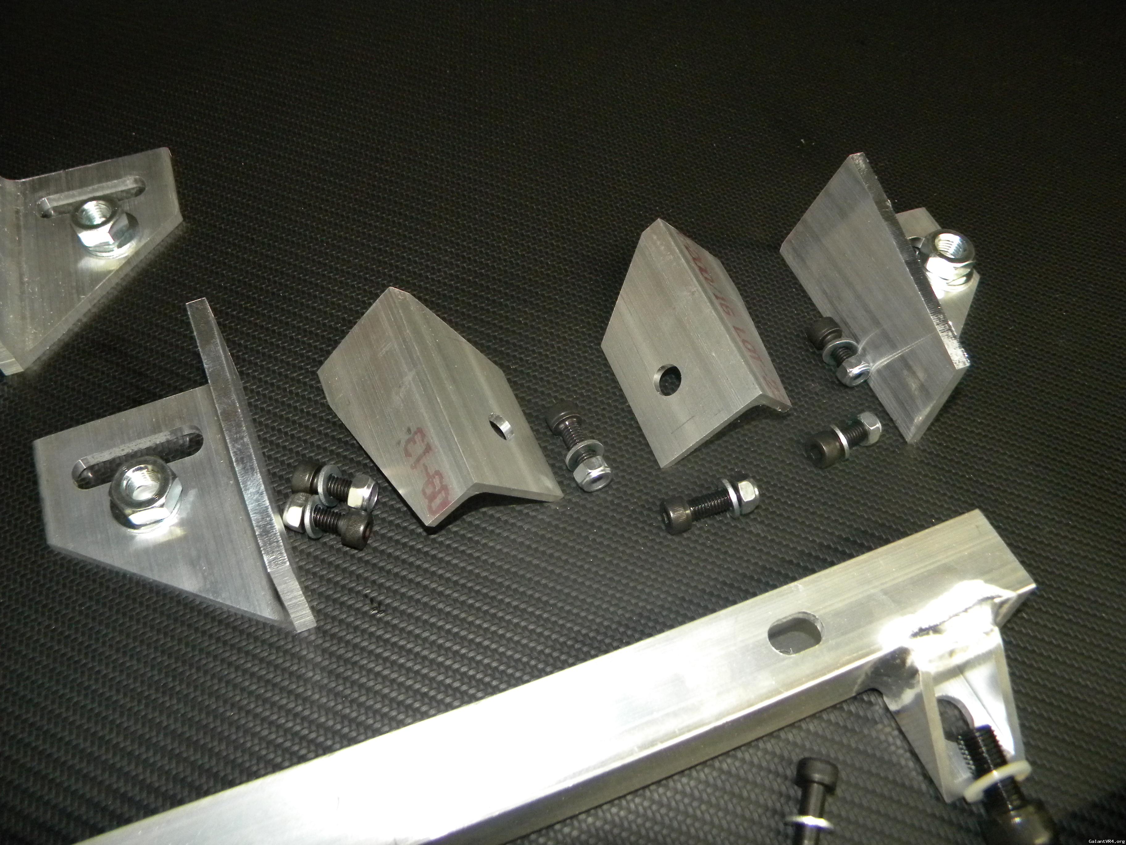

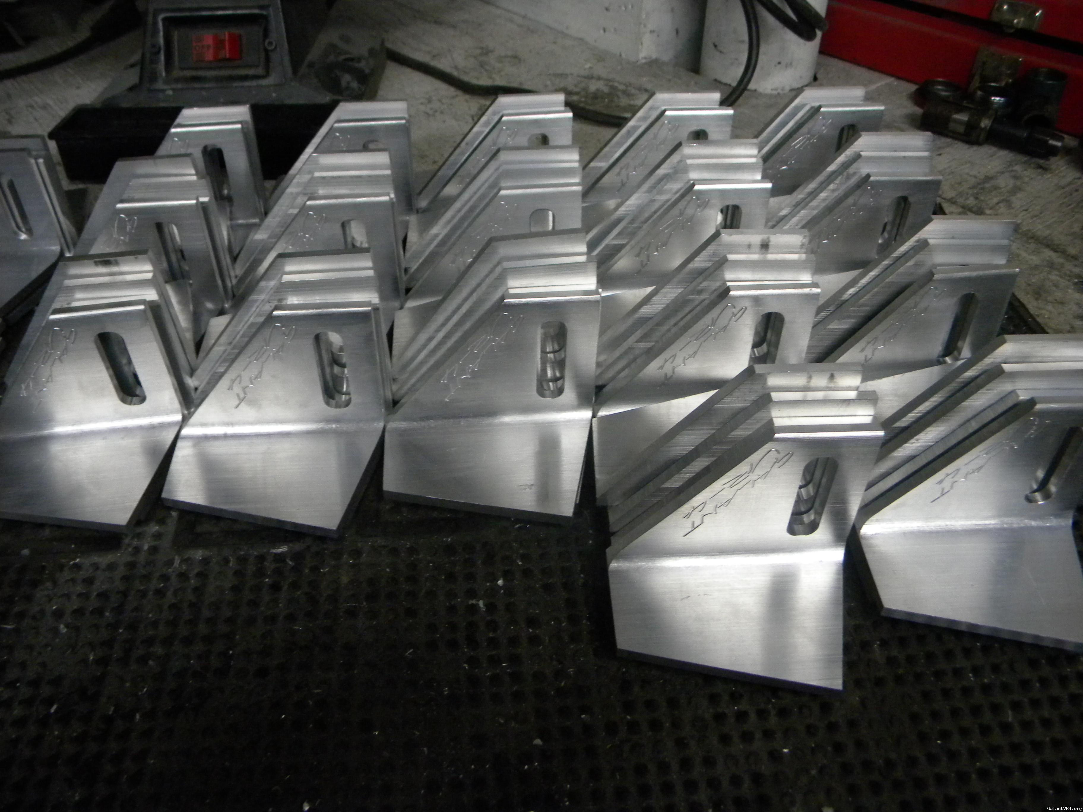

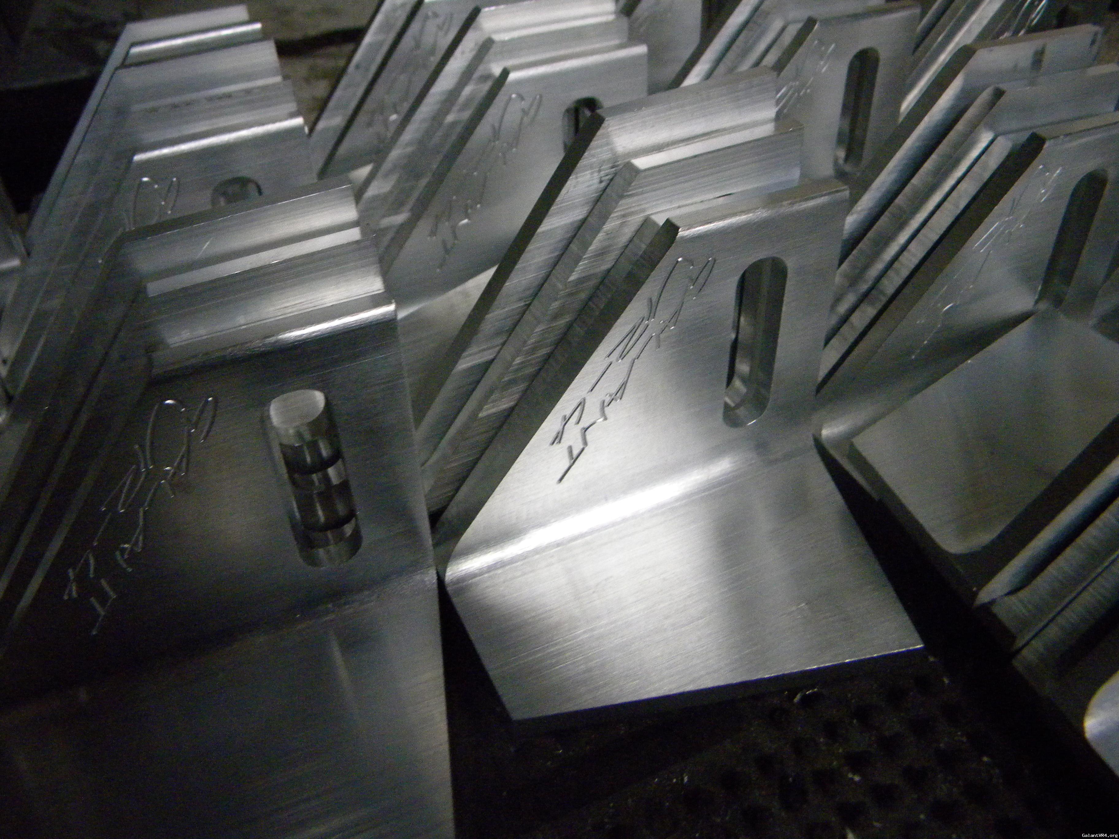

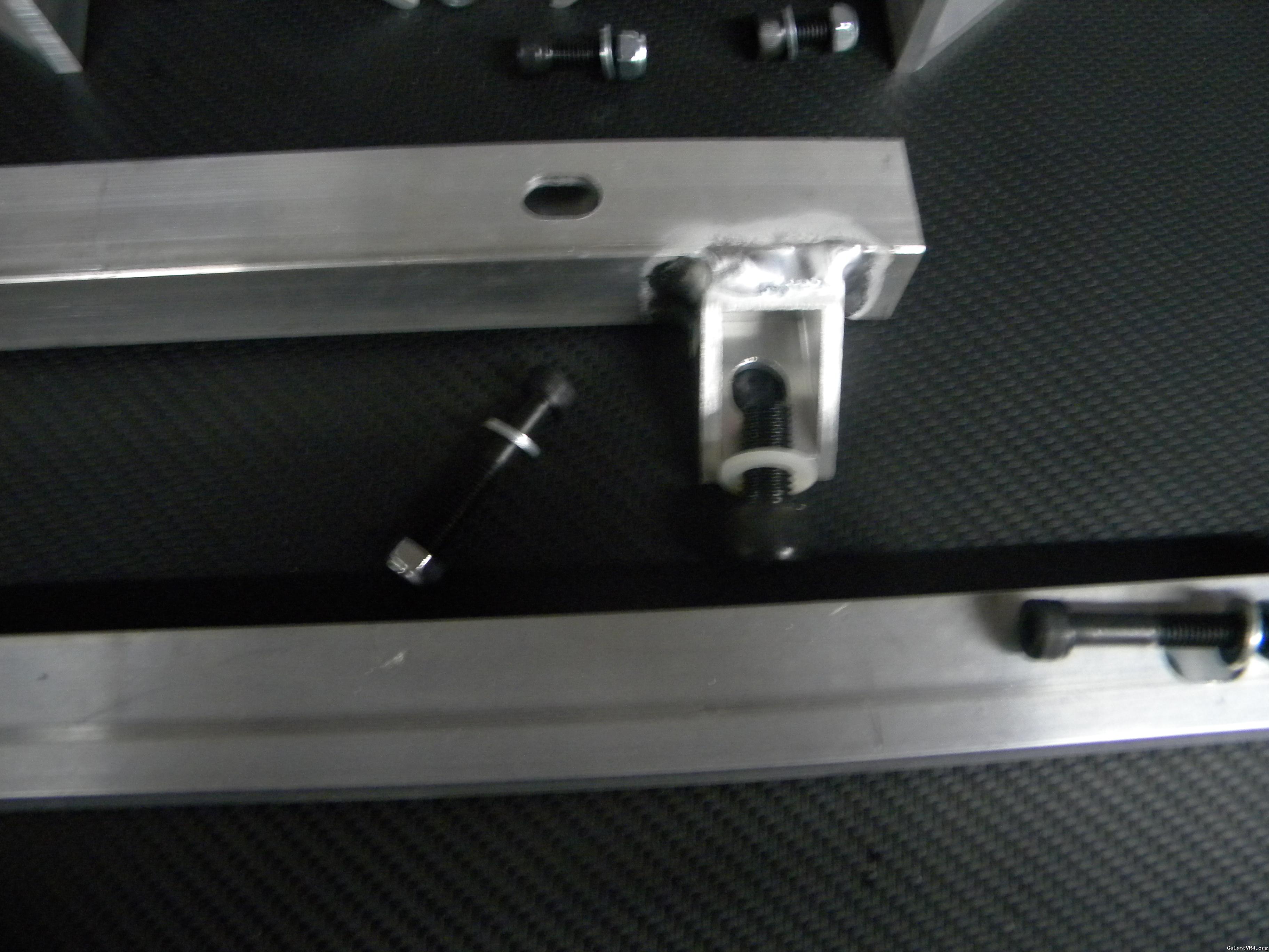

Ok here's pictures 17 sets now have logos I'll do the others as orders come in.

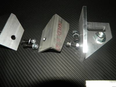

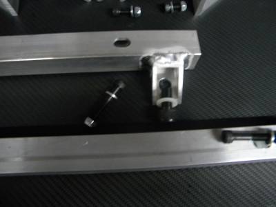

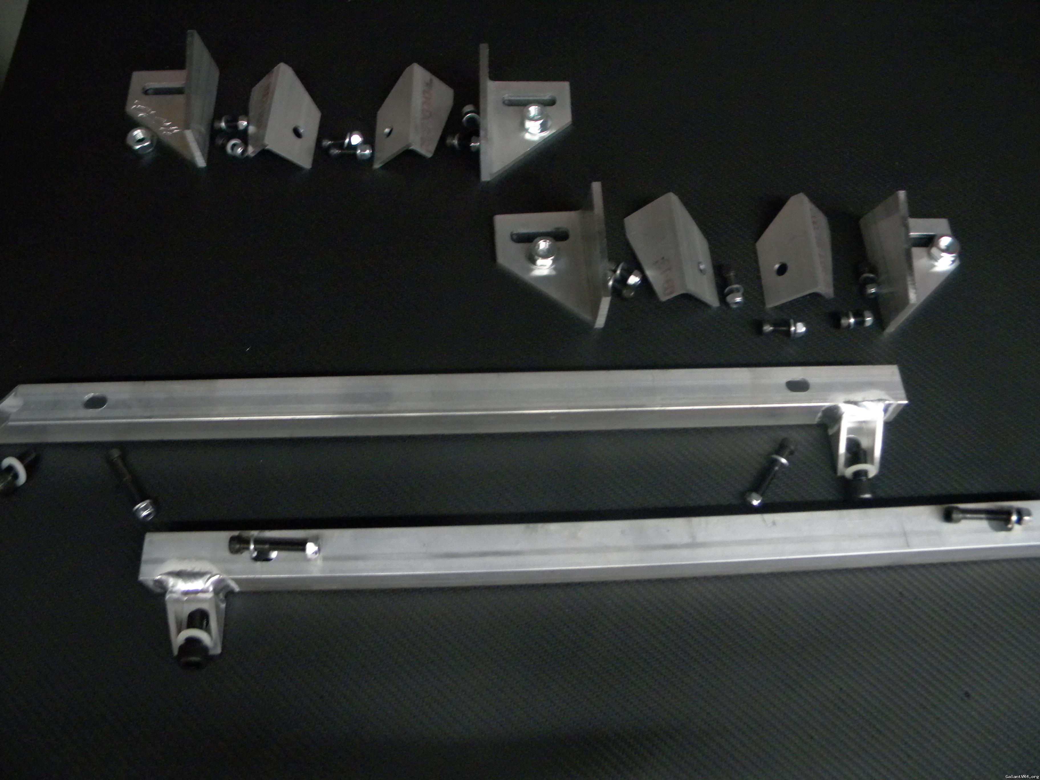

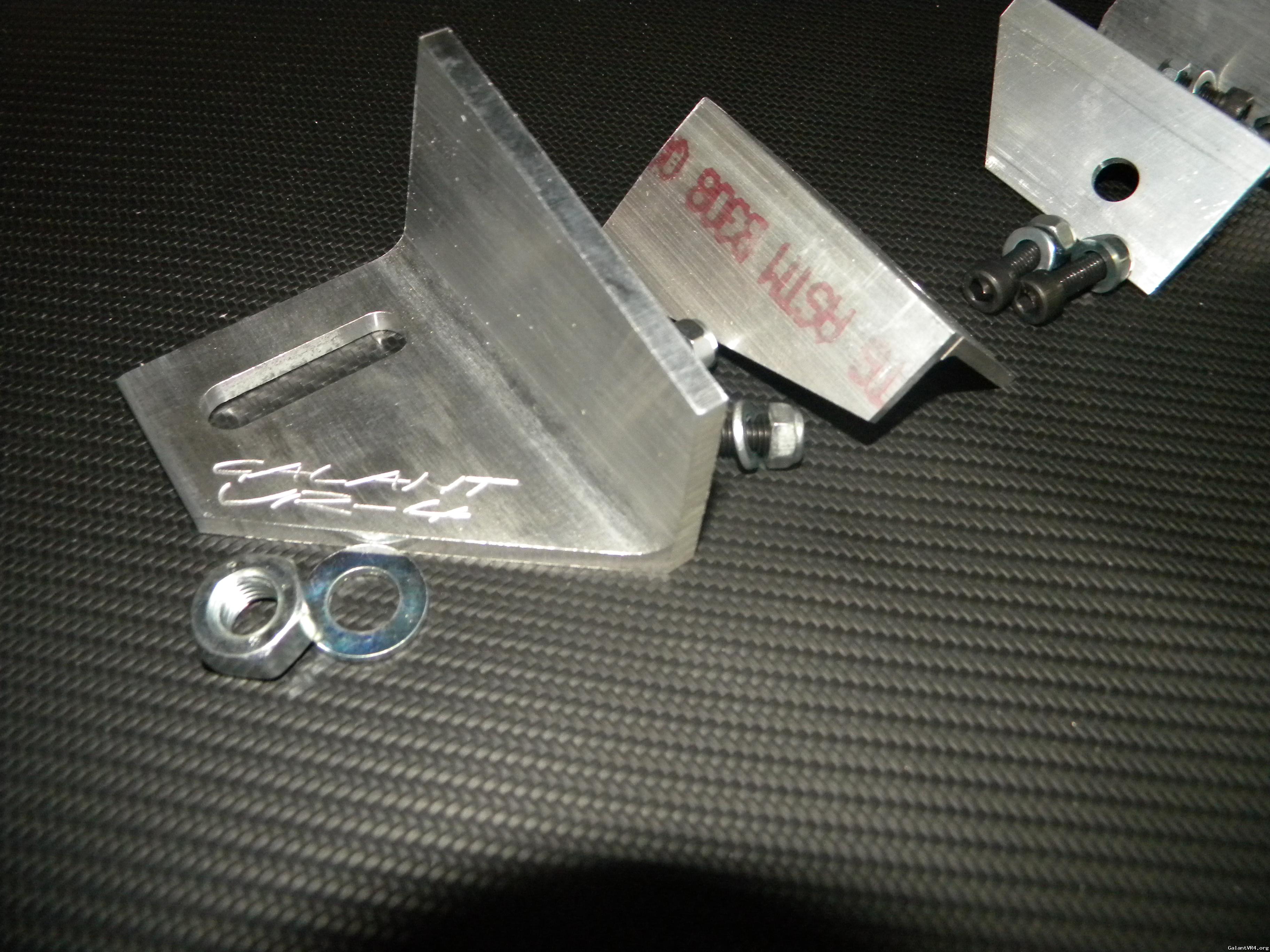

I did the other pictures to show where the hardware goes and you can read through the post above to see how the seat bracket attached to the floor brackets up front. Just remember check the seat rails to make sue there perfect square and centered before starting and follow my instructions about hand tight and in which order and you'll have no problems.
The steel washers go to the front brackets with the nuts
The plastic washers go to the back with the bolts
The 6mm x 40mm bolts go through the back rails
The 6mm x 20mm bolts go through the front of the factory rails to the smaller brackets included with this kit and then
The 6mm x 15mm bolts attach the smaller brackets to the larger bracket they're 8 of them.

Paul, mine are scheduled to be here monday, along with my DBAs. I should be able to make it by your place tuesday after work if that works for you. If you are on the fence, you may as well jump on it unless you have the ability to make your own. I plan on sprayin mine satin black, Id love to come up with a way to keep the "Galant VR-4" bare though.

Fill it with wax that can be removed after painting /ubbthreads/images/graemlins/dunno.gif
4thStroke
Oct 22, 2007
1,864
Vancouver, WA
Good point, but it seems like it may be tough to get such a fine line of wax in that shallow and thin of the etching.
