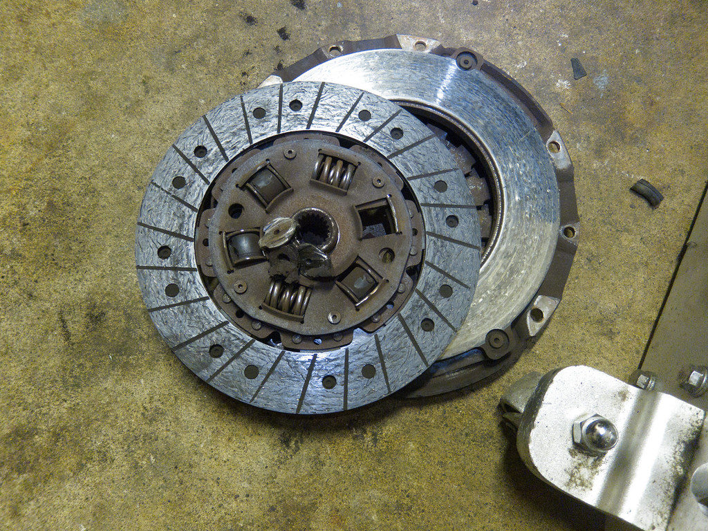

My clutch broke on the way home from work today. Lame, I just did a clutch on the 2.5RS this weekend. ARG

Hopefully it's just a broken disc, on the way home the trans stopped shifting.
Clutch won't fully disengage and it bangs sometimes when the clutch is down. I thought someone rearended me it hit so hard. Though I can feel it "grab" where it should but I can feel the car lurch forward sometimes when the clutch is down. And then there is that banging thing...
The pedal feels totally fine, slips totally fine and holds fine. Trans is really stiff and it tries to move the car in violent ways, once in a while

I went with clutchnet because of the spring-cage design. My act looked alot like your pic and I didn't want to have it happen again. I got the Red 2x pp with sprung 6-puck. While the 6-puck isn't as bad as I'd expected, I do wish that I'd gotten a full-face disk because I have to concentrate on my driving to keep it from chattering. The 2x is SUPPOSEDLY 60% stiffer than stock which puts it at ~2600 lbs. I'm not sure I believe it because the pedal is lighter than my old act 2100. They do offer an organic disk but I'm not sure how it will hold up compared to the friction compound you get with ACTs.

It's got those rubber things in place or springs, what was destroyed on my clutch. All 4 of them were destroyed, just one popped out.

Yeah, but the rubber ones. They were completely chewed up in my disk, looks exactly like the center of that exedy

I wont run a sprung hub anymore because of what is pictured above. I think i'm just really hard on clutch discs. I slip them ABSOLUTELY as little as POSSIBLE. It seems sprung hubs do not appreciate this behaviour.

I just had my Ebay clutch pop a spring. The spring got stuck between the flywheel and the disc and the car wouldn't release out of gear. It basically locked the transmission in "Go".
