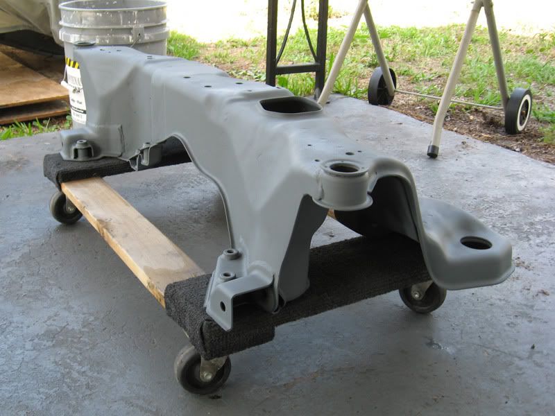

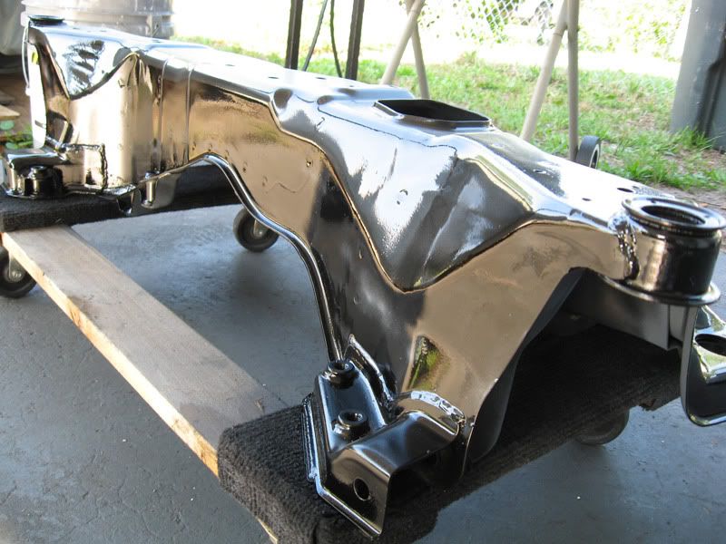

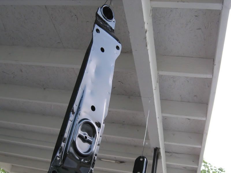

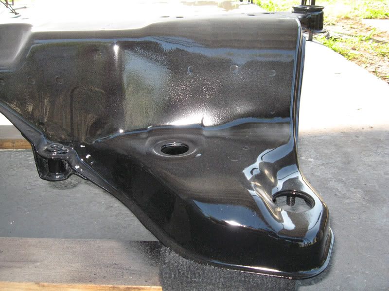

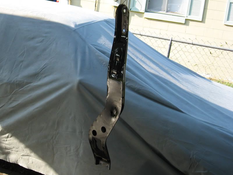

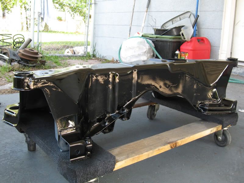

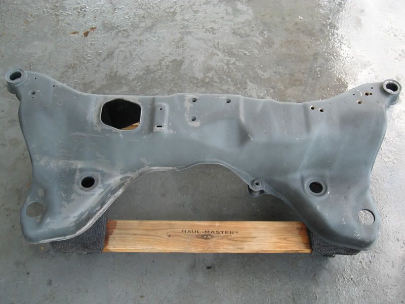

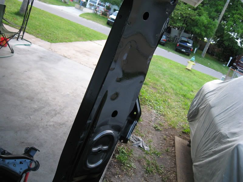

Thank God it's Saturday! Finally had a chance to get some good work in. I decided to go ahead and finish re-coating the rest of the sub-frame pieces.
Couple little runs, no biggie. I'll go back through and color-sand once it cures, buff it out a bit. Should look great in the finished bay. /ubbthreads/images/graemlins/smile.gif

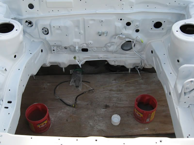

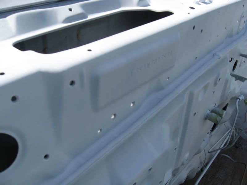

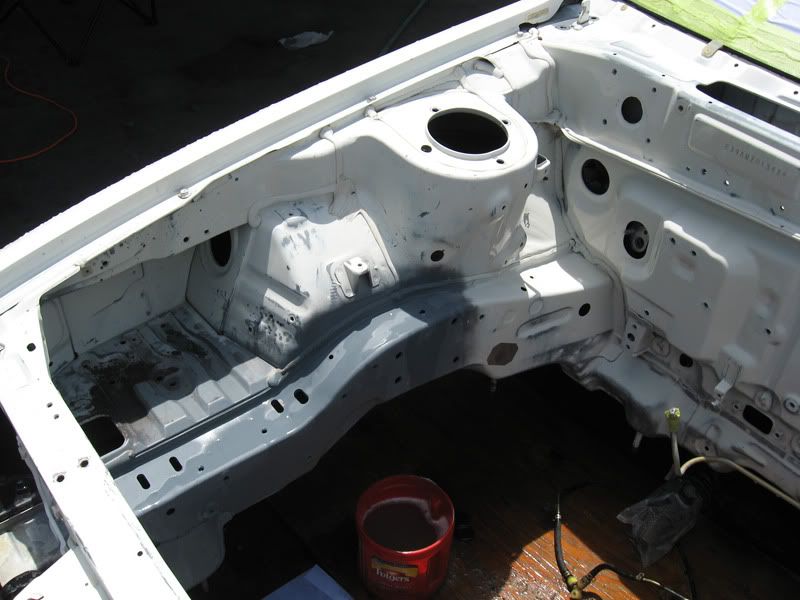

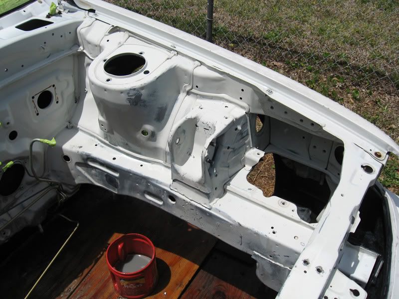

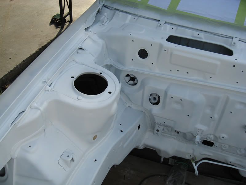

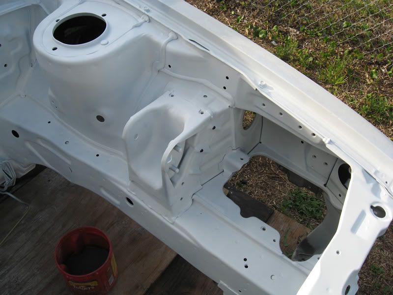

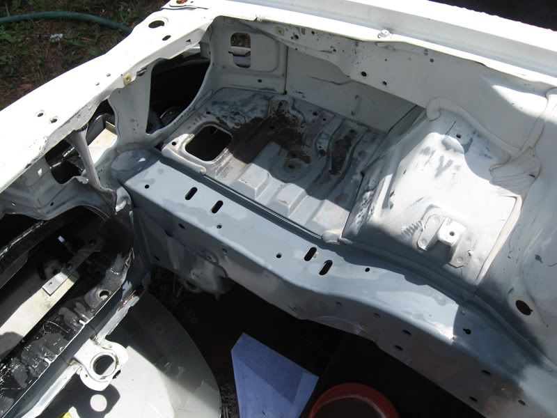

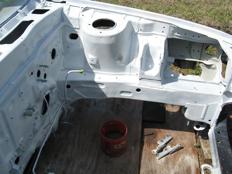

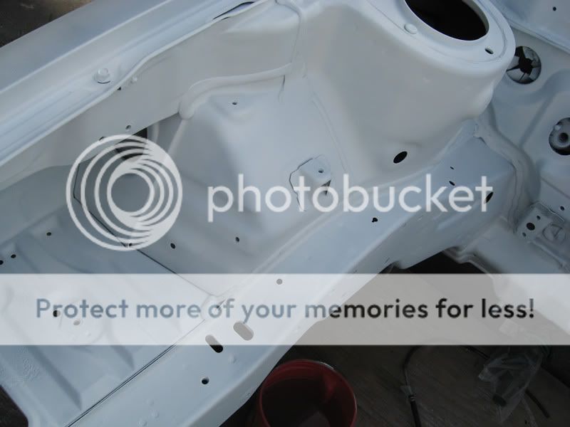

Ahh, finally some progress to share after a long 7-days with nothing done which seemed like an eternity.
Engine bay is primed and almost ready for a base coat. I'm glad to see it all white without all the scratches, dirt and grease.

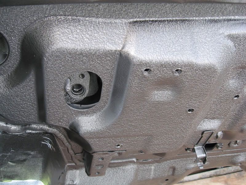

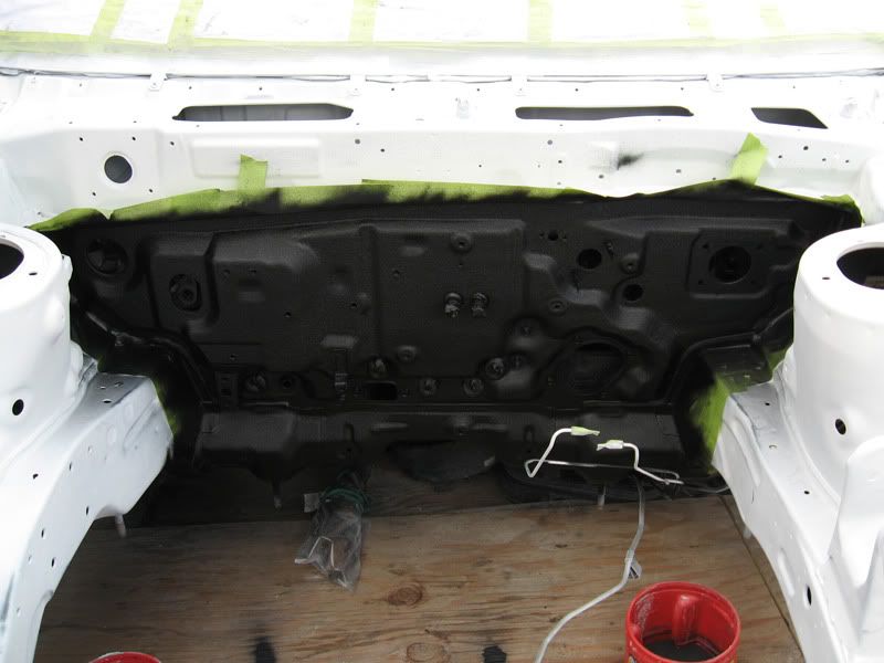

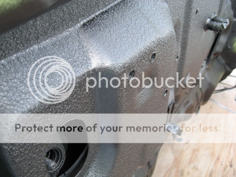

I've been toying around with ideas on what to do with the firewall, if anything besides matching White, particularly the area where the sound deadening used to be from the factory. For a couple reasons, I decided not to go with White in this area to match the bay, the main reason is that I plan to tuck the wiring slightly lower down, but it will still be visible slightly from above.
So, this is what I came up with:
It's VHT Wrinkle Black.
I'm pretty pleased, and feel it will contrast nicely with the rest of the color plans for the bay. Of course the rest of the bay will be Summit White matched.
The plans so far are to stick with White, Black and Silver for the bay to keep with a nice clean look/feel. I'm also playing around with the idea of throwing a splash of Gold in there somewhere. The valve cover will be PC'ed a Metallic Silver, similar to the factory valve cover, but shaved.
