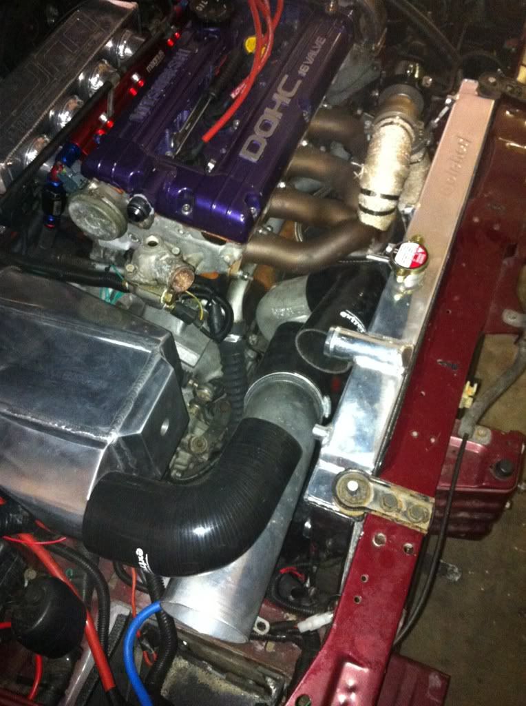

This was the old setup in my brothers evo. I think something like that may work, and give my plenty of space for the wastegate. If go with a turbonetic's manifold I hope it will clear my exhaust housing without hitting the block.
