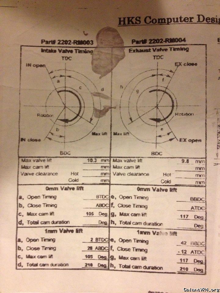

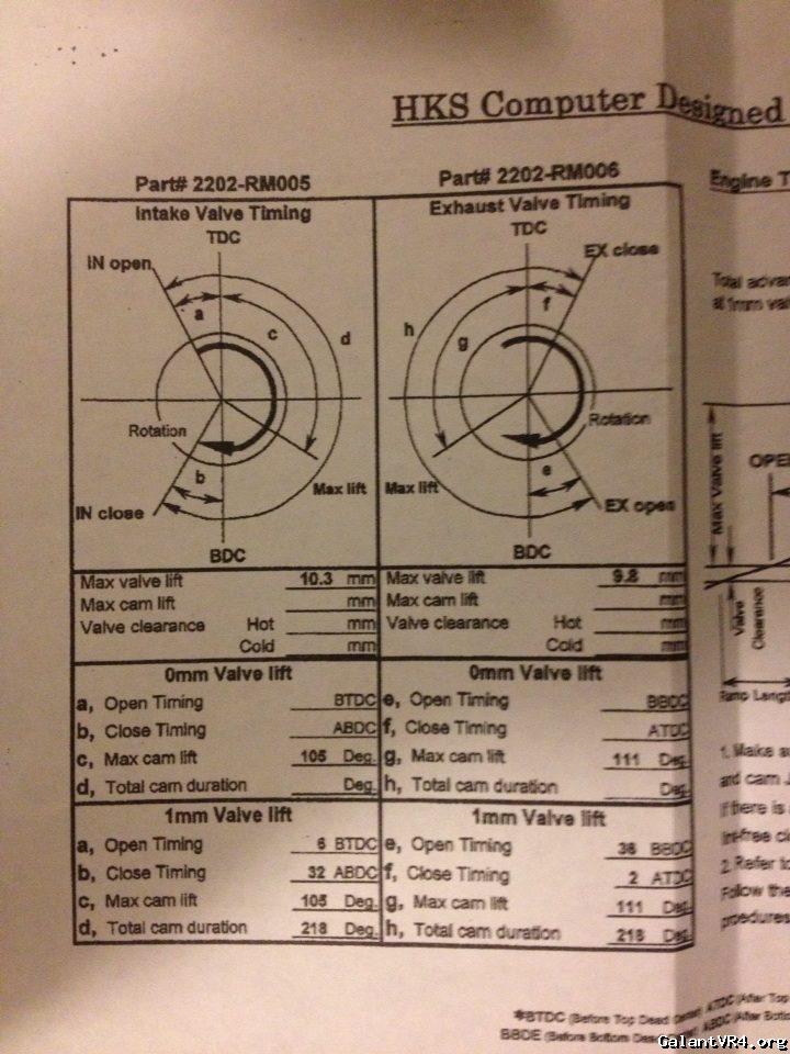

BTW, found these while I was derpin around looking for info on the web. Thought they might be useful:
264's
272's
