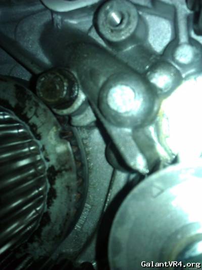

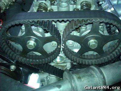

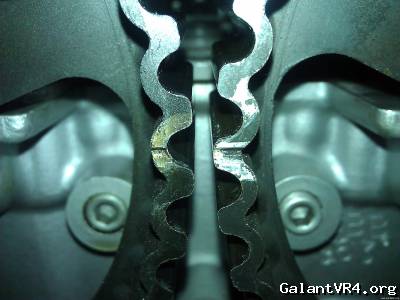

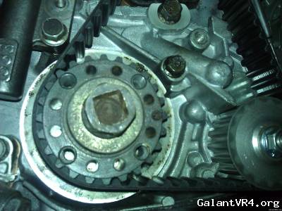

I pull the lower timing cover off expecting to find the timing jacked up. I rotate the motor over by hand again until all the timing marks line up. The timing is DEAD on. Everything is perfect. Now, I'm really thinking WTF is going on? The timing was fine the entire time.

-Not the timing: The mechanical timing is dead on. You can see in the pictures above.
