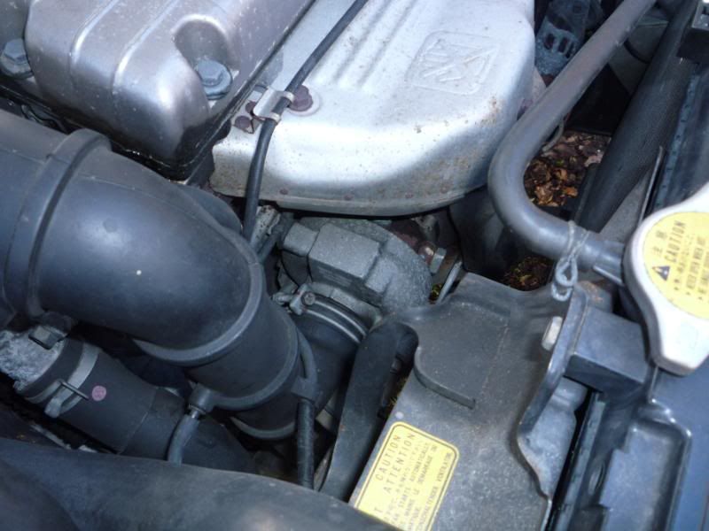

The Hyper Sports Gear M/T is meant to have a TD05 which is kind of a hybrid between the outgoing TD05H-16G Evo III turbo and the TD05HRA-16G turbo of the Evo IV onwards in such that the Evo III single scroll exhaust housing is retained but it has a similar compressor wheel and cover to the Evo IV turbo, except obviously not reverse scroll. I have seen a few pictures of these turbos but have not seen one in person, supposedly these are better than the Evo III big 16G turbo.

fuel
Feb 23, 2009
2,167
Toronto, ON, Canada
here's a pic of the RVR Hyper Sports Gear turbo, you can see it's not quite like the Evo III Big 16G
