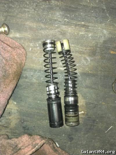

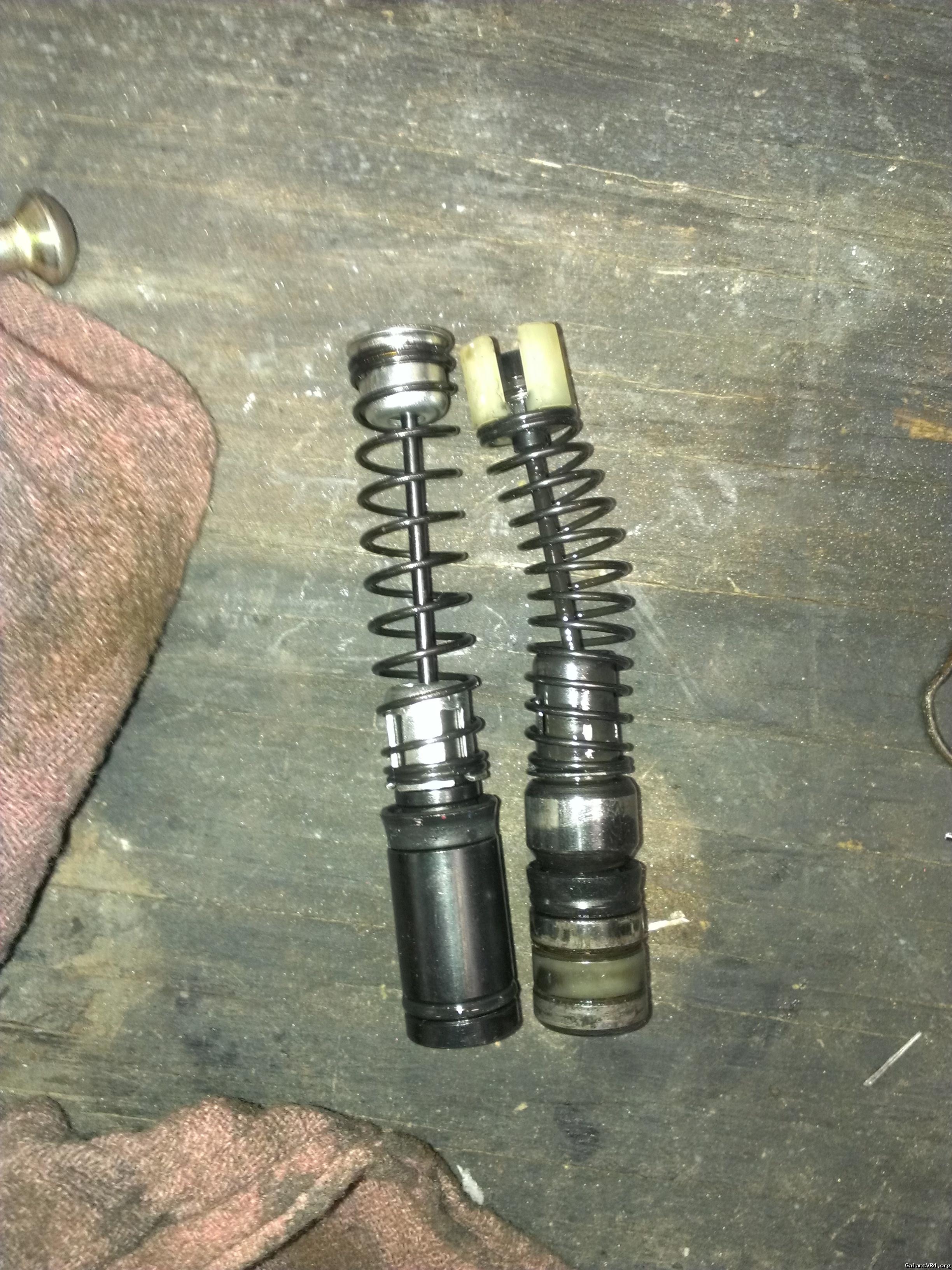

Bleading for over an hour and finally satisfied there's no air. No change whatever. I threaded the pedal adjuster 3 turns up and its higher but I don't think its going to self adjust any more.
Side note : there is defiantly somthingdifferent about these two slave cylinder internals.
Nabco on the right. Can't find a part nuber for a dealer rebuild kit or nabco kit for that matter.
