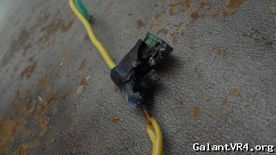

still got me home tonight!

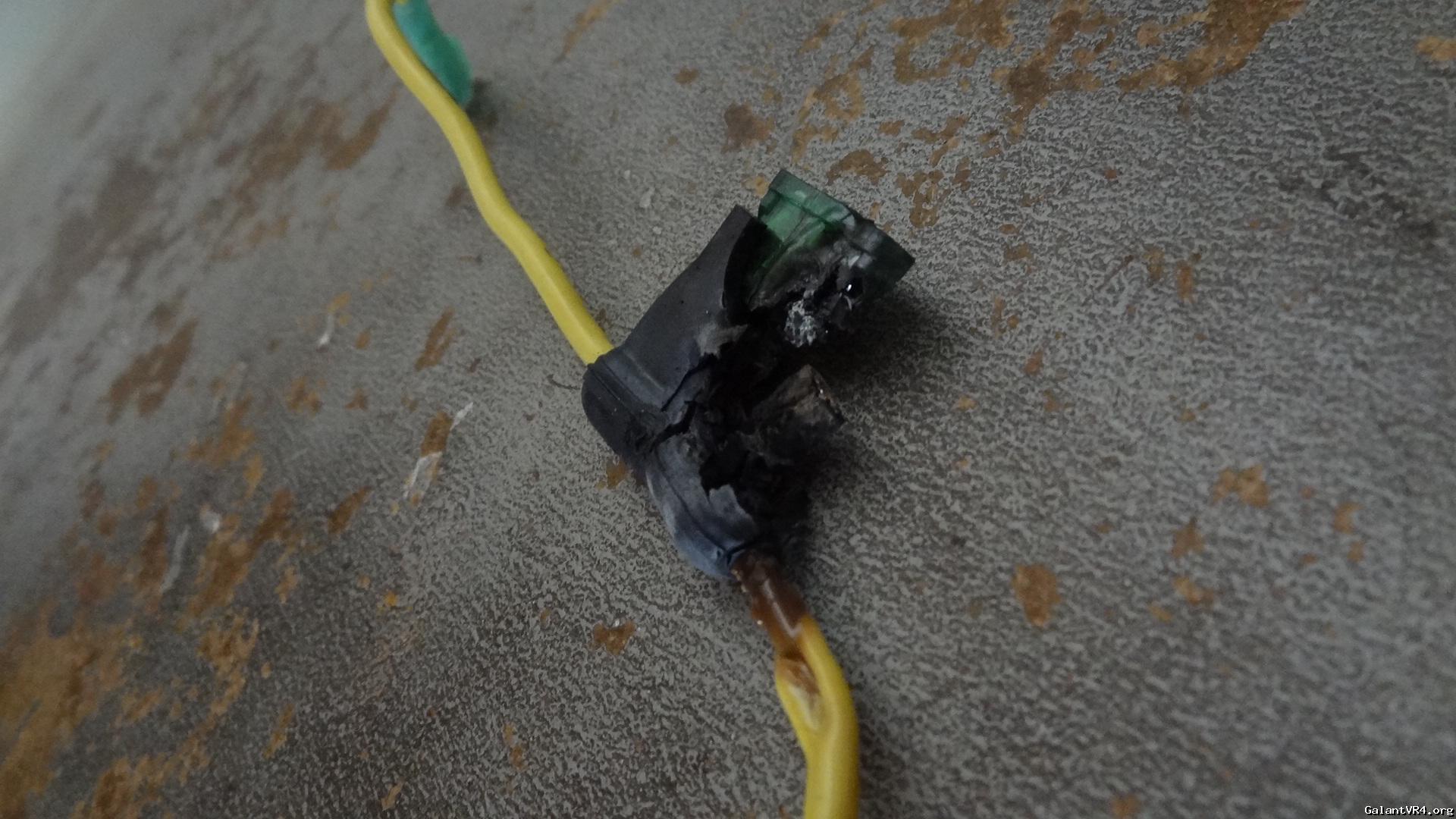

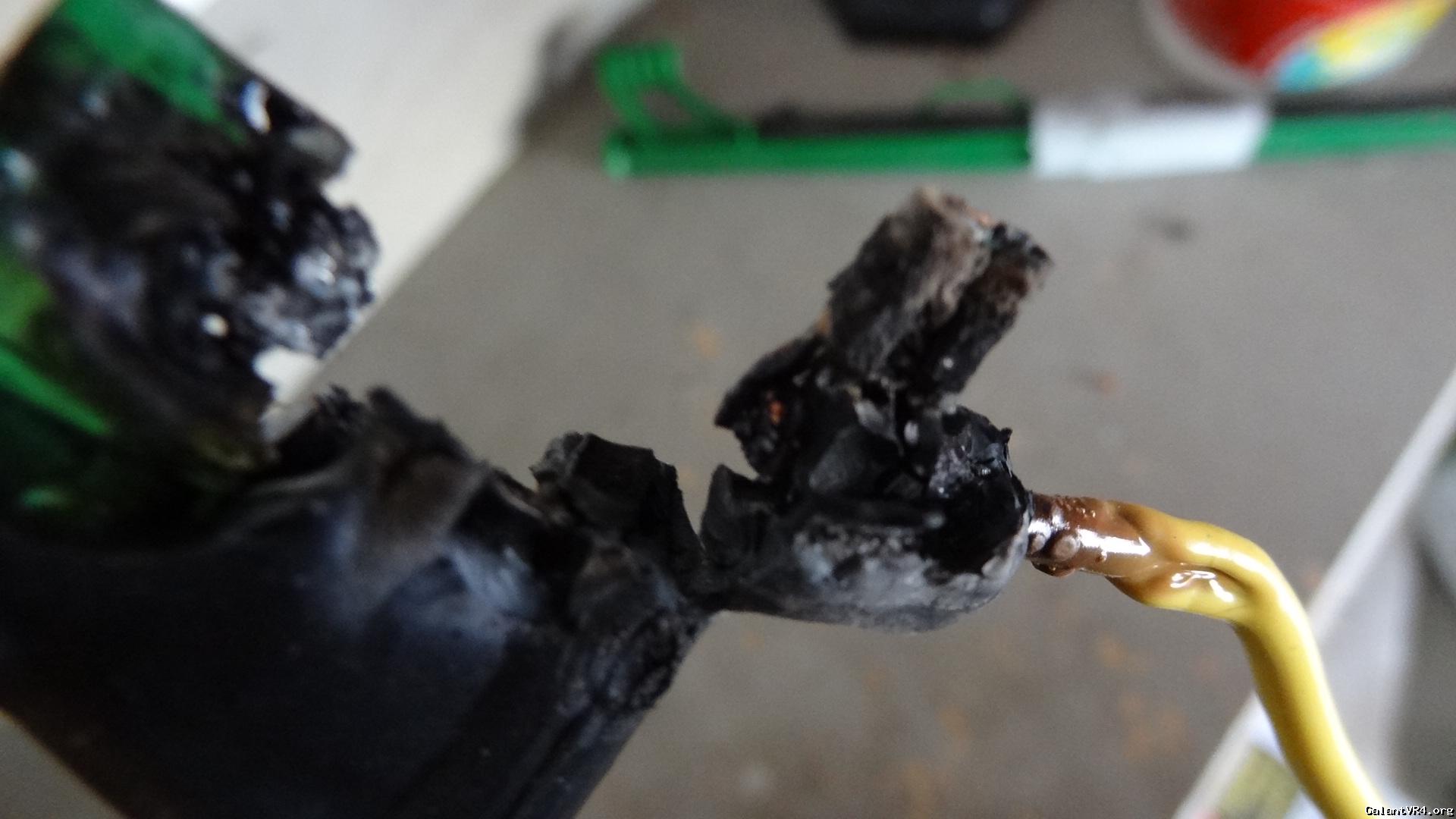

This was the fuse I put on the fuel pump rewire, don't know what caused it, but I got home. Weird part is that when I turn the key to off, the car still runs, that's what got me to trouble shoot and found this.
prove_it
Jul 3, 2008
4,201
Sioux Falls, SD
/ubbthreads/images/graemlins/uhh.gif
Bet the wire was too small and got it hot. Either that or the pump pulled too much current and the fuse didn't pop. I have seen that happen.
Homemade rewire, or kit?

Chinese inline fuse. Or you swapped a fuse in that is too high for that gauge of wire.

Well, it's a home made kit, and I ran a super heavy duty relay with 12 gauge wire all the way until the fuel pump cover with 30amp, I didn't want to drill out the cover to run it all the way. I'll double check the ground, are you talking about the ground at the relay or the fuel pump assembly? It is a cheap china fuse, I've put in another inline fuse with 20amp that is a better one, so I am gonna drive on that and keep an eye on it. what would cause the pump to draw more amp? dirty fuel filter? low fuel?

I would never run a 30A. That's why it burned up. I would rewire the whole thing with a high quality relay. Make sure the grounds are clean and you scrape down to bare metal at the ground. Also you should pull the pump out and run new power and ground wires straight to the pump.
