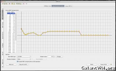

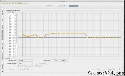

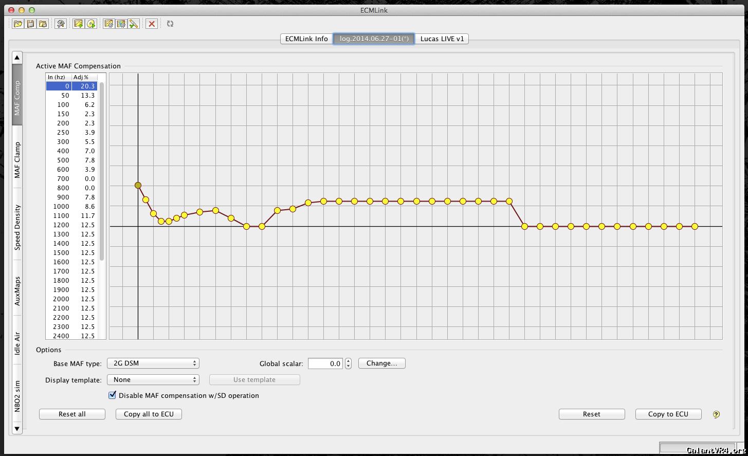

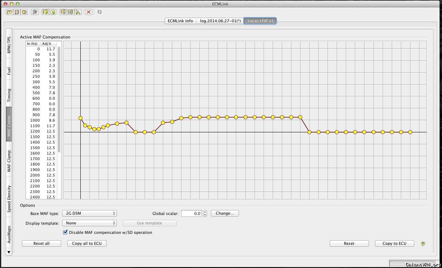

So interestingly enough, I was checking my IdleAirPerRev on old WOT logs (at idle, of course). I decided to check after a typical drive and I found my ISC position was a touch high and my AFPR was a bit low.
ISC = 40-
AFPR = 0.21 gm/rev
I adjusted my BISS to get the ISC value up where it belonged, and I adjusted my MAFComp to get my AFPR up a bit.
Since doing that, I have had NO issues.
Before
After
At this point, I'm not willing to say it's solved, so I'll update this thread in a week or two. Anecdotal evidence so far is very positive, with no change to drivability and no stalls. The change the MAFComp is a bit extreme looking, but the behavior is much more like what you would expect a car to drive like.

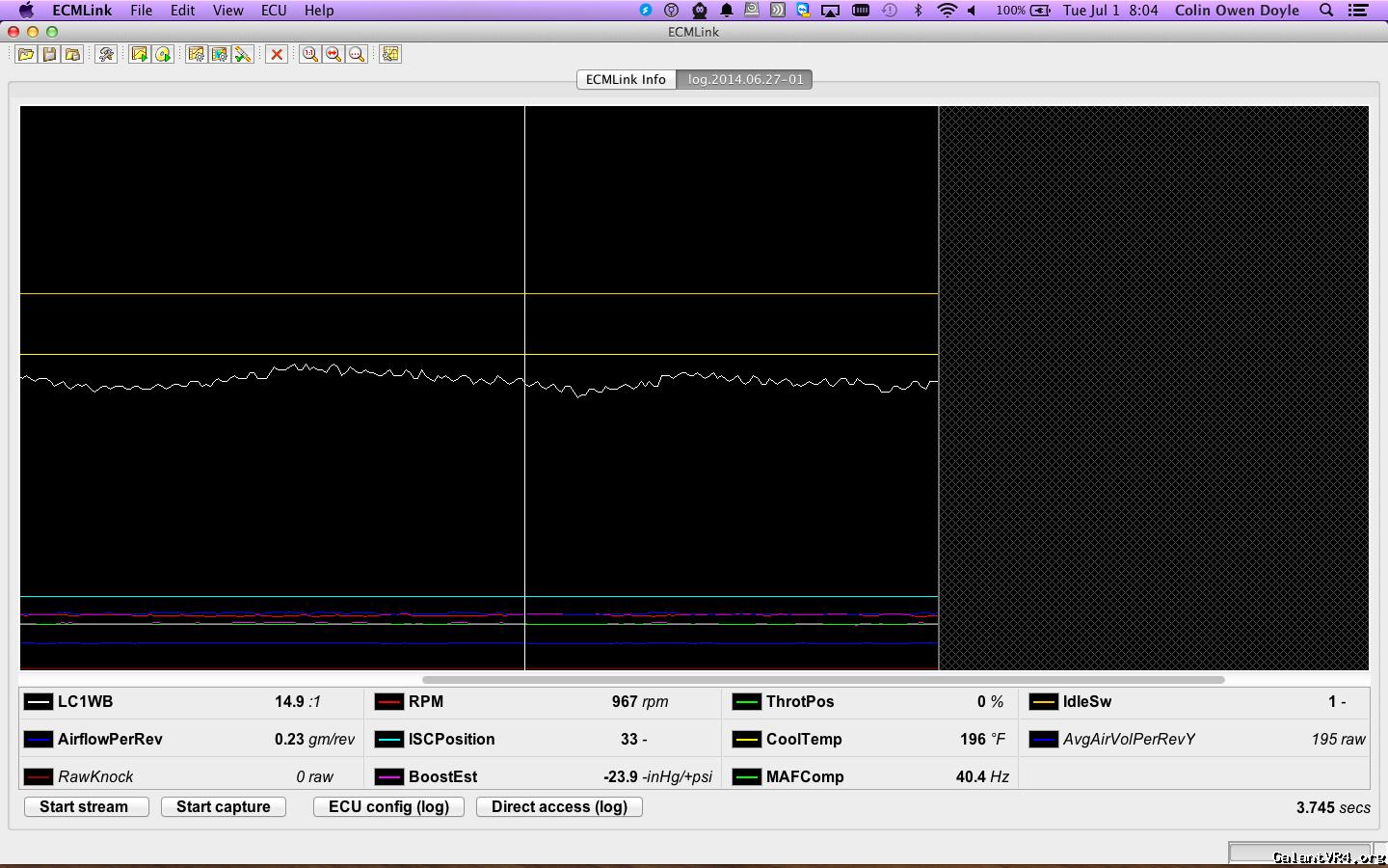

portland, or
AirFlowPerRev
It's a value you can log with link. it should be right around 0.25gm/rev
I'm still playing with mine. Just brining it up from 0.21gm/rev to 0.23gm/rev made a vast improvement. I'm going to turn my idle down a bit today (it's at 950) and continue some adjustments so I'm pulling more vacuum while stopped.
