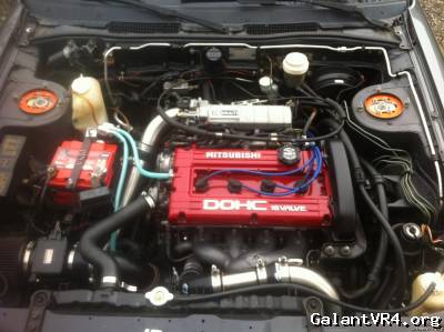

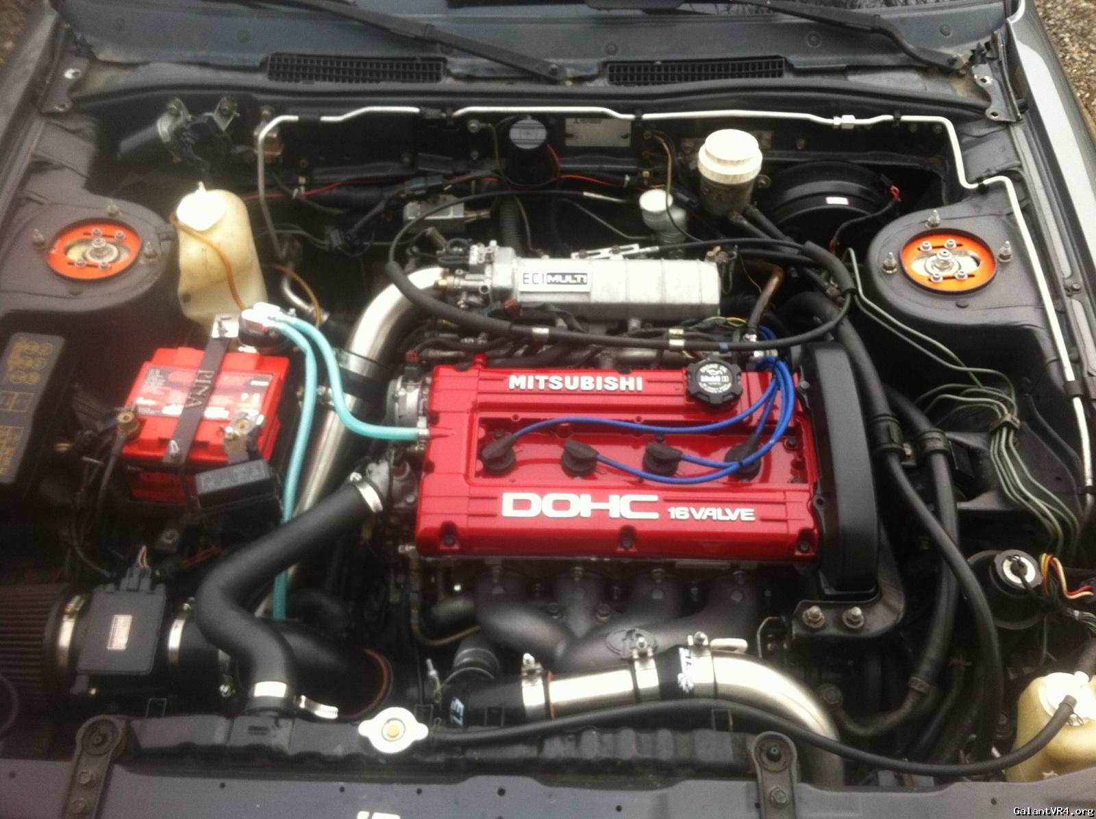

MAF is stock, I think. ECMLink is configured with a Base MAF Type of "2G MAF".
Here's a picture if it helps?
coyotes
Nov 15, 2013
1,544
Seattle, WA
That is definitely not a stock MAF. Engine bay looks real nice dude. /ubbthreads/images/graemlins/applause.gif
prove_it
Jul 3, 2008
4,201
Sioux Falls, SD
He has another thread discussing his issues with his recirc, and the resolution for it. It's set-up right.
Not a stock GVR4 MAF, but a 2G. Pull it off and check for the honey combs, no combs makes for much needed MAF comp.

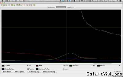

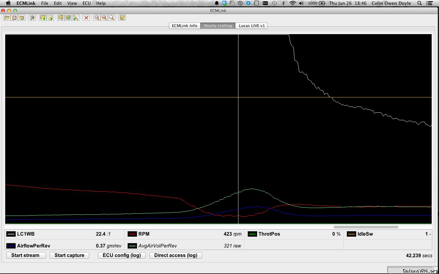

EfiniX
Oct 18, 2012
647
portland, or
Idle at 950 w/ FC offset @60. AirflowPerRev @ idle is stable around .25, so that's looking ok.
I've got my fingers crossed that the clamp works out.
