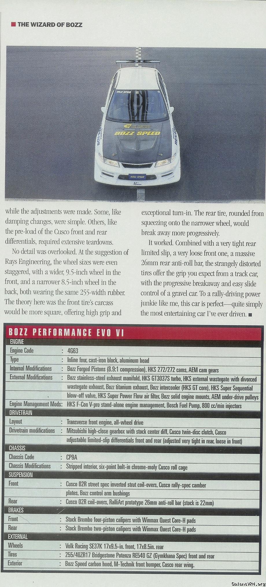

Ah-ha, I found the old Bozz Speed Evo article. (sorry dial up dictates that I must crop the original down from 3 megs)
It runs the factory center diff, but also has adjustable LSDs at either end of the car. The width of the wheel only seems to make the sidewall more or less vertical.
