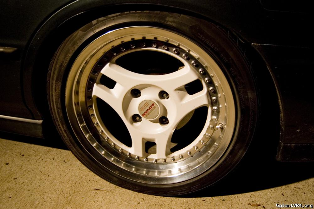

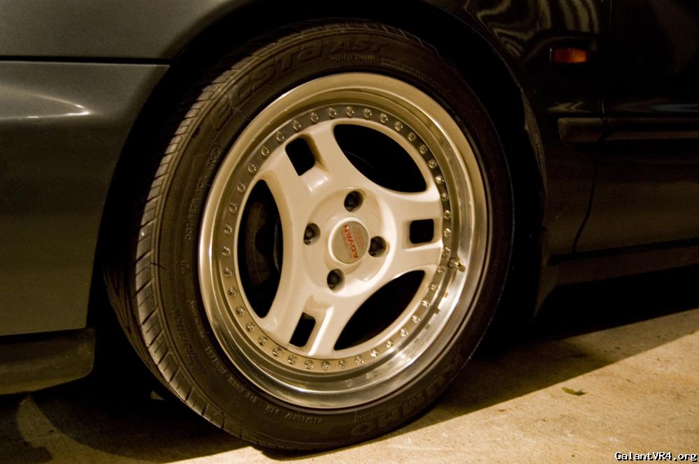

Ok thanks for all the info guys I think I'm going to try it out this weekend. The te37s I have are 16 x8 and I want to see how the car looks with 17's. With Galants naturally seeming to have more space to fill in the rear I am hoping this will remedy the problem. And if it doesn't then I guess the old wheels will go back on. Here are the other wheels which I know are a love it or hate it choice anyway:
Front
Rear
Stretch isn't that noticeable
